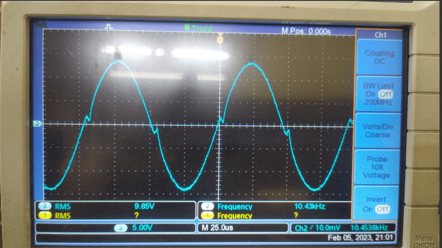

Having this distortion in the 1943 5200 80W amplifiers will it harm my transistor? I am getting a better response with this distortion I do not know why. This distortion starts at about 1khz and goes up to 20khz. I know how to get rid of this distortion but it changes the response of the system which doesn't match my speakers.

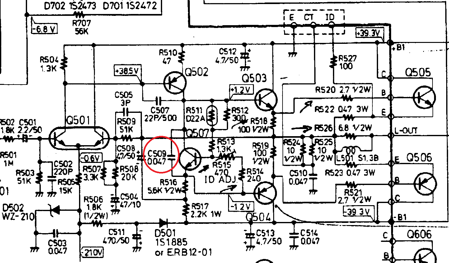

It seems a kind of zero crossing distortion, frequency dependent. So, it may be that any bias (mainly in the output pair) is being shifted with frequency. I think in a small capacitance (0.1uF) across the Vbe multiplier or rectification in any stage in DC coupled circuits or a capacitor or resistor degraded by ageing or thermal stress.
The amount of crossover distortion is frequency dependent because the amount of feedback available to reduce it is falling with frequency. 100% normal in the usual amplifier topologies. You can push where this up-tick occurs above 20KHz with careful design, but you’ll never get rid of the rise. The bias is just set too low. Whether is a faulty preset pot, a resistor that shifted, or other is still TBD, so leave no stone unturned.
