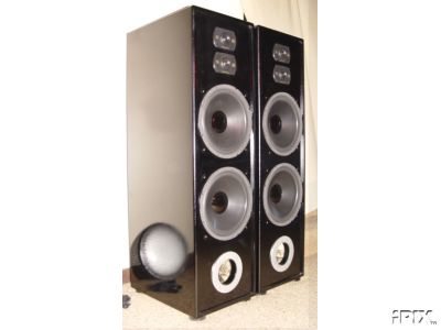

What do we think of these speakers? 😉
* Each Box comprises of 2x 12 inch Woofers & 2x Titanium Tweeters.
* They have undergone many hours of maticulous Computer designing, using Bass Box Pro (latest Version)
* The Cabinets have been crafted and built by hand, using only the very best materials available, ie:- 18mm MDF through out the entire box construction, (most top end speakers manufacturers only put MDF in the front baffle panel, the rest is chipboard)
* The Boxes have been Tuned to the 'Exact Resonant Frequency' of the Dual 12 inch Woofers (35 Hz) in a Parrallel configuration, resulting an extremely powerfull but beautifully natural sounding Bass response.
* The Boxes are VERY heavily double and triple braced (internaly) for extreme rigidity.
* Internal screw and glue method of build has been employed, using the strongest glues available. (these boxes could roll down a mountain and be unharmed) (humour)
* They are finished in Cabots Woodcraft Black Stain, for a super deep black lustre and an almost unique look and feel.
* Heavy accoustic internal wodding has been used in the boxes.
* The Drivers used are TOP Quality (and very under rated) Asian equivilents and modeled of famous brands like "Responce and Peerless"
* They have all been wired up using Quality 12db per octave 2 way X-Overs, and Super high quality American Pure Oxygen Free Monster Cable, used through out and are terminated to Gold Banana connectors. (for Pro hook-up to your Amp)
* Metal (Silver) Grills are used to protect the Woofers and enhance a unique "Look"
http://cgi.ebay.com.au/ws/eBayISAPI.dll?ViewItem&item=3037898944
hmm... I emailed the guy with a few argument starting points... 😉 oops.. lol
