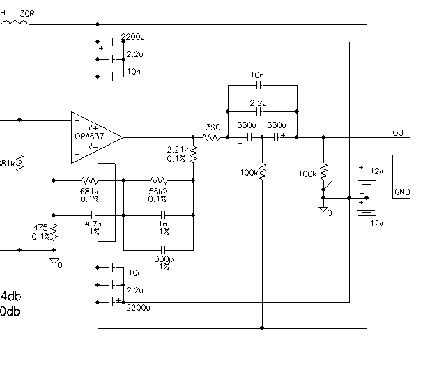

This one has got the best of me. I'm assembling an 'El Cheapo' phono pre, and I'm testing the first channel and getting some unusual results.
When I ground out the input, I get a fixed 0.140V output on pin 6 of the OPA637. However, after the output capacitors, I get a very weird DC offset and low frequency oscillation.
When I turn on the power, the output will spike to 3-5V, then drop to -3 or -2V, then start to climb again. This will change over the course of minutes, it's very slow, but I have no clue what's causing it since the output of the OPA is solid 😕
Ideas?
I should note that I've eliminated the MC input, it's only MM and all my polystyrene caps came from parts connexion. What's weirding me out is that I thought all polystyrene caps were non-polar, but mine do have markings. You can see examples of them at:

Looks like a typical transient response as a result of the power supply's 'step input'. Does it damp out completely or is the LF oscillation still there after these few minutes?
I think (but I could well be wrong) that you can eliminate this with a proper LPF after the output. Resistor + capacitor that would be; is this called a zobel or am I mixing up things?

it is decreasing in amplitude. It's settled at -24mV offset after about 5-10 minutes.
Most preamps have DC blocking on the inputs right? Is this something I can ignore?
I'm not too worried about -0.24mV, but when it's swinging around +/- 5V at startup I'm not sure if that's an issue...

It could do harm to your speakers ofcourse, having 5VDC before your main amp and most probable a lot more volts at the speaker outputs!
I just found out a zobel is supposed to do something entirely different, but some load might damp the oscillation out a lot faster, though. What is the load after the op amp? Have you connected a resistor to ground? What value is it? You might want to decrease it...
If you put a load 'after the output capacitors', say 10 kOhm resistor
from output to 0V,
Does it get any better?
There should be a 100 kOhm already from output to 0V.
See attachment.
This is the only I can think of, if you get strange values AFTER output caps.
In fact you should get strange values, if no load from output to 0V

Aha, he is measuring on a floating capacitor? Then it makes sense indeed.
The capacitor in series with the scope (or whatsoever) impedance might give the slow oscillation (ringing?), then. Say, 1M + 1uF in series is about 0.2Hz or something...

The 100k is in there from the cap to GND, just as shown.
When an additional 10k is put in parrallell with it, the initial values did improve, it now starts off at about -0.5V and slowly moves toward 0V, but it's not getting there any quicker.....

robselina said:The 100k is in there from the cap to GND, just as shown.
I can only say, you should check your wiring.
Probably you have put some component wrong.
It is easy for example to confuse -V supply with 0V (GND)
and also to put an electrolytic cap +pin to negative.
There are two large caps 330uF in output.
You should check that you have done this part of circuit correctly.
I think when you find this bad thing, all will be alright.
Because probably rest of circuit is correct.
I should mention I swapped the chip from a 637 to a 627 before these last few tests. I have five of the later and only two of the 37s so I'm trying to keep them 'safe'. With the 627, the output on pin six is 0.403V to 0.397V, which is also curious since both -In and +In are at 0.000V.....
The DC offset at output, I think is normal in this circuit.
This is why you need these output caps!
Even a very small offset at input, or input bias current
can result in such an offset at output, pin6.
The DC-gain is 1 + (681k + 56k2 + 2k21 )/475 = 1557 ........
I am beginning to think it is quite normal
this circuit is taking several minutes to make output at 0.00 V.
Because 100k resistor from between 330uF is connected to -12V.
The time before these BOTH caps has been loaded
is very long, using 100 kOhm.
When they have been loaded, the junction in between caps ( -pins )
is at -12V, while positive (+pins) are at 0V.
So both caps has to get 12 volt across them.
And the little current in 100k Ohm has to do it.
If the output has got near to 0.0X V after 5-15 minutes, it is okay.
The time constant of 330uF+330uF x 100k Ohm is
0.000660 x100.000 = 66 seconds
And to get caps near to full load (12V) will take even longer than this.
Now dont go make that 100 kOhm smaller, because this will increase the load of output.
It is meant to be this way.
And this time it takes to get 0 V at output is probably also normal.

Sure enough after a few minutes it's hitting 0.0V dead on.
Also now that the caps have been charged, when I flick the power off for 30 minutes and then back on, I'm starting so much closer to the gnd reference it seems to be correcting within a few minutes.
I'll take it down to the lab and hook it up to the frequency generator and oscilloscope and see what it does tomorrow 😉

robselina said:Thanks,
I've looked it over more times than I can count and I'm not seeing it so I should probably get a second set of eyes looking at this....
As I said in my last post, the reading of output is probably normal.
And your setup is alright.
It is an extreme output (by an extreme designer) as it uses so much capacitance at output.
That is why is takes so long to load those 2 big caps.
To make a more 'normal output',
you can remove both those 330uF caps and the 100 kOhm going to -12V.
Instead you can increase the 2.2u film cap (MKT or Polypropylene).
To one 4.7uF or 10uF (MKT or Polypropylene)
Or two 2.2uF or 4.7uF in parallel. Will give 4.4 or 9.4 uF.
This will be pretty okay if your phono amp is to be connected to some
47k or even 22k input (preamplifier or power amplifier).
robselina said:Sure enough after a few minutes it's hitting 0.0V dead on.
Yes, if you switch off and on again within a short time,
those caps are still loaded.
It will take a long time before they are dis-charged, as well.
