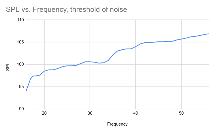

I built a dual 15" Ripole subwoofer using Dayton RSS390HF-4's. Everything works great as expected until transient bass notes hit, then it sounds similar to the suspension/coil bottoming out. The issue is that I hear this when there's only 3-4mm of excursion. My ignorance on the physics of this exact topic leaves me just with some bad feelings, as if the suspension is just not okay in this application, but I'm having a hard time identifying which parameters I should be looking at. I've measured the THD to see if there's anything obvious going on, like resonances from the slots, or significant dominance of even vs odd harmonics....etc. Nothing pops out. The THD plots are clean at 95dB 1m, generally less than 1% in the sub range.

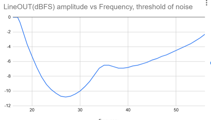

At 16 and 17Hz, my amplifier just wasn't powerful enough to drive the loudspeaker any further. at these two frequencies I didn't hear any noise/distortion, but at 18Hz ,I could detect it finally, so I presume I was fairly close to the detectability threshold, only shy of amplifier power by a few dB. Anyways, you can clearly see centered at 27Hz, there's a noticeable phenomenon, where the ripole/sub is driven to noise somehow with lower power. The excursion decreased as you would expect proportional to the ratio of frequency (f2/f1)^2.
I also noted the SPL at 1m for the audibility threshold of the noise for each of these frequency points. Remember to keep in mind, this is not related at all the frequency response. This is simply the amount of output SPL the Ripole can generate at each frequency (1Hz per test), before some noise/distortion/rocking mode is audible. And, the above graph is the necessary LineOUT level used to drive the system to these levels.
I'm beginning to suspect there's a standing wave / turbulence issue here, where at some frequencies (notably near 27 hz) air is finding a difficult time entering and exiting from the ripole cavities. (I'm imagining a trumpet without a horn flare, and only some discrete notes can efficiently exit the tube due to the impedance mismatch between the "tube" and the infinite impedance of the room).
All thoughts on this are welcome. I'm really scratching my head. How can I determine if this is a box design issue (geometry / volume / slot area...etc) vs a driver issue (ideally without having to construct yet another enclosure).???

I shared a little bit above, that I tested in 1Hz increments to find how loud I could operate the ripole until I started to faintly hear the distortion/noise/rocking emerge. At 16-18Hz, I couldn't generate the noise with my setup. It was moving about 12mm pk, and not a hint of the noise present. But at 27Hz, for example, the cones were able to create that noise with considerably less stroke. Any ideas?
