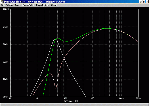

Jan's explanation above is so good that it deserves illustration. Using Subwoofer Simulator to display other curves, we have:
System SPL for one watt in light green,
Output from driver in light, (very light) red
Output from port in white.
I think this illustrates Jan's point.

Great graph! I noted that the driver output has a dip at the port resonance, which I have never seen. Hmm. Must think about that one.

kelticwizard said:Prash:
It has been a while, but I just thought I would drop in with something.
Your box, 25 liters with two 2" diameter ports 3" long, is tuned to 65 Hz, according to WinISD.
I modelled one P13WH to a box half the size-12.5 liters. so the reading will be the same. The box is tuned to 65 Hz, just as your box, with 2 woofers, is.
I used Subwoofer Simulator by our own F4ier, which models any of 7 different box types with your choice of 18 curves. It is free and downloadable.
http://www.geocities.com/f4ier/speaker.htm
I chose to display the frequency response, impedance and cone excursion for one watt of your P13. I used your measured results of 83 Fs and 7.11 liters Vas.
The high frequency response of the real-world Vifa will be better than the graph. The graph only represents a perfect cone, which no speaker has. The impedance and cone excrusion should be awfully similar to reality, though.
As you can see, the impedance peaks are quite well defined with a valley in between. The bottom of the valley is at the tuning frequency-in this case, 65 Hz. This is what your impedance curve should look like.
If it does not, I don't know what to say.
How did your speaker work out, anyway?
That's interesting. I'm not getting the distinct valley in the imp graph. Actually, I havent had time to work on the speaker after the last time we discussed this as I was away for about a month.
If you recall, I am down to 2.5" for the port lengths and as I mentioned there is a very small dip at 59 Hz (if you really look hard at the graph) but no smooth and distinct dip at this tuning freq.
Anyway to recap, I have a box about 1547 cu in. (about 25.3 lt) with two 2" ports with no air leaks otherwise. I have measured this with the 2 Vifa drivers and the SS tweeter mounted. (Could the tweeter be causing some problems the fact that it is there right next to the driver? Then again it's should be ok because we are trying to tune the ports of the speaker as a whole right?)
The impedance jig I'm using with SW is fine and so is the sound card i think. the impedance measurements (free air impedance and with mass added imp) of the drivers themselves look fine. only what i am not getting is the valley. 😕 🙁
