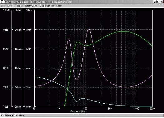

Prash:
It has been a while, but I just thought I would drop in with something.
Your box, 25 liters with two 2" diameter ports 3" long, is tuned to 65 Hz, according to WinISD.
I modelled one P13WH to a box half the size-12.5 liters. so the reading will be the same. The box is tuned to 65 Hz, just as your box, with 2 woofers, is.
I used Subwoofer Simulator by our own F4ier, which models any of 7 different box types with your choice of 18 curves. It is free and downloadable.
http://www.geocities.com/f4ier/speaker.htm
I chose to display the frequency response, impedance and cone excursion for one watt of your P13. I used your measured results of 83 Fs and 7.11 liters Vas.
The high frequency response of the real-world Vifa will be better than the graph. The graph only represents a perfect cone, which no speaker has. The impedance and cone excrusion should be awfully similar to reality, though.
As you can see, the impedance peaks are quite well defined with a valley in between. The bottom of the valley is at the tuning frequency-in this case, 65 Hz. This is what your impedance curve should look like.
If it does not, I don't know what to say.
How did your speaker work out, anyway?
