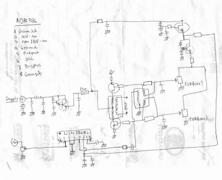

lumanauw said:Hi, Mike,
This is the cap multiplier. Q14 and Q15. It multiplies the cap by HFE value, because the only thing that is attached to the base is cap and small current leakage from R for turning the Q on. It gives very clean +/-rail for front ends. The R and C makes a lowpass filtered that is injected to base.

Hi, Sajti,
Thanks for the info. I made cap multiplier with 1k resistor + 22uF cap. I measured Vce is only 0.9V Is this too low? You suggested 1.5-2V drop. Is this for the Vce?
This is another example of cap multiplier. The amplifier itself is a non-feedback, transformer output (Jensen) SS amp. The sound is marvelous, but it needs clean supply, so the designer put a Darlington for cap multiplier.
The cap multiplier darlington is made by C5200, driven by BD139.
The designer put Darlington so he can get low drop while needed big current for the audio amp?

I suggest the 1.5-2V, but of course it depends the load, and the ripple on the line. It's easy to imagine: The capacitor keeps constant voltage. At the input of the multiplier (collector of the pass transistor) You can measure the ripple voltage, which is AC over the DC. If thi ripple makes the input voltage of the multiplier less than the voltage in the capacitor, the CB diode in the transistor will open, and this will results drop in the output.
Another thing I use for the cap multiplier is 100ohm basestopper resistor. This is just to avoid oscillation.
0.9V Vce can be enough, if the load is just few mA, and there is no more ripple than 2-300mV over the input DC voltage. I would increase the series resistor to 2.2kohm, which will results approx 1V Vce.

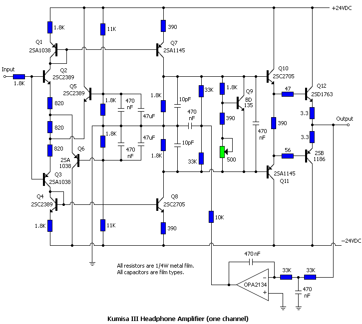

Ah, i understand. Are we talking about symetrical or ccs-loaded vas ?
Re's don't have much impact on gain in the vas. The gain for a ccs-driven
or symetrical vas is very high (> 1:5000) and can only really reduced
with R-loading. This means you put 2 resistors from the Vbe inside
the vas to ground. These must not be too big, or gain drops below
a level necessary for full voltageswing. The minsize of these resistors
depends on the currentbias of the vas.
My experience with identical RE's was a lower DC-offset.
For the case i misunderstood you, can you show a schematic ?
(A ccs-driven or symetrical vas is also some kind of currentmirror)
Mike
Hi, Mike,
This is example of what I intended to do. It is from the sch submitted by Thanh. Look at Q1 and Q7. If I make both RE resistor 390ohm, wouldn't it perform a VAS that has no current gain? Because the current entering Q1 will be the same as the current leaving Q7 if both RE are the same value?

Hi lumanauw !
You're confusing me, VAS is a voltageamplification, means you should
look at voltagegain not currentgain. The 1.8k to gnd set the gain
for the vas, Q1/Q4 are only diodes. If you change the 1.8k at q1, you
also change the biascurrent in vas, so is the 390ohm.
Q1 is for increasing bias, without increasing gain.
As this is a symetrical vas, you should keep values symetrical, or you
get large dc-offset.
Mike

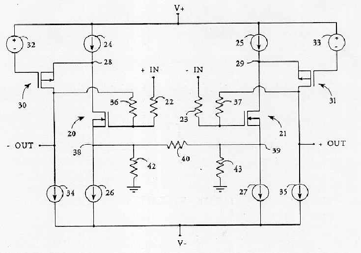

Hi, Mike,
Now I'm confused too😀
The story is like this. With CFP differential, I can make very big current passing thru the differential pair. I can make 20mA ccs differential (10ma to each leg), without ruining the sound.
I get the idea from Susy by Nelson Pass. He stated that Differential+folded cascode maybe considered 1 stage only (I think because the Folded cascode VAS doesnt have current gain).
The items 21+31 or 20+30 are 1 stage. Item 20 and 21 is differential.
I want to make variation of this cct, but only half. Making a differential with big bias + vas that has no current gain, so the both of them can be considered 1 stage only.
I wanted to try the "minimum stage" Phylosophy, since from my experiments, it do tends to get better sound.
Since I wanted to advoid class A, the only way to make 2 stage class AB power amp is with differential+current mirror VAS or differential + folded cascode VAS (VAS that does not have current gain, the current=current in 1 leg of differential).
I think making configuration like this will have excellent stability properties, because all the current gain is happening in the differential only.
