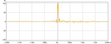

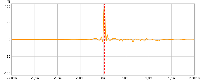

Will offer a bit of help, measure with your Dayton mic into REW, zero align IR with command "Estimate IR delay", then filter with FDW 1/6 octave (4,3mS) and upload a exported IR-wav file here. Will then massage it in Rephase and upload a IR-wav file ready for loading into JRiver convolution container.
Below exercise speaker 10F/8424/SPH-250KE FAST system is aligned nearfield but even it looks crazy when going farfield alignment means a lot for perceived sound and realism. Correction filter into JRiver convolution container correct for high order LR8 at 355Hz and in PEQ container tweeter is delayed 0,4mS.
IR into REW means impulse response.

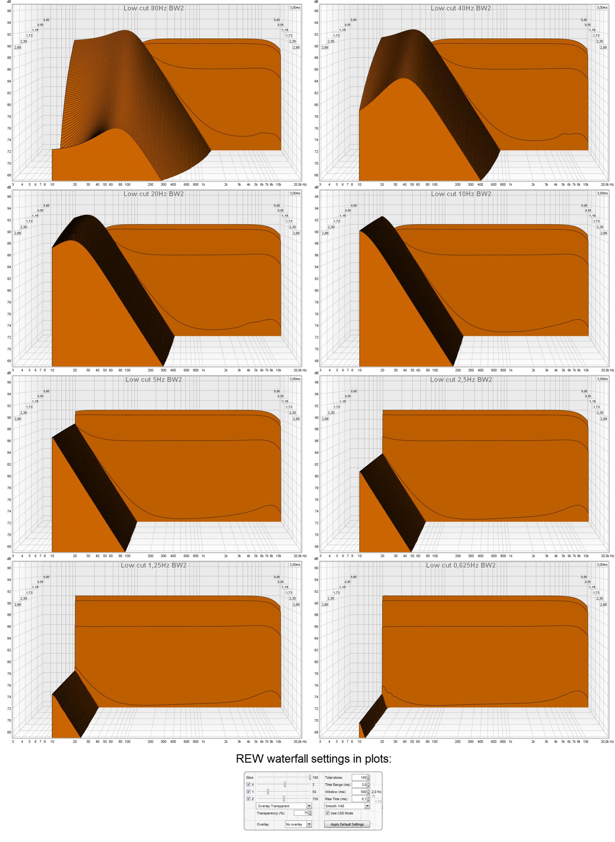

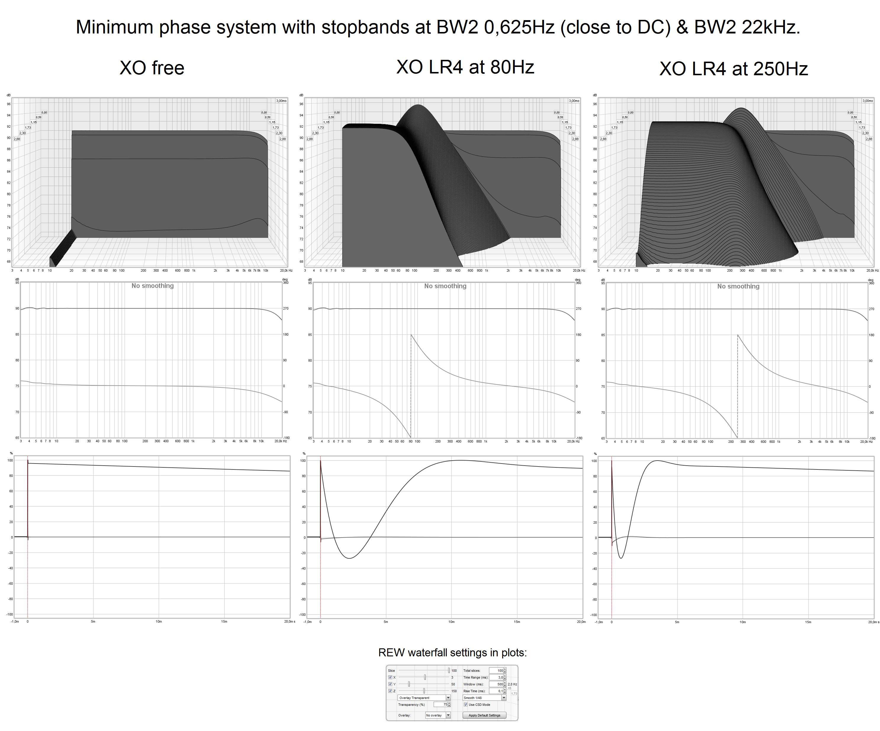

Feeding REW with some perfect band-pass minimum phase devices and looking into waterfall plot seems that below 700Hz also makes sense to what some of us think we hear, as what ErnieM sense in below and also related in below post from wesayso. Know its acoustic speaker in a room we talk about and not perfect band-pass minimum phase devices so probably there is only a chance to get it right at a limited space/axis at listening position, but seems to be possible in real world when looking plots from wesayso's system.
In first picture its to show ringing tails that is added with low frq XO points compared to a XO free domain. First slices of wavefront seems distorted way up high into MF and HF even XO point frq is low.
In second picture all plots is XO free, but is to show the lower in frq the system stop-band the less ringing tails up in MF and HF area.
