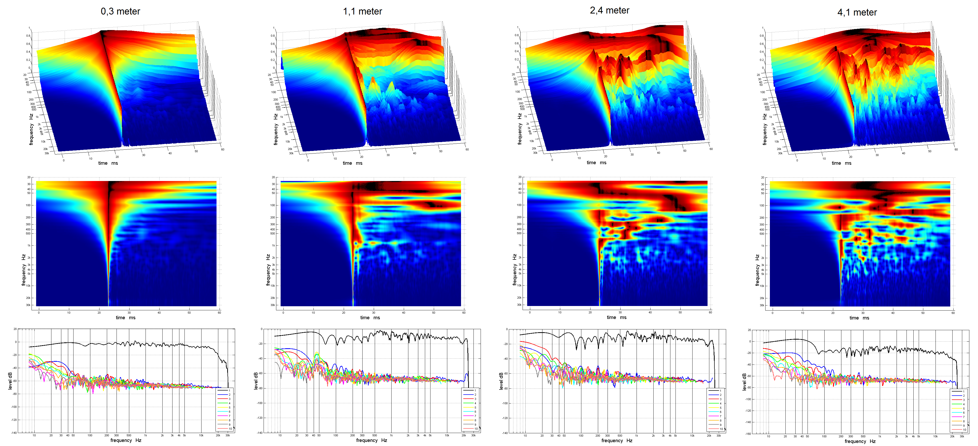

It took me almost a year to find my own specific recipe (that still may change). Do not look at plots alone but listen too. I can hear the difference between linear phase and minimum phase corrected speakers, FR being the same between the two. I did more than just casual tests of this phase behaviour. To me this definitely isn't snake oil. Is it a large difference? To me it is, but not as large as a flat FR. But you've got to work on more than the speakers alone. Your room has to support the efforts. If you browse trough my thread you can see and follow the journey I made.
Think of the speakers and room as one system.
I use frequency dependant windows for the correction, it did matter a lot what length was chosen at which frequency. FR being the same between those plots. I tried anything I could come up with and finally narrowed down to the FDW I liked best. I can tell you that minor differences here can make a big change. But you'll hear it when you get it right. I don't ask for anyone to blindly trust that though. Frankly I don't care. Its the subject of discussion here so I shared my experience.
The plot you post here from Stereophile? That was measured at (too) close distance and isn't a representative of what that particular speaker is capable off. Yes I do know which speaker that is. That's how crazy I was to find my own answers.

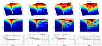

Will offer a bit of help, measure with your Dayton mic into REW, zero align IR with command "Estimate IR delay", then filter with FDW 1/6 octave (4,3mS) and upload a exported IR-wav file here. Will then massage it in Rephase and upload a IR-wav file ready for loading into JRiver convolution container.
Below exercise speaker 10F8424/SPH-250KE FAST system is aligned nearfield but even it looks crazy when going farfield alignment means a lot for perceived sound and realism. Correction filter into JRiver convolution container correct for high order LR8 at 355Hz and in PEQ container tweeter is delayed 0,4mS.
