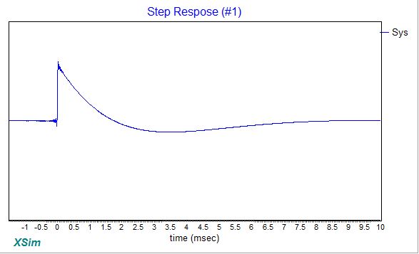

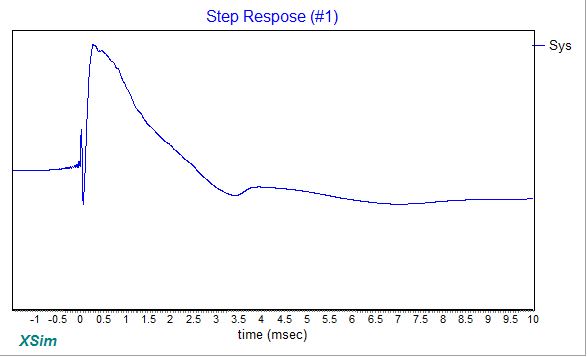

Hi Wesayso,
I'm a little confused because I thought I was asking something very simple. Let me use some fake data.
First, a two way, phase aligned but not time aligned step response:
attachment.php
As you can see, the tweeter arrives at t=0, before the woofer about t=0.3 milliseconds, causing the classic spike, then triangle. Now, in a time aligned system, the step response would look more like this:
attachment.php
Obviously, this is a mock up, but the point is, the initial arrival of the woofer and tweeter are coincident. They merge to form the single rise at t=0.
What I'm curious about is, given the same drivers, if there's a significant audible difference, and if so what exactly that is. Another way to ask this is, what audible benefits are there by moving the tweeter away from the woofer? Better imaging, more sparkle? Spaciousness?
I'm also aware that electrical vs. acoustical delays are not equivalent in terms of the polar reponse. I'm not interested in that right now. Just want to know, WHY bother time aligning a tweeter to a woofer?
Thanks,
Erik

Time alignment in a conventional two way can offer practical benefits in one or two dimensions just as the unity concept can offer practical benefits in three dimensions. Understanding this, as well as putting faith in published group delay audibility threshhold studies can help to side-step concerns related to this excess group delay.
A direct A/B comparison seems easiest with DSP active crossovers, so that you compare:
1 - 2 way crossover designed without any time delay
2 - 2 way crossovers designed so that the tweeter is delayed in such a way as to reduce the acoustic offset to 0. Usually this is the time equivalent of 1.2" to 1.8" depending on the tweeter or woofers being used. These are just example values!
The reason I ask is that I've seen some promote time alignment (version 2) as being superior. I'm just curious how it sounds. It's easy to see it's better on the scope. I'm less interested in that as in the subjective differences.

Not trying to confuse you 🙂, but may I ask what kind of crossover you simulated in the second example?
Wesayso,
First image is of my current main speaker simulation.
For the second I just wanted to present what I've seen presented as the step of a near-ideal time aligned speaker.
Truth is it's an XSim ideal speaker with a high pass filter on it to make it reasonably bandwidth limited. I just didn't want to get into actual crossover design. I wanted to ask if there is a benefit of spending the time and money to get from the first to the second.
How did thou come to the first plot, Erik? A linear-phase crossover, such as of first order or digital ones, with drivers much closer together than lambda has the step response of the second plot. As soon as one wants to equalize analogue phase distortions, and time distortion being a sort of phase distortion, one needs computers such as cascaded allpasses, bucket chains or binary ones.
