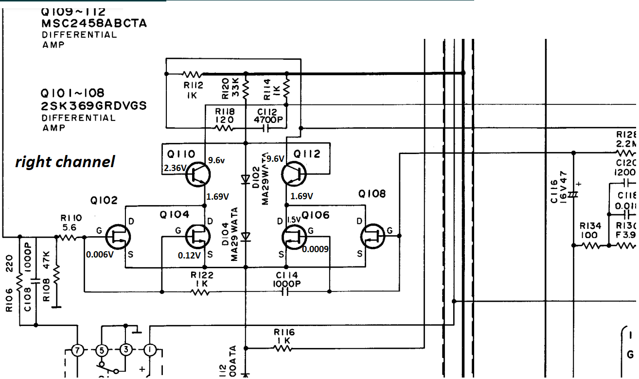

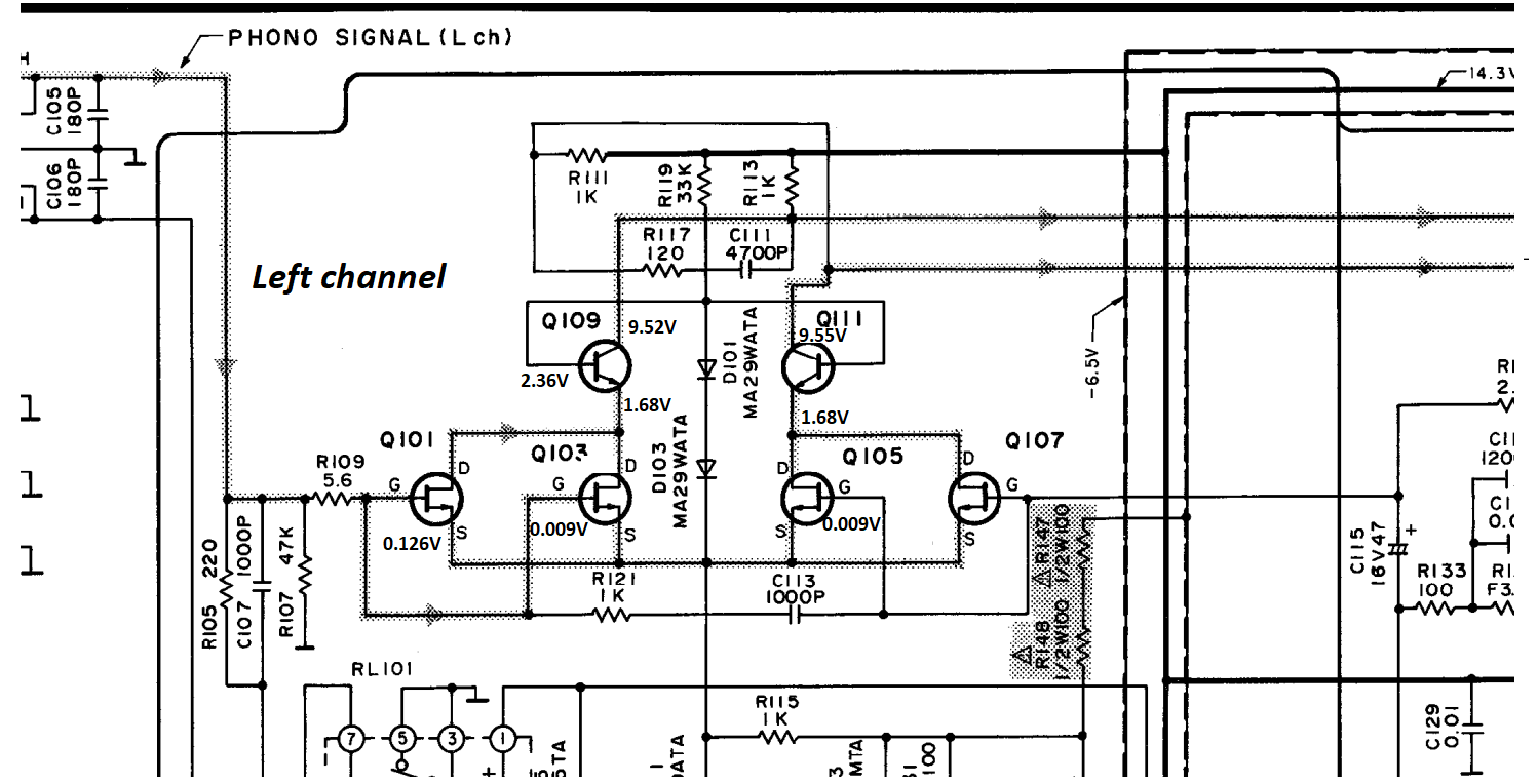

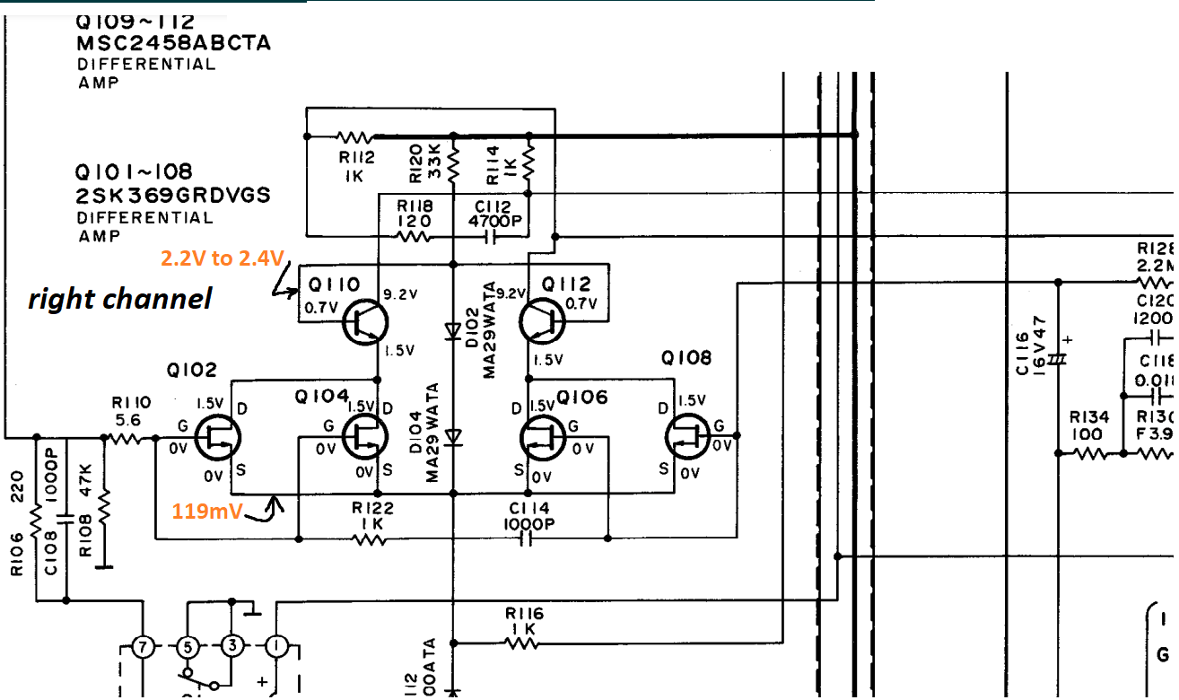

have to find equivalent diode to a preamp MA2C029WA
im reparing a technics su-c2000
the preamp produces low volume that is a bit crunchy

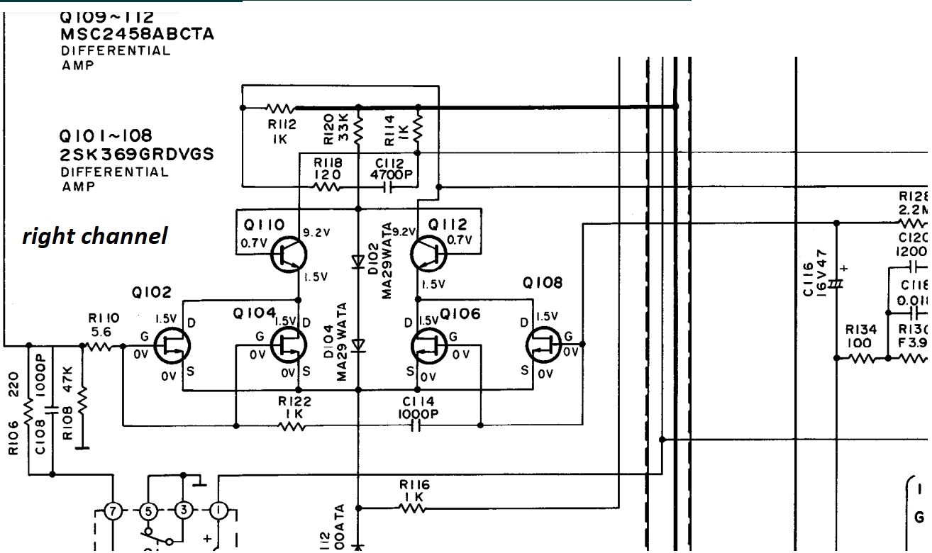

2.36V on base of Q10/Q12 on right channel

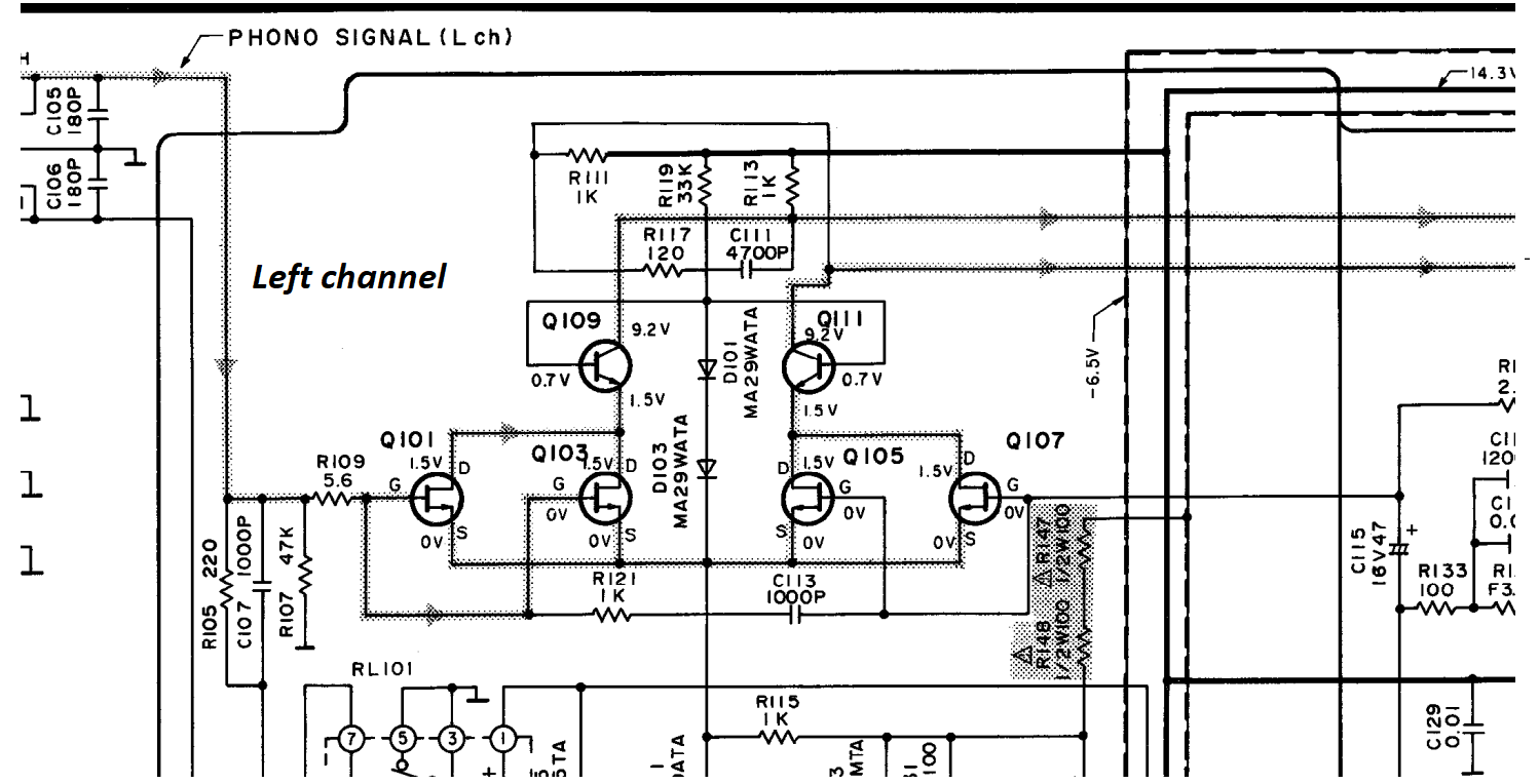

same problem on left channel.
I have taken some volt measurements. see attached documents .
have printed voltage that I got with the multimeter on the schematic
i think the two diodes are broken MA29WATA they are also called MA2C029WA can i find similar some where ??

The diode looks like a series connection of 2 Si diodes in one package. That is why each diode reads about 1.2V, and there should be 2.4V on the bases of the 2 cascode transistors. the absolute value of that voltage is not very critical I presume it needs to be above 2.2V and below 3V. So you can replace them with 4 1N4148 in series. the readout or print of 0.7V and 1.5V does not make sense to me. that would mean the cascode is turned off.

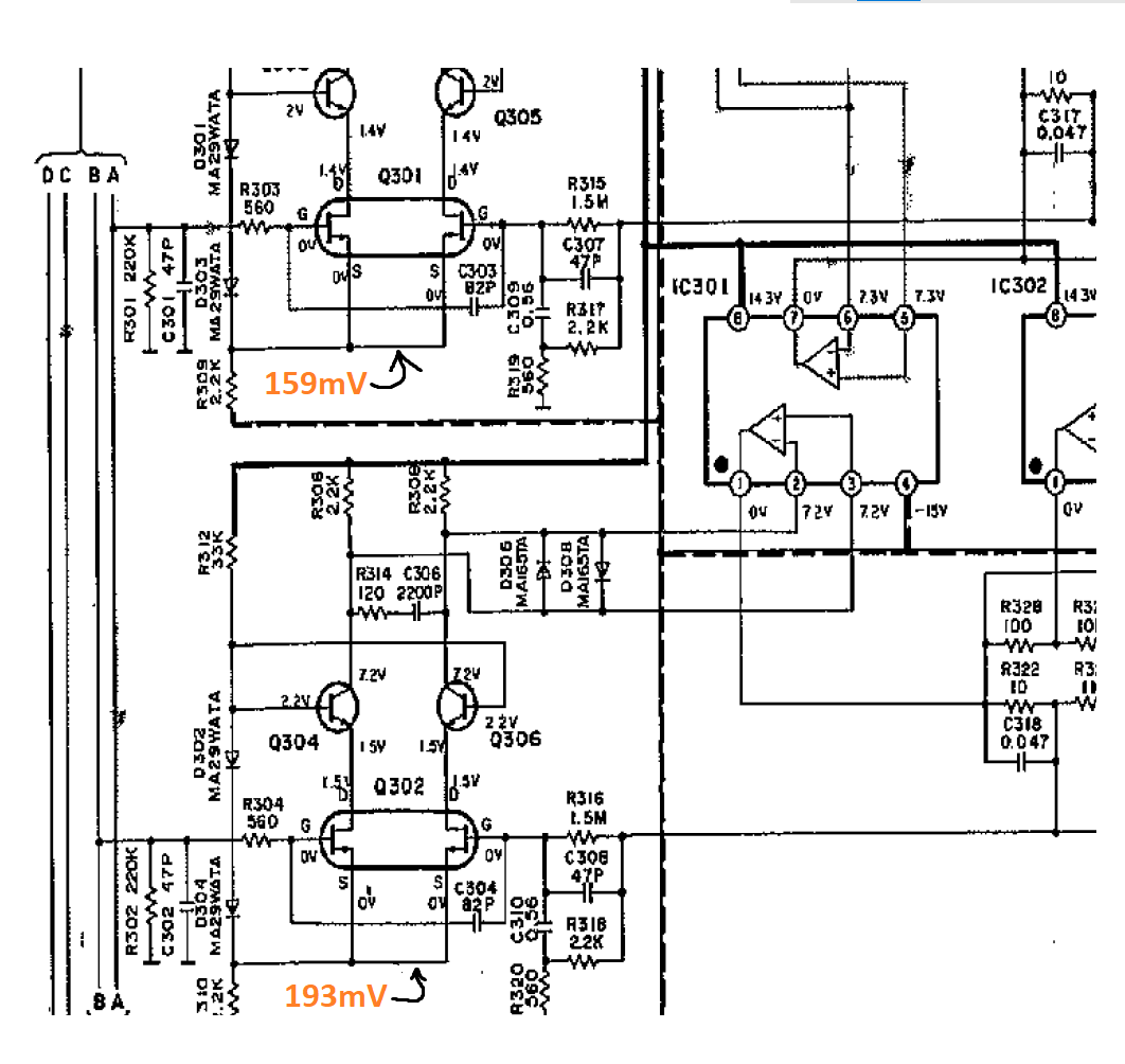

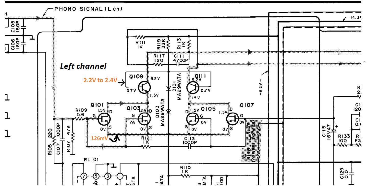

i have measure around the circuits with voltage meter and everything seams to end up the voltages are exactly the same as the service manual i have bean cheeking every where except from front panel circuit .
and i found 6 places where the voltages did not end up with the manual.
see attached document i have printed the voltage that is wrong with red color!
Can anyone figure out where the over voltages are coming from?

all these voltages are correct. the small positive voltage indicates that the fets are running at below Idss, and that is the correct operating range. The spread indicates the spread in Vgs. As indicated earlier the voltage indication in the service manual of 0.7V is erratic.
