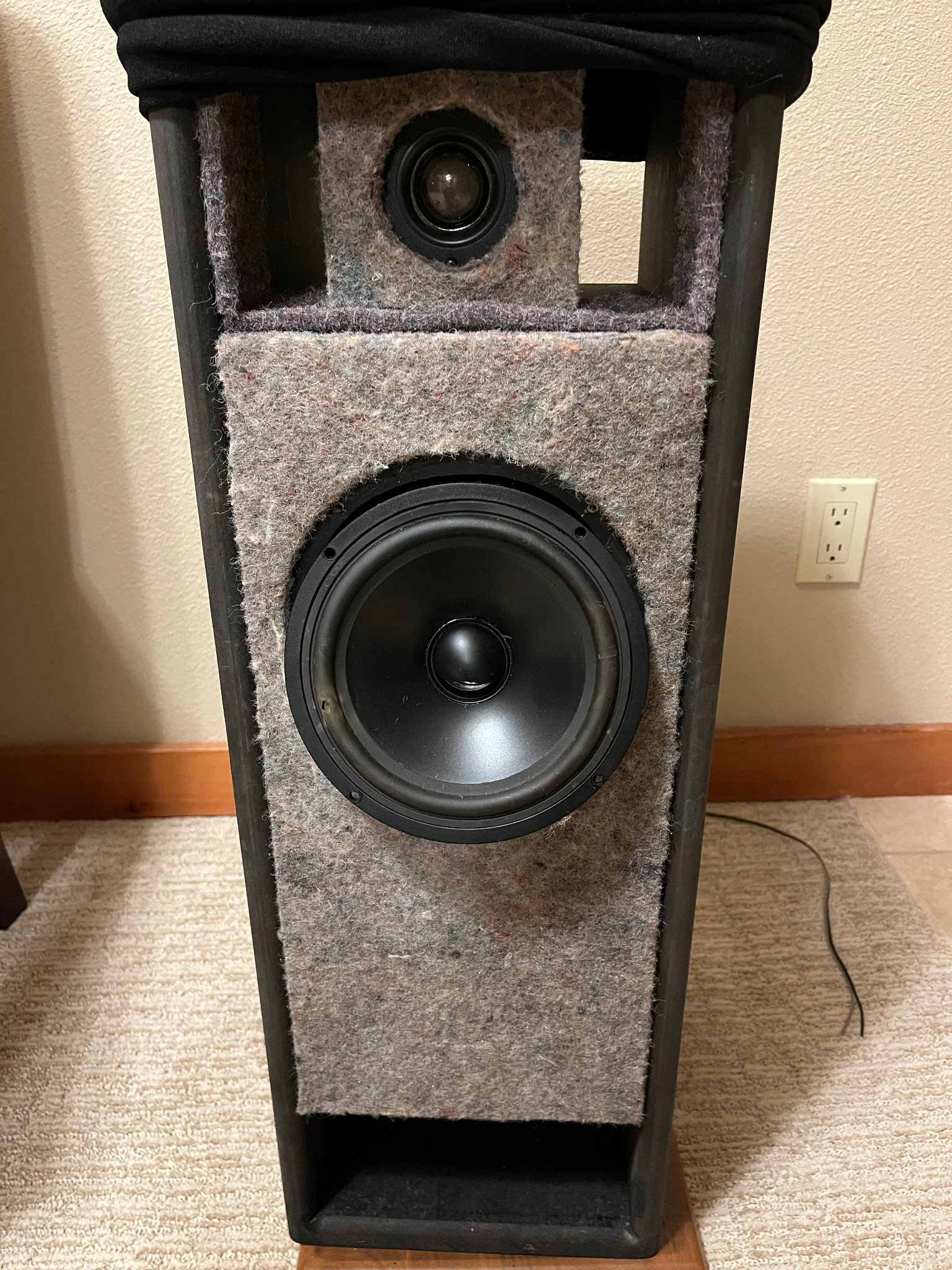

Some of the maths is over my head but you can search more threads on the "ctc spacing" keywords. With a distance of 190mm, this would actually fall into the vituixcad author's recommendation of 1.0-14x spacing ratios for good directivity based on the crossover frequency.@motokok Thank you for the very good article. It's going to take me a while to digest it and, consequently, to understand vertical distance / lobing problem you're referring to. My tweeter and mid-bass driver are 7.5" (190mm) center to center. That doesn't seem very far, but then I'm not experienced in these things.
e.g. 190mm spacing gives a 1.4x ratio for a 2527hz crossover frequency
where f (frequency) 2527hz = 343 m/s (speed of sound in air) / 0.13571m (lambda; wavelength in metres)
and your 190mm = 135.71mm * 1.4
you could use these to evaluate compatible drivers. The DXT and U16 would be good with this, for example, also pretty close to Goran's design I linked before.

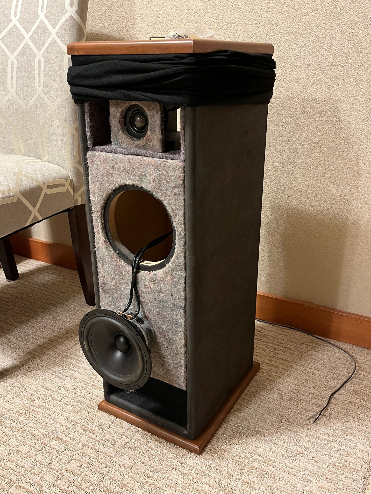

This is actually good, lets you slide paper shims between the VC and magnets to align the coil perfectly, replace surround, and then put a new cap on it. I think them drivers are probably pretty good, just need some love., save you a ton of cash.The rubber around the cones is shot but so is the center piece in front of the voice coil - it's actually half gone on one speaker (the other, the noisier of the two,
If all fails, its not much money and you get the experience.
