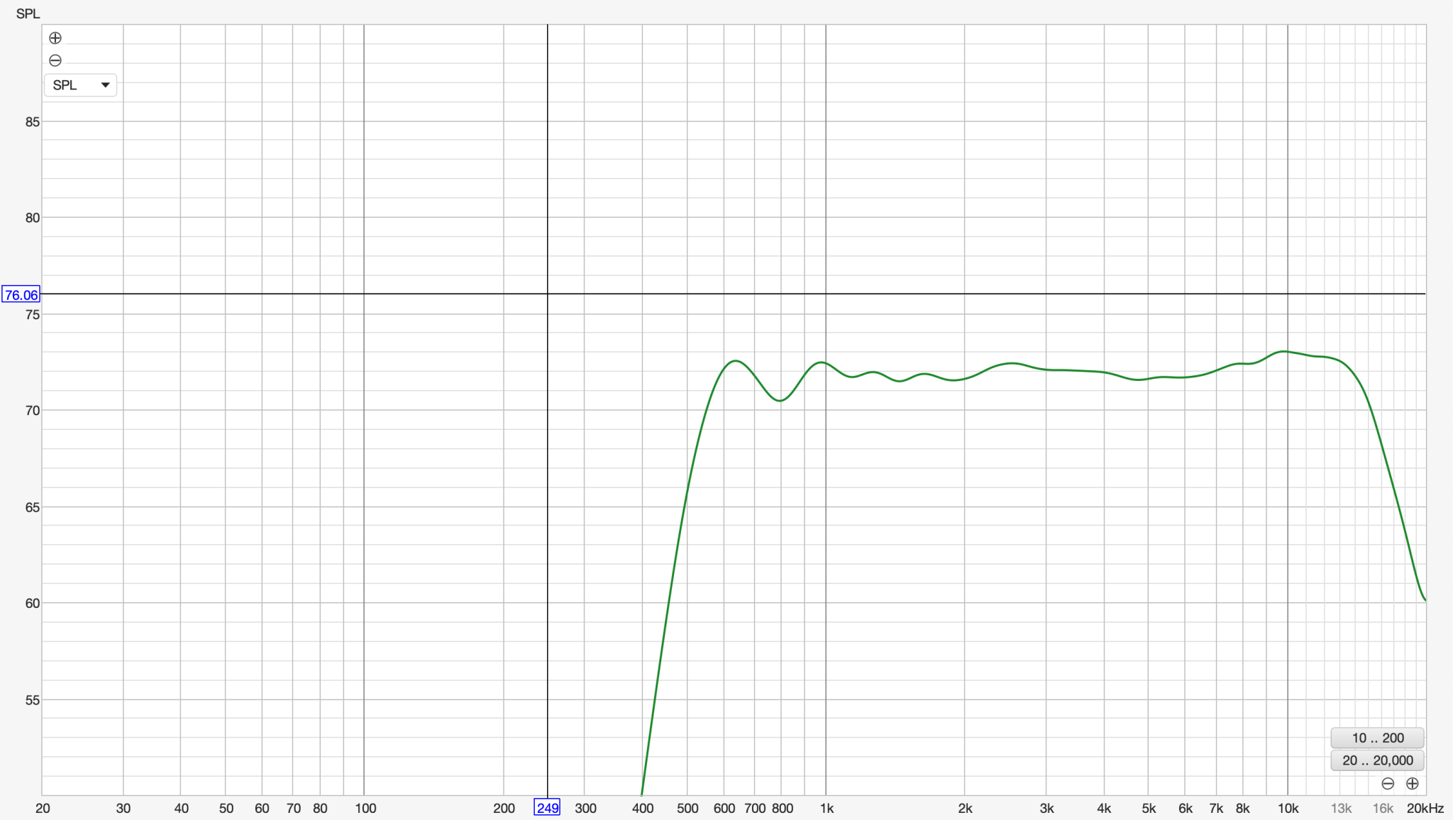

Have some Radian Neo745PB CD's + Ciare PR614 Horns to use in a 2-way build.

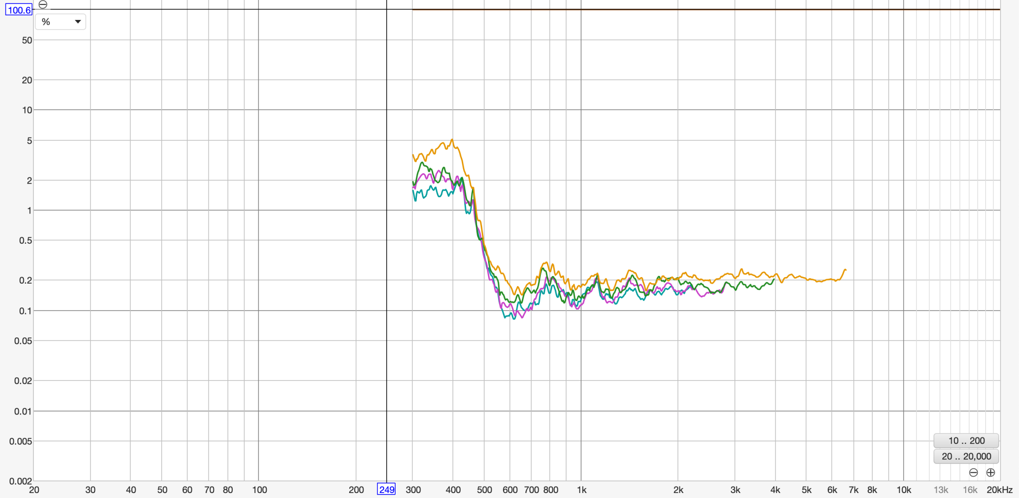

The Ciare PR614 has plenty of output down to 600 Hz. No problem distortion-wise in a domestic setting either. I've used it crossed over ~500 Hz for years with fantastic results.
