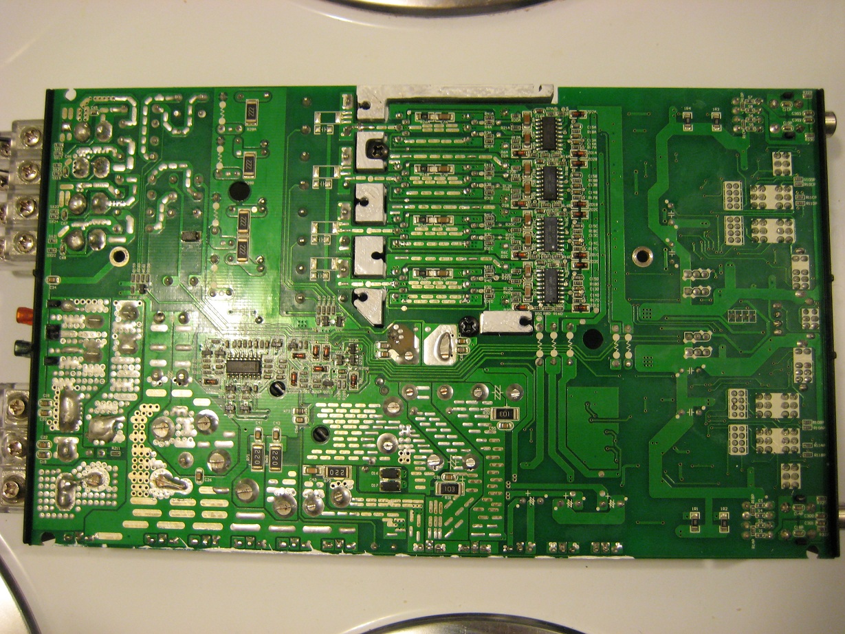

I didn't want to go through the trouble of separating the PCB from the heatsink, but it looks like it might be an IRS2092 or similar design.

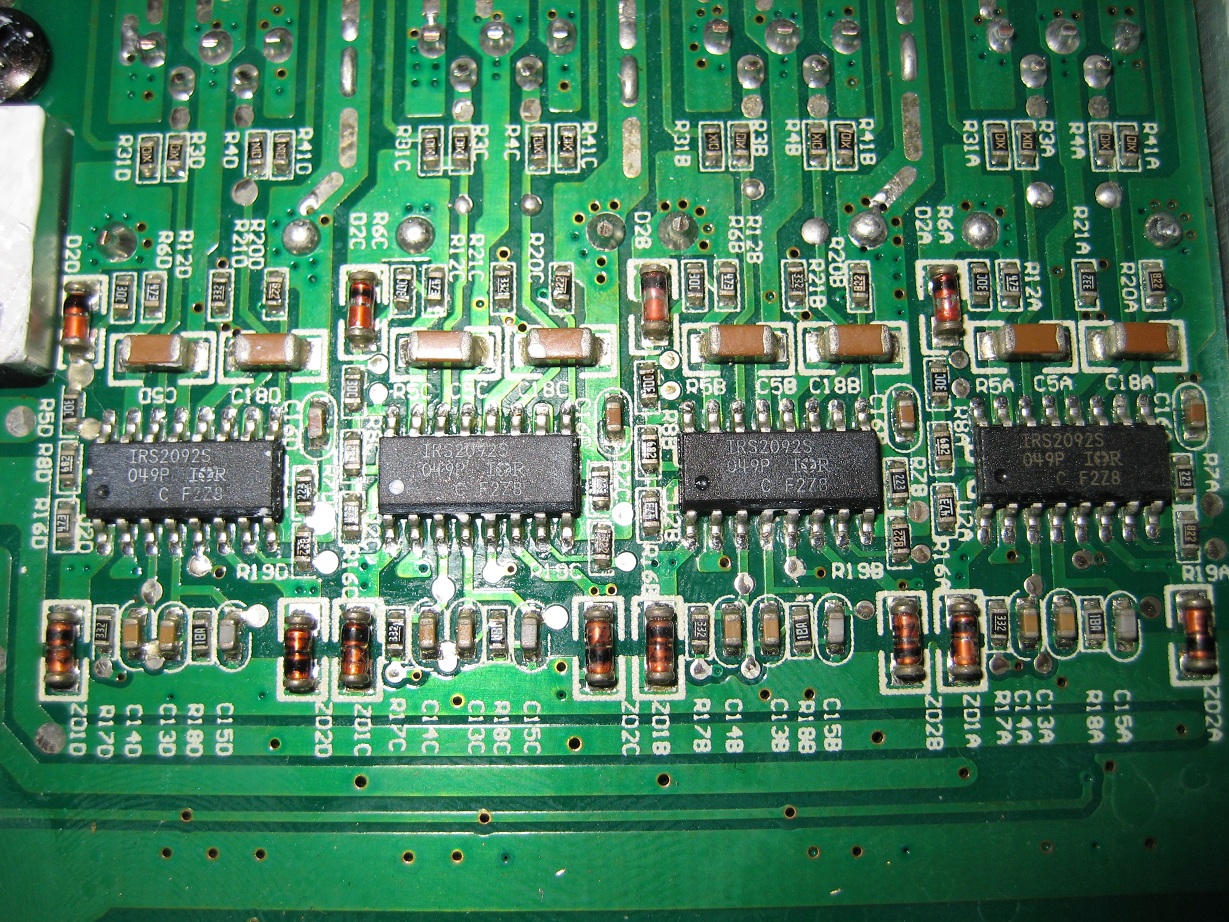

A "chipset" would be a modulator and mosfet driver used to drive external mosfets. Only the mosfets are visible from the top of the PCB... the mystery chispet is on the other side.

Ok, curiosity got the best of me. I took mine apart.
Guess what... I was right the first time! The amp is IRS2092 based with one piece per channel.
Power supply fets are AOT460 if that matters to anyone.
Awesome! So what do you think of the implementation....good, bad or ugly? How is the smt fab, board layout, and parts quality? Anything different about it vs. other designs?
I'm not really qualified to pass judgement on the design, although I see a couple things that don't look right.
Local supply decoupling seems inadequate. There should be something like 330uF-470uF near the output fets for each channel, but the only electrolytics are the two 3300uF bulk caps by the supply transformer. I assume they didn't include them because of space limitations.
The crosstalk is supposedly poor (30dB @ 1kHz?). I forget where I read that, it's not in the manual. There's an input filter that might be partly to blame. The L/R input signals wrap around the same ferrite toroid.
There'se also a few spots with components missing , which makes you ask "why"?
Overall build quality is decent. I guess as long as it works I have no real complaints.
Since I already have the thing apart, I might replace the 10x TL072 with OPA2132.
