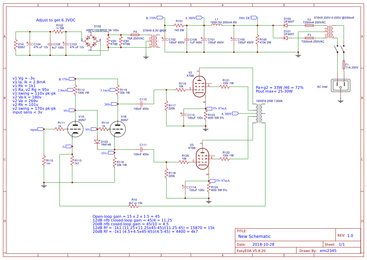

Thanks for your help everyone. It looks like parallel push-pull EL84s is the way to go unless I want to buy new power transformers to get the plate voltages up high enough for a pair of kt66/el34/6L6. What would be the best possible phase inverter and driver configuration to get an input sensitivity of around 1V? We can use up to two bottles per channel, and I’m a fan of the E88CC/6922 and the EF86 pentode but happy to take advice.
Is the E88CC cathodyne/concertina phase inverter from Morgan Jones’ Bevois Valley also appropriate/optimal for the parallel arrangement? Or would a pair of EF86 like the Quad II work better? What effect does an extra pair of output valves have in terms of increased capacitance and load on the phase inverter?
I was look through the datasheets and saw a spec on the GEC KT88 datasheet for 30W for an ultralinear cathode-biased push-pull pair with 375v Va and a 5k output transformer.
My hammond 370HX is 550Vac so I should get 390Vdc diode-rectified, and the opt are rated at 25W 7k6 so I think they will manage, the increased load should bring down the output power a bit. The bias point is -35v so the phase inverter needs to swing 70v per tube. I would only need to buy an extra power transformer and choke to make monoblocks.

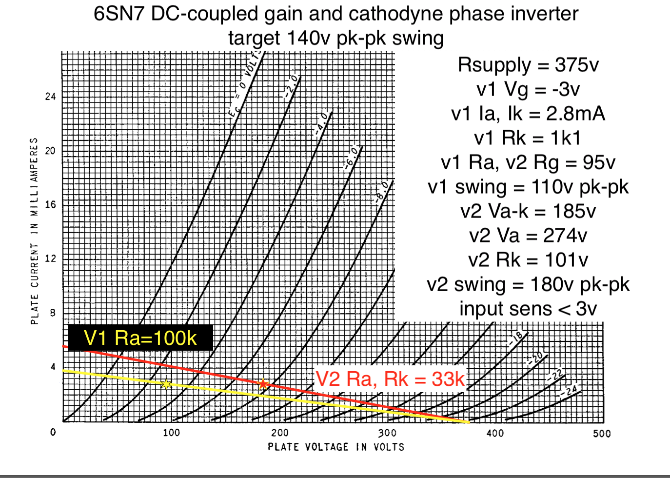

I've drawn up a design using a DC-coupled cathodyne 6SN7 (like the tubelab simple pp) but it might be a little over-stretched. I'd like an input sensitivity of 2v. Perhaps a long-tailed pair with a CCS would be better, they seem popular. Running the KT88 at a lower plate voltage seems uncommon and there aren't many designs out there.
Might this work?
