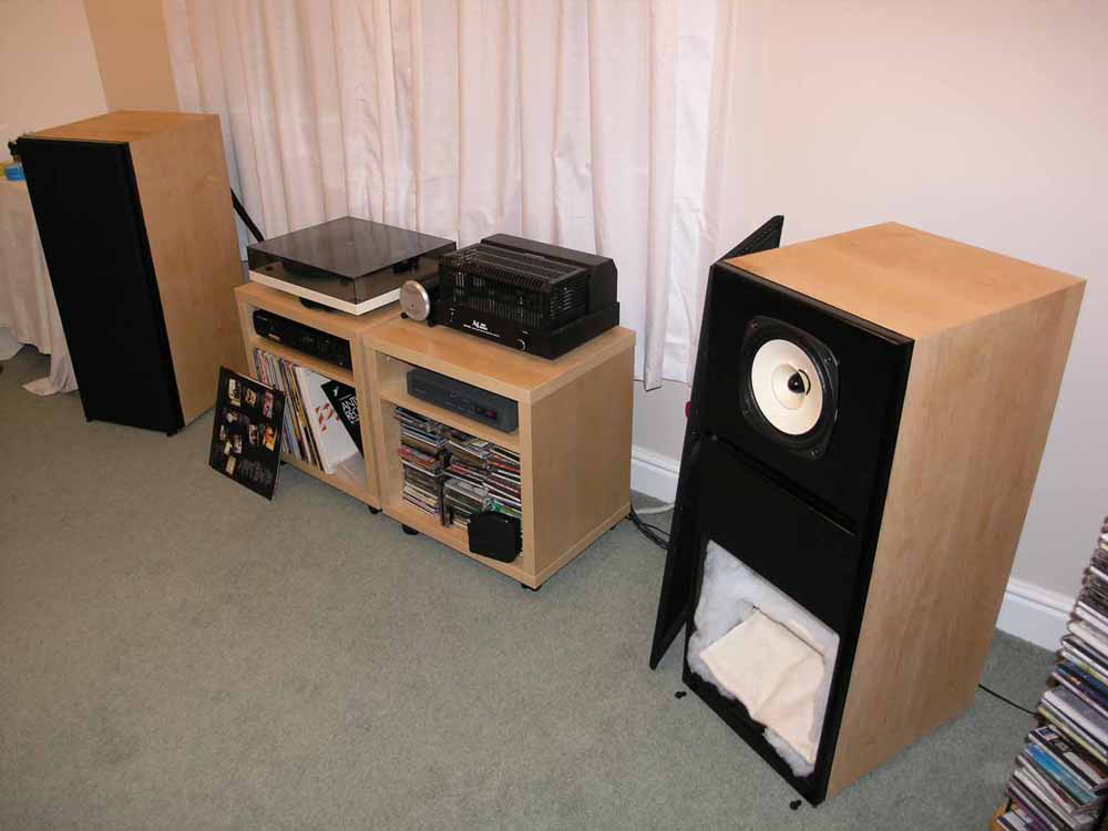

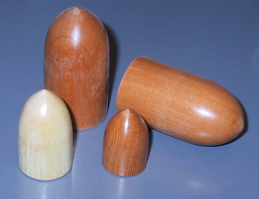

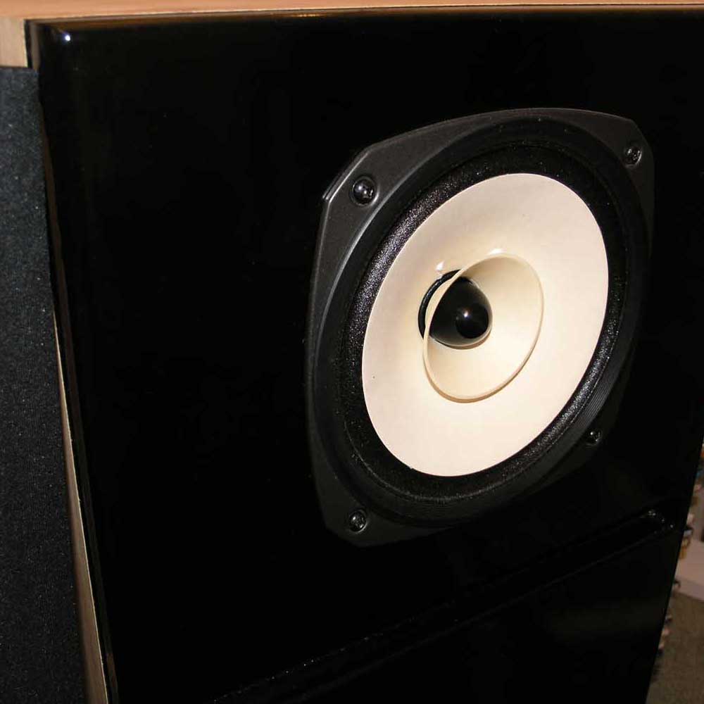

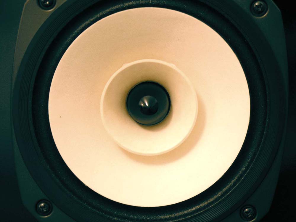

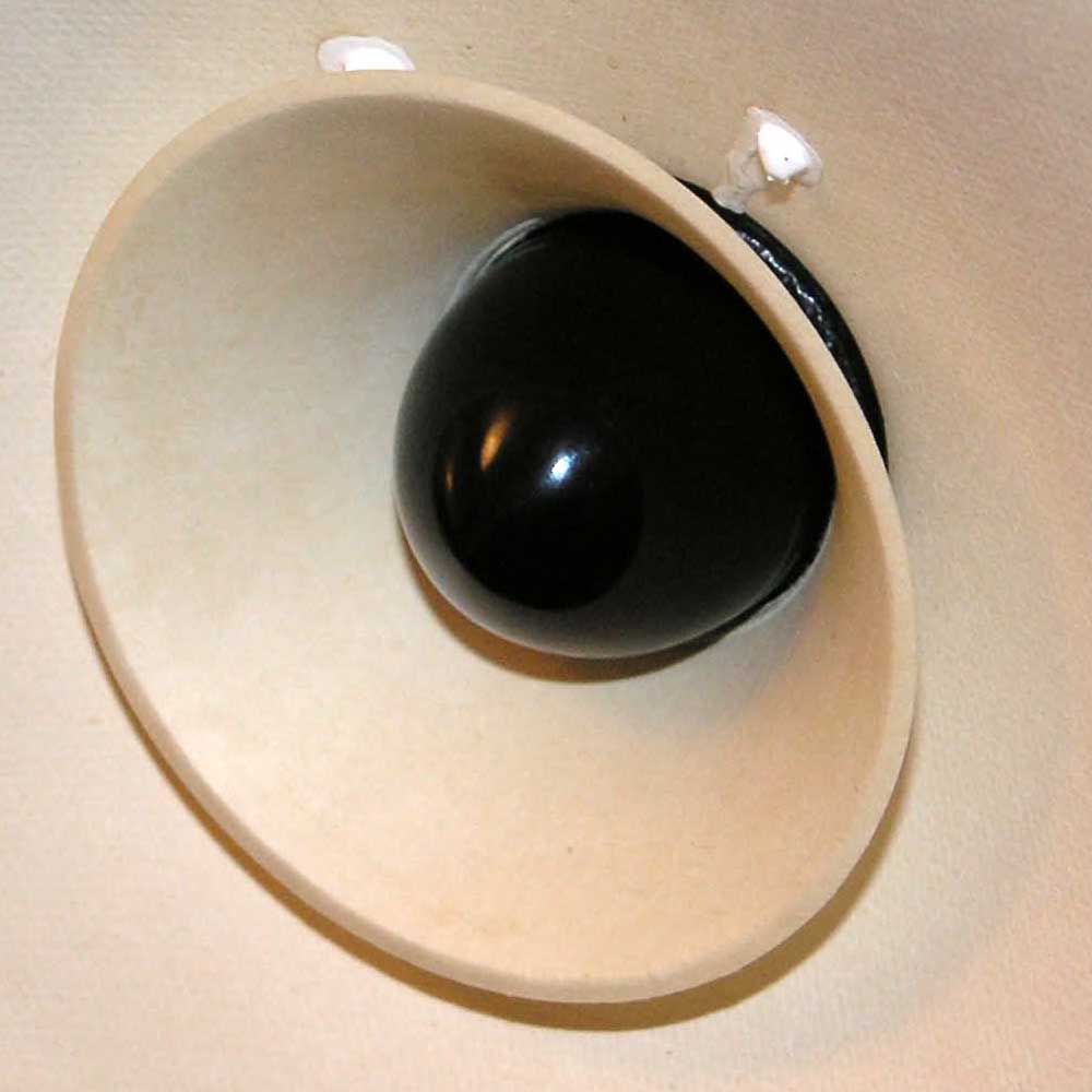

Hi, see its a while since anyone posted on this thread, but anyhow. Incase anybody's interested, I'm using the phaseplugs from Planet10. I'll post a few pics, installation was very easy, just gently stroke the scalpel round the edge of the dust cap, then scrape away any remaining little bits. I went for the light colour ones, because they had them in stock and i wanted a high gloss black finish anyway so was planning on painting them. Only listened to a few albums, but already well worth the 20UKP i paid (including postage), masses more treble detail, less hardness in voices, better imaging etc etc, generally more relax presentation, gives the impression of increasing the resolution of the driver. 🙂
Richard.
Richard.
Those turned out very well. Excellent pictures... OK if i grab them (and the comments) and post them on my website?
dave
dave
rabw said:Yes sure go for it. If you want better quality pictures, I can email you some aswell.
Better than those? I gotta see 🙂
What kind of camera?
dave
An Olympus C-8080, not as good as an SLR or DSLR, but still takes nice pictures. Menna have the best image quality of any of the Semi-Pro 8Mpixel designs around 🙂 I'll go get a few really close, try and show you the cut edge aswell, although it really isnt noicable at all, and email them to you.
