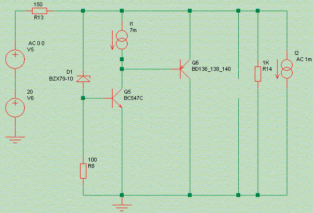

Indeed. Variations on this theme ...

I'm sorry about digging this old thread up...:devilr:
Currently I'm trying to implement a version of peufeu's I/V stage for my Monica 2. The only problem is that there is no way to get workable voltages out of what's feeding the monica for the OPAMP and the CCS, so I have to get an external dual PSU to do the job.
My question is where do I stab the ground of the dual PSU? The ground on peufeu's circuit looks like it should lead back to Monica's analog ground, and not all the current is flowing into V-.... so does that mean I would end up tying the ground of my dual PSU to the Monica's, just by implementing this circuit? This might cause some ground loop issues in my situation...
