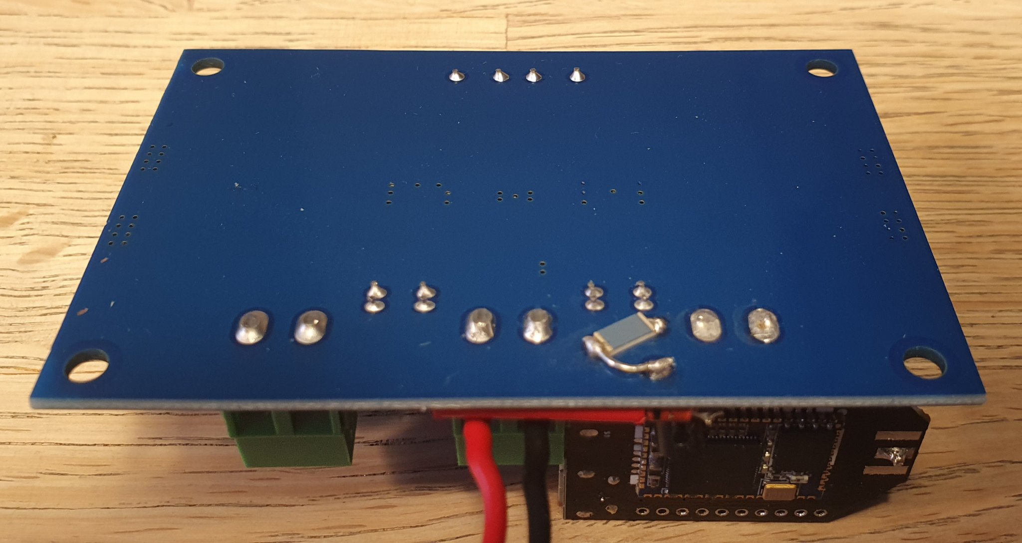

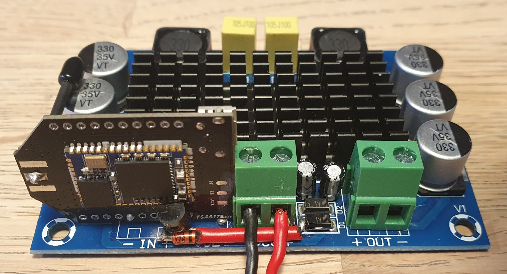

How should the zener diode be connected ? Do I need an additional resistor ?
The Zener is in series with the positive supply to the reg. The end with the stripe goes to the supply. If you get it the wrong way round it will only drop 0.6 volts instead of the marked Zener voltage.
Thanks. Got it.
