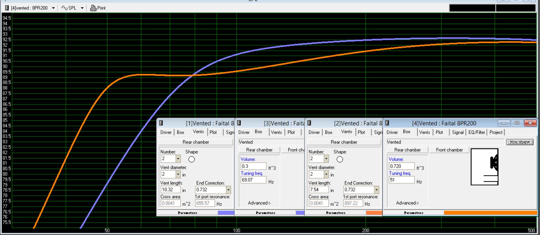

You should be able to get excellent 2-way sound from these speakers.
The T/S parameters of the 18Sound 8MB500 (Re=5.1, fs=74, Qtc=0.43) are "close" but not a "close enough" match to the Faital 8PR200 (Re=5.1, fs=58, Qtc=0.35) to allow a simple switch without both some changes to the cabinet volume or at least the ports, and also changes to the 8MB500 midbass crossover. You also may need additional attenuation (higher value >0.5 ohm input resistor) to the ND1030 compression driver.
Parallel flat sides are typically not a SPL/freq flatness issue, the curved sides on the 18Sound cabinet typically reduce cabinet resonances with simple bracing. The round radius edges on the front baffle are important in reducing diffraction. So, flat sides are fine. So, round baffle edges are worth the effort.
Faital 8PR200 cabinet ideas:
Qtc ~ 0.7, box volume ~0.3cuft, two 2" ports ~ 10.3" long
EBS3(-3db bass-shelf), box volume ~0.72cuft, two 2" ports ~7.5" long
Locating the speaker near a rear wall enhances the bass, and typically complements the droop of the EBS3. Discuss this alignment & near-wall placement with your friend, as it can produce improved bass without boom.
So, a cabinet with internal woofer volume between 0.3 and 0.7cuft can be used with the correct port size selection.

I was hoping you would chip in. I was afraid that you were going to say without two 18 inch drivers to do the bass... this design would be severely flawed. 😀You should be able to get excellent 2-way sound from these speakers.
So this last figure is what I should aim for?EBS3(-3db bass-shelf), box volume ~0.72cuft, two 2" ports ~7.5" long

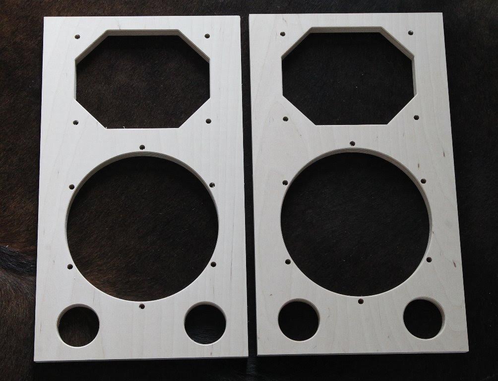

It seems smart to copy the proven 250mm x 435mm front baffle, including the cutouts for the drivers.
A cabinet depth of about 250-260mm should create about 0.7cuft open volume after the speakers+bracing volume. The owner can experiment with EBS3 bass shelf for extended&balanced bass with near wall placement. The internal box volume can be reduced by adding wood blocks internally to reach ~0.3-0.4cuft for a Qtc ~0.7 Butterworth alignment with improved reduced delay and phase shift with deeper in-room placement.

It does.It seems smart to copy the proven 250mm x 435mm front baffle, including the cutouts for the drivers.

1) Box alignment plots can help discussion with your friend on the "bass shelf" alignment and how it complements a near-wall placement for deeper, more even in-room bass.
b) If friend wants to locate speakers several feet into the room for a "wider more 3D" soundstage, the traditional BW3 alignment will have less deep bass, but more even in-room sound with slightly less shift in time and phase. Adjust internal box volume. Now we can sell him on dual 18" woofers.
Faital 8PR200
EBS3 = extended bass shelf -3db
19822cm^3 volume (0.7 cuft volume) tuned to 50Hz with
two ports with internal diameter = 48mm (1.9"), length 183mm (7.2")

Frontpanel finished! Yay.

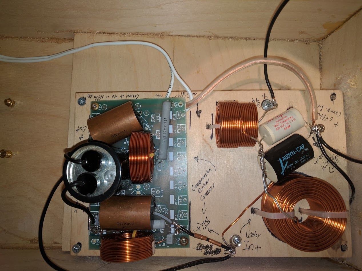

1 Crossover done. 1 speaker done. Except for the damping.
Both speakers done.. Apart from the damping of the enclosure. I am very very happy with the way these puppies are playing. Thanks for the plans 18sound. Thanks also to Bob of rsl.nl for the great service wrt the 8mb500. Very much appreciated. And last but not least thanks to LineSource!!
