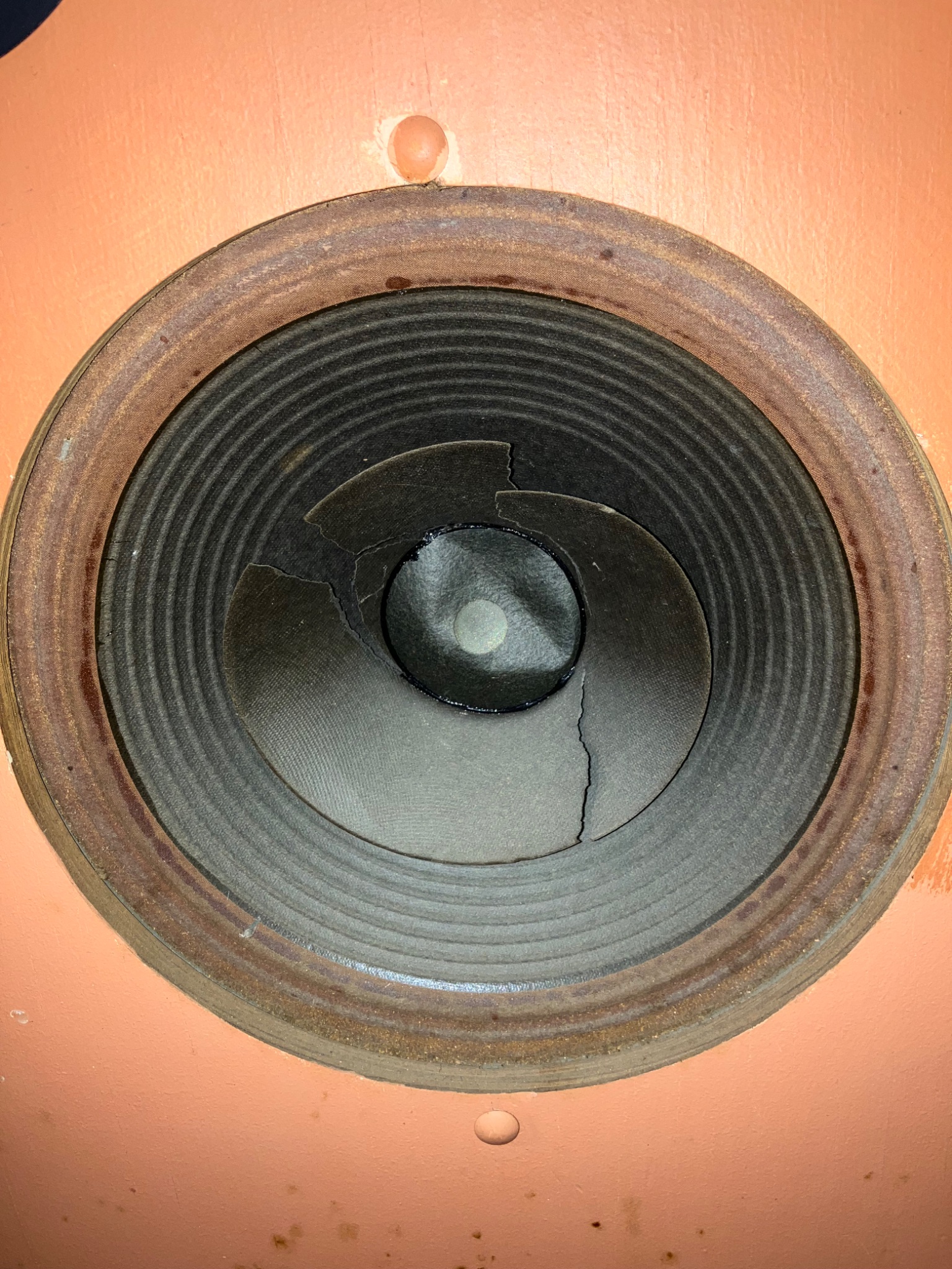

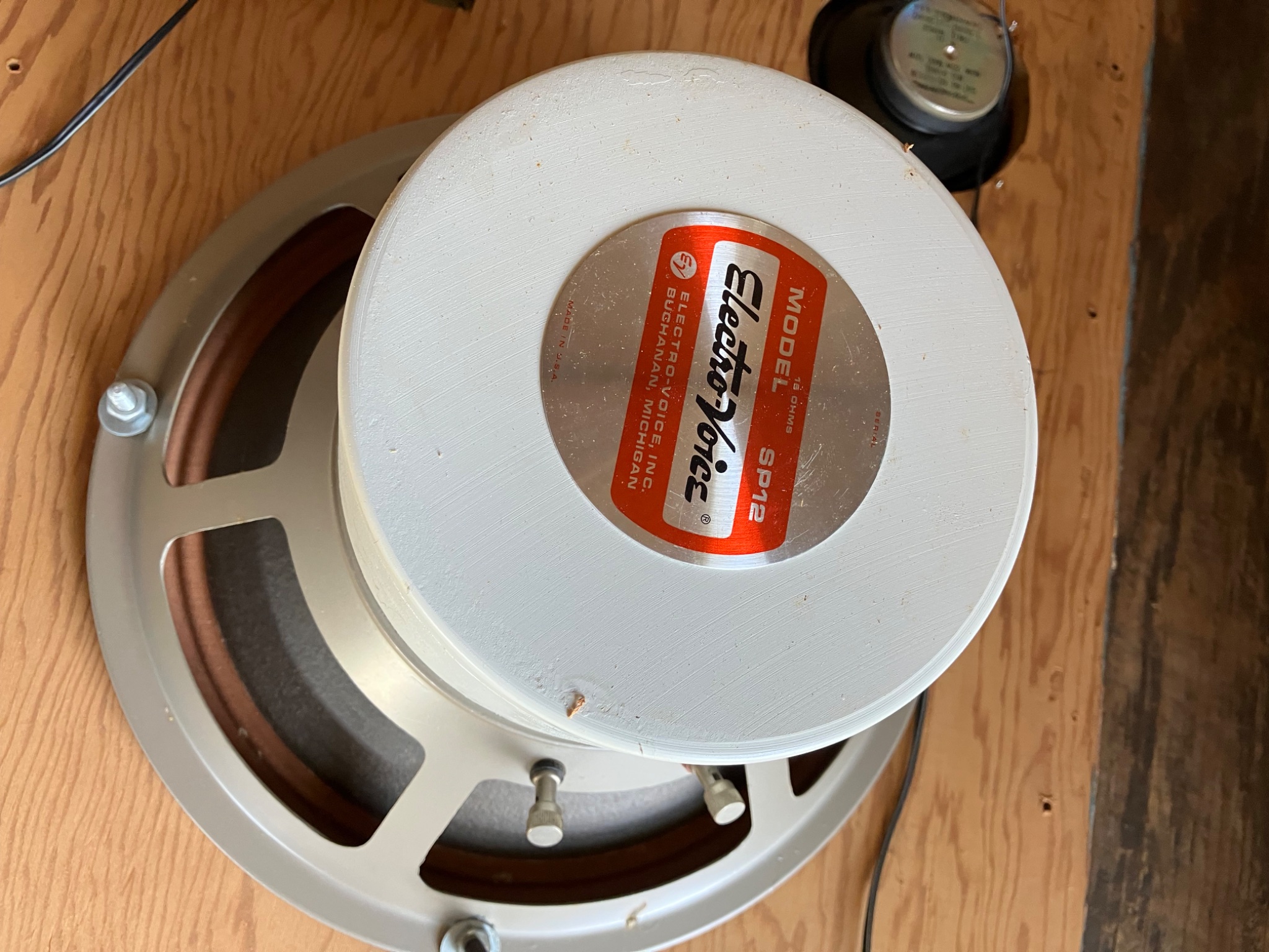

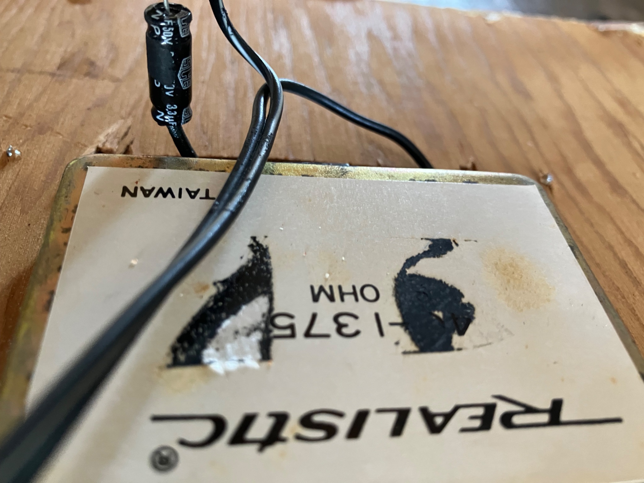

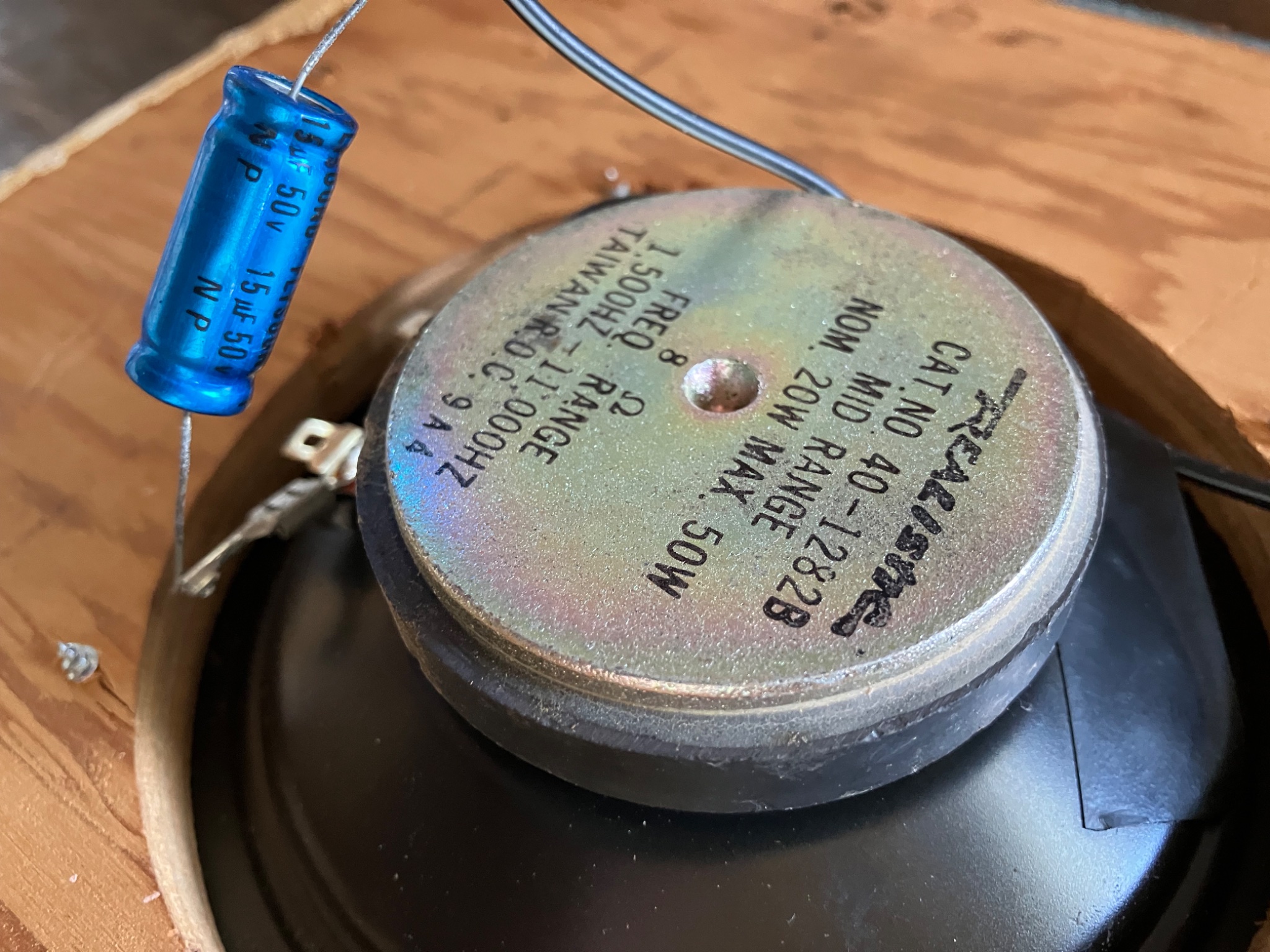

I found these homemade aristocrats with EV sp12’s, realistic leaf tweeters 40-1375, and realistic paper midrange 40-1282b. It has a first order xover with a 3.3uf on the tweet, a 15uf on the mid, and nothing on the sp12. I rewired them, hooked them up and sounded outstanding even with one tweeter blown. I did an ohm test. I want to fix them up. I will rebuild the face to accommodate new design, replace the whizzer cone on the sp12.

Are the xo’s used correct or is that why the tweeter is blown?

Lastly, I’ve never seen an sp12, is that gap between cone and dust cap normal??

Tweeters needed to be crossed 5k or higher and 1st order would not be ideal.
SP-12 has its place
Impedance sweep would tell you the port tuning.
Would just add a new baffle for a new cheap 2 way, refinish the outside.
Recone or just sell the SP12's cheap for somebody else to recone.
