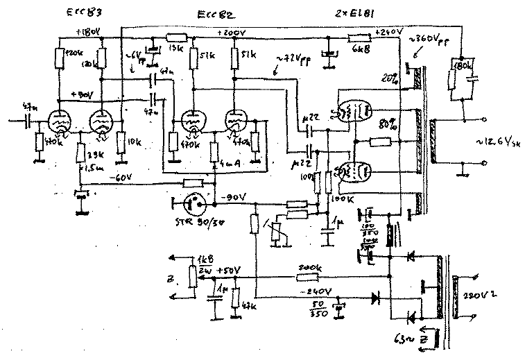

I have some EL81 and PL81 in stock.
Now I would like to use them in any audio equipment. I know they are slightly smaller than the EL84, therefore I could imagine making them PPP. Thereby I hope to get 15 watts out.
One thing I am surprised me greatly is how few schematics i found around this tube. 😕
Have you seen any?
Regards
Benny
Pout~20W!
