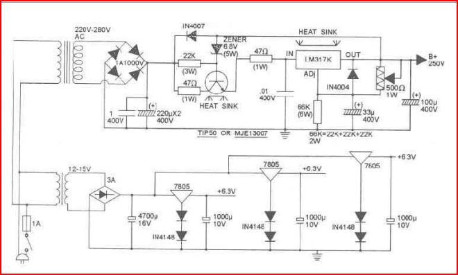

Has anyone used this regulator?

Hi, it probably will work but it is playing with fire. The dangerous moment is when switching it on. Because of the quite large cap at the output it could be that the voltage over the 317 exceeds the max. values by a large margin. Maybe TL783 is a better choice.
I remember Elektor using a 400 V max. rated reg but unfortunately I don't remember the typenumber. That one was also a 3 pin reg.
I found a few regs using parts that are rated for such high voltages.
http://www.linearaudio.nl/t-reg-2.htm

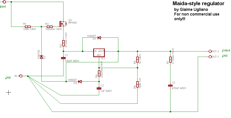

If you'll check very closely, the LM317 will get only 6 volts across input and output, also at startup.
Sy, is the noise you are talking about random noise or high frequency stuff that the Maida is less effective at calming?
Random noise, mostly HF. A few caps knocks it down a bit, but for a cascode phono stage, I'd probably use a quieter reg- it's a good spot for a shunt. With my current phono stage, the PSR is so high that a Maida would probably work fine (I use a simple two transistor discrete reg there).

Ah, OK. That depends on the selection of the trimpot and the parallel resistor. With the values shown in the RLD article, the effective resistance range for the set resistor goes from 42k7 to 46k6. The feedback resistor is 200R, so the output voltage can be adjusted from 1.25(42700/200 + 1.25) = 268V to 1.25(46600/200 + 1.25) = 293V.
The circuit should have at least 20V or so across it to regulate. That can be decreased by decreasing the Zener voltage, if necessary.
