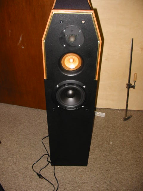

Another question: Is that PR one of the Pioneer 8" PRs that Parts Express and Radio Shack used to have? If so, I also have three of them that are sitting around wondering what I'm going to do with them. You can't hang any mass from them unless you put an extra foam surround on the back, which is what I think will eventually happen with mine.
Yes they are the Pioneer ones.
While you can't hang mass, you can paint the back with white glue or Puzzle Kote. Just be careful not to overdo it because the poor thing will start to sag. Even with only minor mods, they sound pretty good. Better than I expected.

Finally got the Coral mids in the speakers and do sound great. Never heard Jimmy Buffett sound so good. Oh and since this thread started, I have built two more sets. It's about time I received those Corals Dave. 😉
