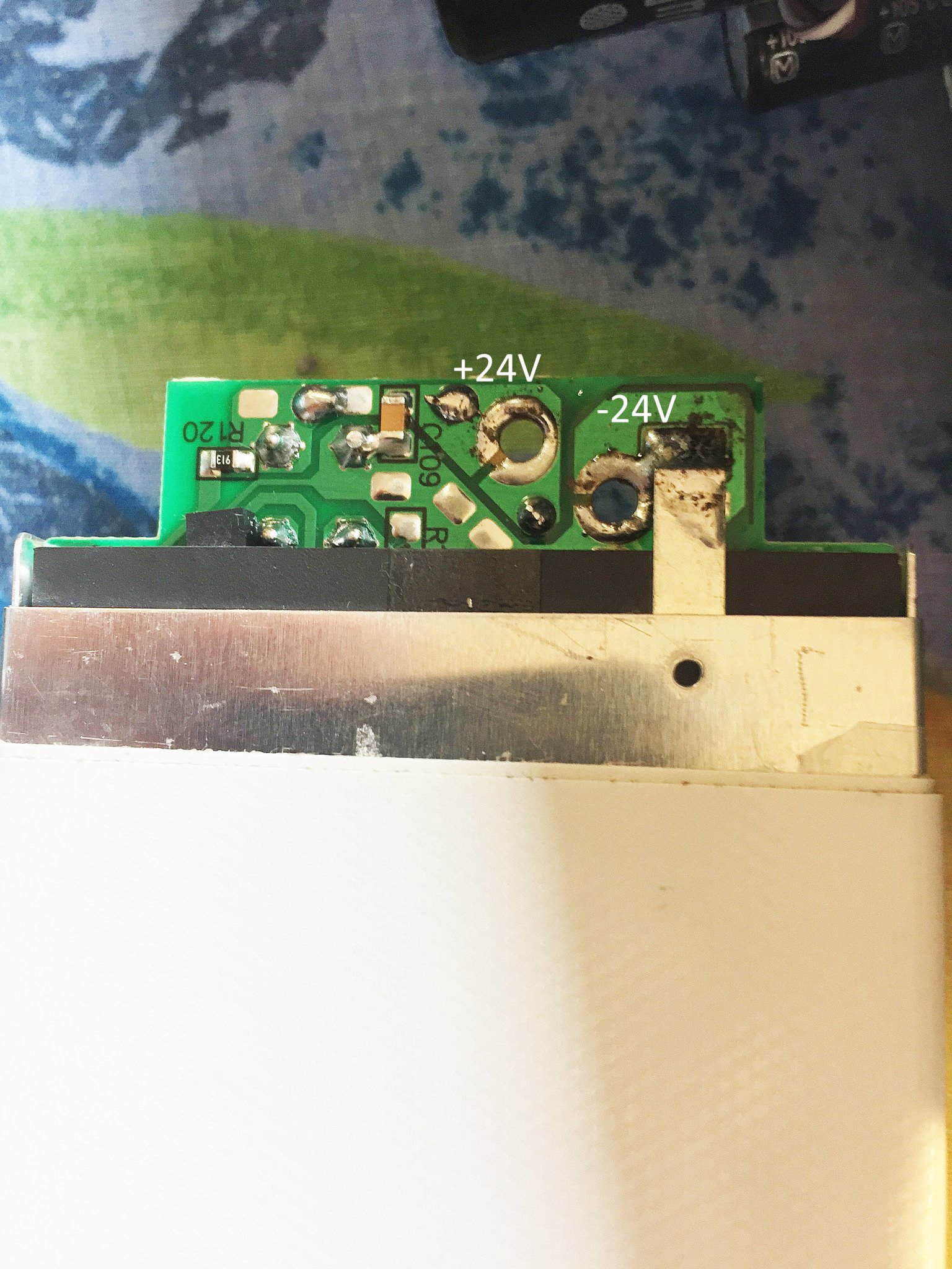

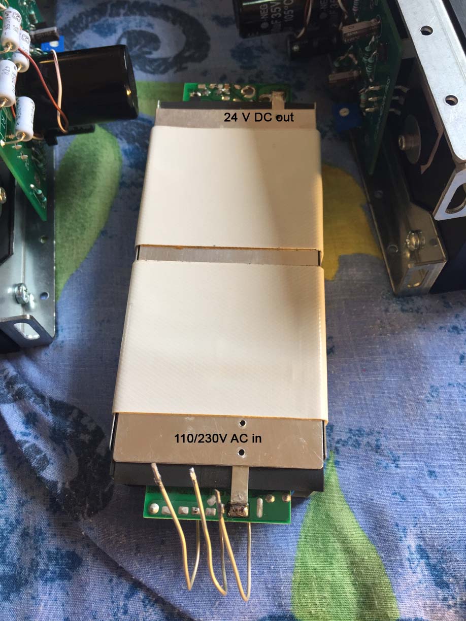

.... make sure the DC common returns (the 0 V... or the negative rails 🙂 ) are not connected to the mains IEC ground...
None of the Meanwells I've used do that. Actually no power supply I've seen does that any more, not even the cheap $5 power supplies available locally. The latter do blow up regularly, but the earth is not connected to either output node.
The one sold in diyaudiostore has a common 0 volts return (24V DC negative) connection to IEC ground.
https://diyaudiostore.com/collectio.../products/meanwell-24v-5a-psu-with-power-cord
@Extreme_Boky I'm not sure what you are showing me in these pics?The one sold in diyaudiostore has a common 0 volts return (24V DC negative) connection to IEC ground.
Metal case is connected to output gnd , the same metal case at other side connected to mains input earth. If you try to connect in series two such power supplies, one will get shorted through earth terminal.
