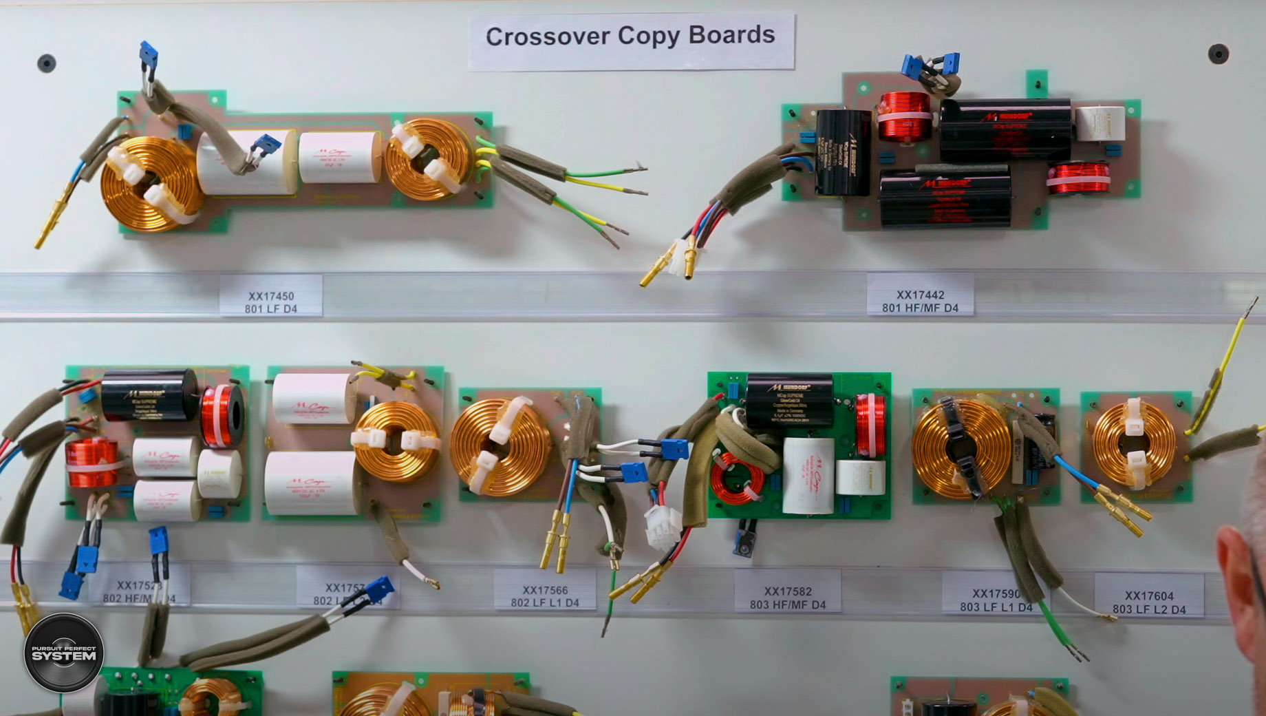

Hmmm interesting to look at crossovers.
Starting from 803 D4 LF crossover seems to have cheap ceramic resistor and electrolytic capacitor.
Also I noticed they start to shunt their crossovers with a small epcos pp caps between traces. Not just now but for sometime already.
Does it improve something?
