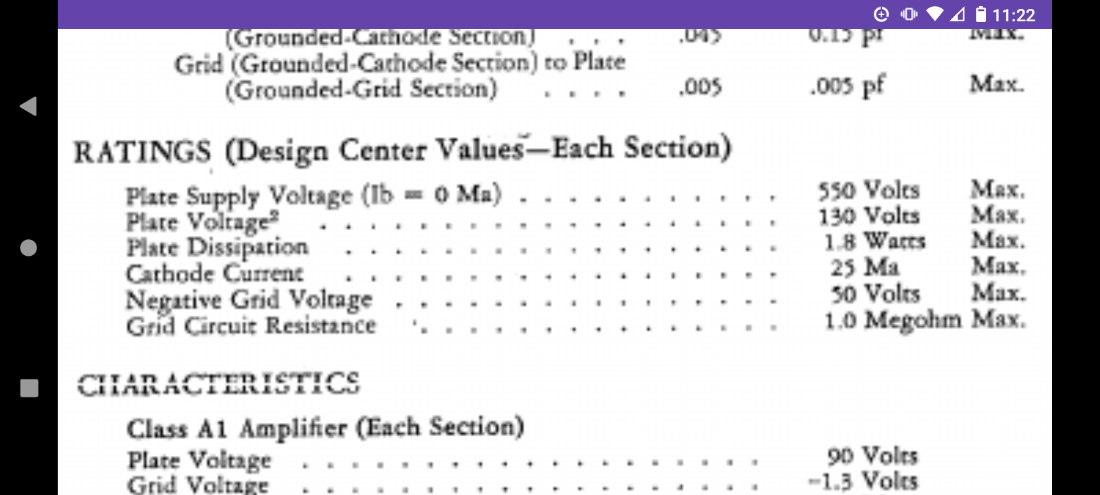

Has anyone used 6DJ8 at B+ around 150V
Sure, the 6DJ8 will work at relatively low voltages. Been there, done that. However, it would work better (more linear) at higher voltage.
If you need low voltage, you might want to look at tubes aimed at operation in battery powered radios and the like. I recently looked a the 3S4, 3V4 and 3C4 DHT triodes, which are superbly linear at low voltages.

Thanks. I have some transformers that would give well over 300V which seemed like real overkill but I also have a 117V that I thought might be useful for this one. I do have one more transformer that I haven't checked yet so it might be better. Initially I had planned on 250V B+.
P.S. I just rechecked and 300V may not be too ridiculous. It looks like with 56k plate resistor and 105-110V on the plate we get about 3mA. Seems reasonable. I think any 6DJ8 variant should be OK with 110V.
Don't trust that calculator over a datasheet! Va max for 6DJ8 is 130Vdc and I think that's pushing it.
Sylvania has a good data sheet for a 6dj8 .
https://datasheetspdf.com/datasheet/6DJ8.html
Recall the heater voltage should not be left floating and there should be a DC path between the heater voltage and cathode .
The max heater voltage w.r.t. the cathode is 150 Vdc . Are you referring to this ?
Also note how the small signal parameters change with the bias current .
The datasheet you referenced:
With 150 volt supply I would shoot for 75-90 volts at the plate. 6DJ8 works well around that region if you keep sufficient plate current.
Just from checking my notes with a 150 volt filtered supply-
A good starting point is 75 volts at the anode, 12k plate resistor, 6.25mA and ~1.7 volts bias (or cheap modern red/green LED) Is a pretty good spot to run them- distortion is almost all 2H at this operation point.
You can drop down to a 10K plate resistor, 75 volts at the anode, 7.5mA, ~-1.6 volt bias or so for a smidge (~10%) lower distortion, but also a smidge lower output swing.
