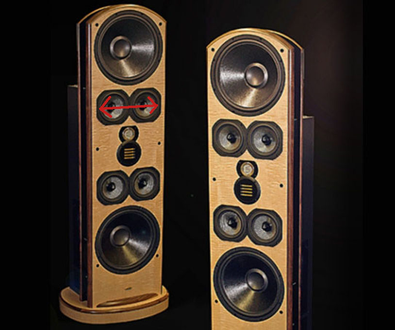

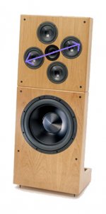

Midranges spread apart - see arrows. The cluster of 4 or 2 midranges will behave somewhat like a single midrange that has an effective size of roughly the size of the red or violet arrow, respectively.What's wrong with this arrangement?
This is two to three times the diameter of a single midrange by itelf, which means problems with beaming and narrow dispersion will start at one half to one third the frequency of a single midrange driver by itself. You might say this arrangment cripples the midranges, and makes them unable to provide their normal high-frequency performance.
In other words, you'd have to move the crossover frequency down by a factor of about two or three times to avoid worse dispersion than a single midrange would have. Usually this is not possible, because tweeters are not able to work down to such low frequencies.
-Gnobuddy

DNA's mid has similar directivity as a 15" driver. The quadruple matches quite well with the dipole 15,5" driver in 18,5" frame. Directivity changes totally when tweeter starts to play! DNA doesn't tell xo points but my quess is 500/3000.
High directivity in midrange is a good thing, but this construction is tricky.

Thanks. The difference between the 'typical' 2x2 array and the patent's skewed array (fig20 vs fig22) is pretty striking - but the skewing doesn't do what I thought it would (based on Patrick's ideas in the other thread I linked).Here's the patent.
The main effect appears to be that it reduces the side lobes by ~15dB.
The patent and measurements in it are just rubbish. The 4-driver flower is acoustically like a single 15" driver. They are just comparing it's directivity to a single 5" driver or a dome. Sure it is different above 500Hz and at wide angles!

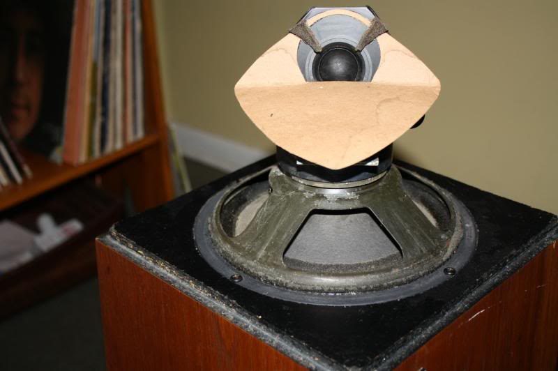

some OHM Walsh speakers use this type of driver mounting to extend the omnipolar radiation higher in the freq range (pic).
and as you say, the spider and magnet would also affect the radiation at higher freq.
