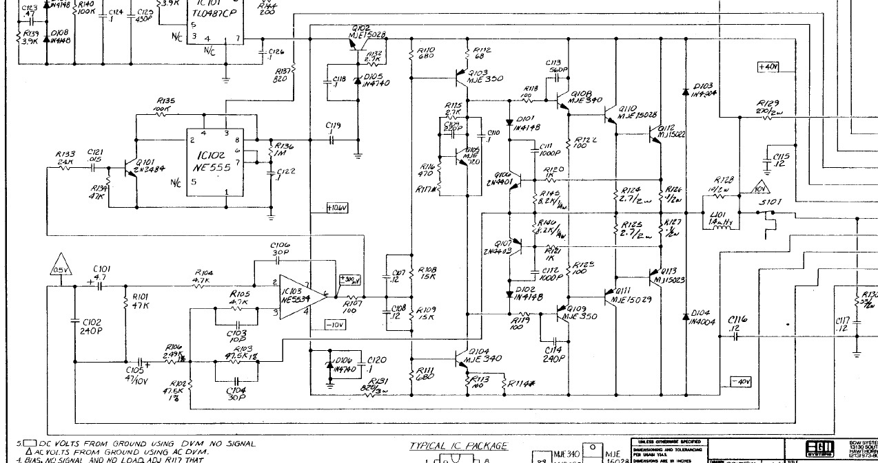

Has anyone tried to re-compensate one of the old BGWs for a 5532 op amp? I know the general topology can be made to work with one - just wondering if someone had gone ahead and stuck one in there in place of a dead 318 and figured out what cap changes were needed with their circuit.
Yes can use NE5532, later BGW have replace LM318 with NE5534a
