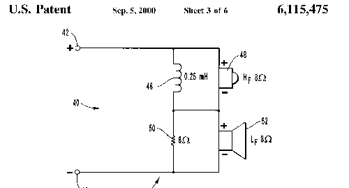

As far as I can tell, Diaural are selling some sort of crossover technology. I've never heard it and I don't use the things anyway so it's not of much interest to me. There doesn't seem to be much information on their web site so I can't even offer an intellectual critique.
There is some info on Diaural crossover technology on their patent.
Just go to www.uspto.gov, download one of the freeware image viewers, (I use Internetiff), fill patent number 6115475, and there you are.
For some reason, that Patent Office link works better if you write it out rather than clickong on the link.
They call it a capacitorless crossover. They use a resistor in place of a capacitor in some way.
Here is the 2 way version:

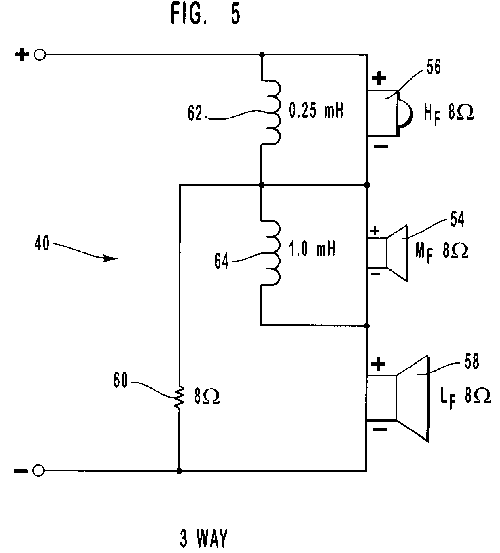

Here is the 3 way version, for those interested.
I leave it to the reader to decide if this is an advance or overhyped guff. I would guess that using a resistor in place of a capacitor might have beneficial results on the phase response.
Just by glancing it at it, I don't know if this makes it possible to have symmetrical second order crossovers without having to reverse the polarity of one of the speakers.
At any rate, it might have value if you can eliminate the necessity of using electrolytic capacitors for drivers that cross over low in frequency.

Well the obvious thing with both circuits shown is you have
8R in parallel with the bass unit at low frequencies, which
is chucking away half of the input power, not good at all.
The only effect of the 8R resistor is to reduce bass unit
treble levels by ~ 6dB, less so if inductance is high (2 way).
Analysis of the "3 way" is highly amusing.
Utter guff IMO, you'd struggle to call it proper 1st order.
