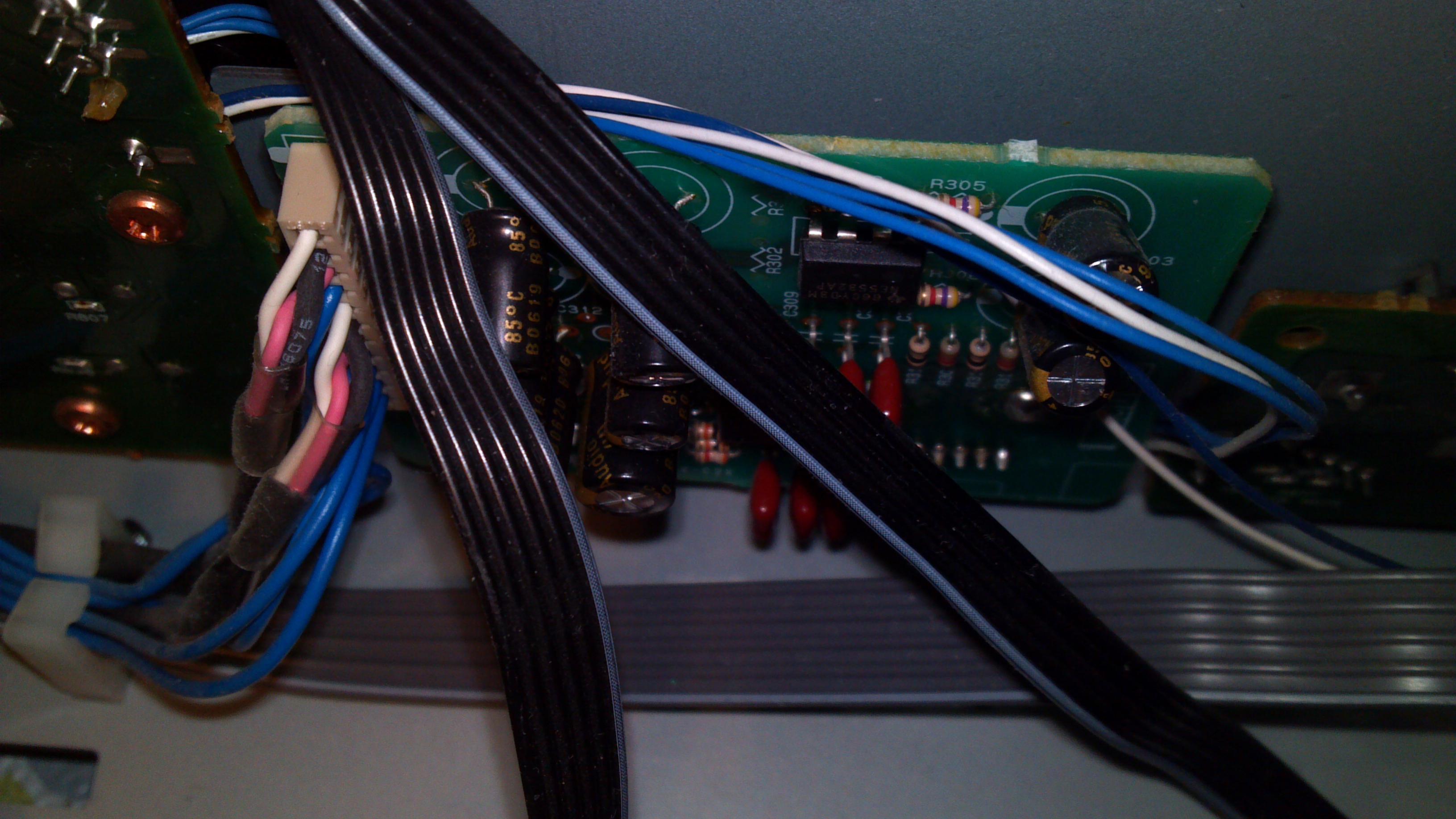

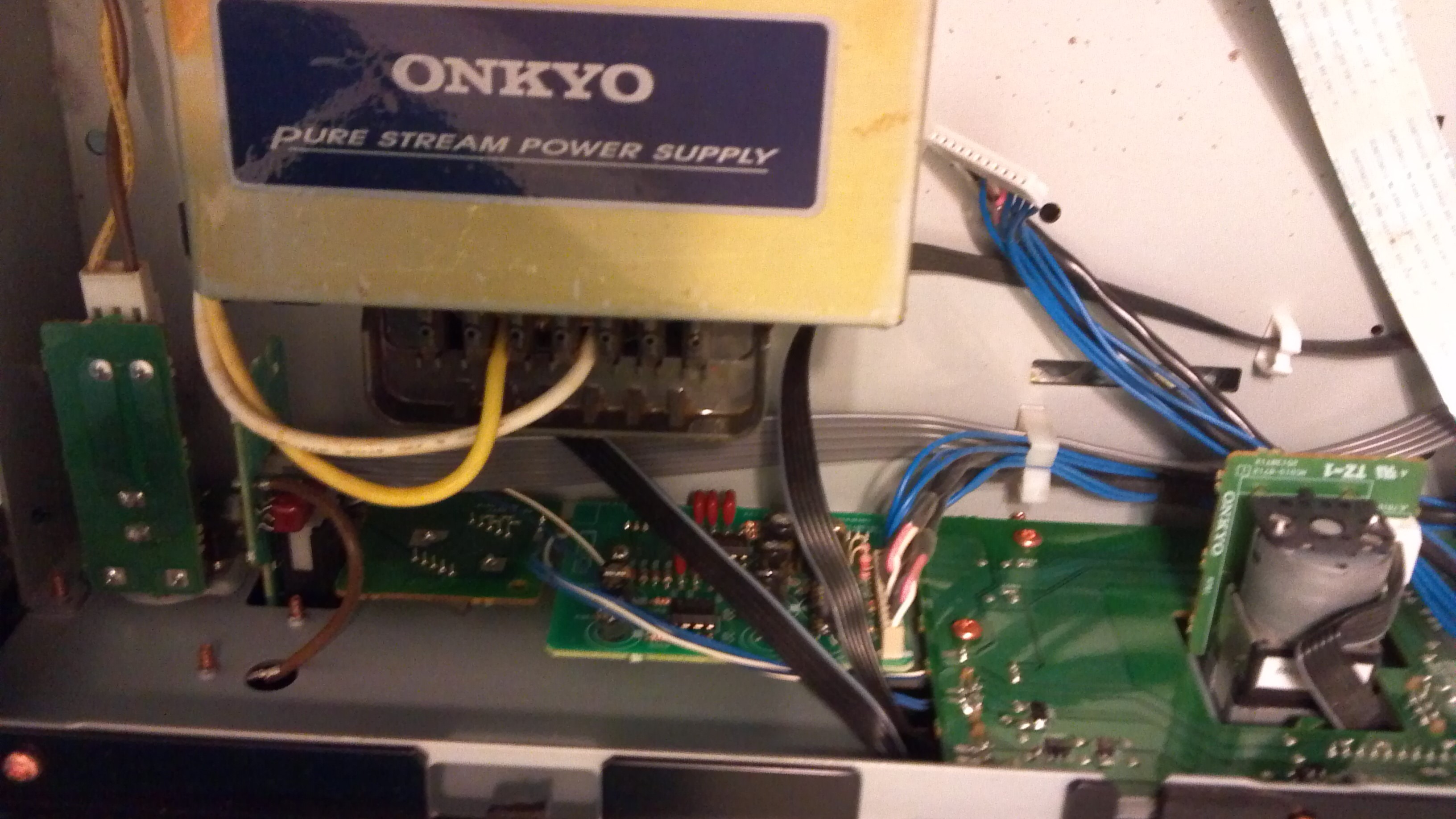

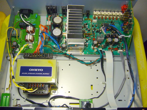

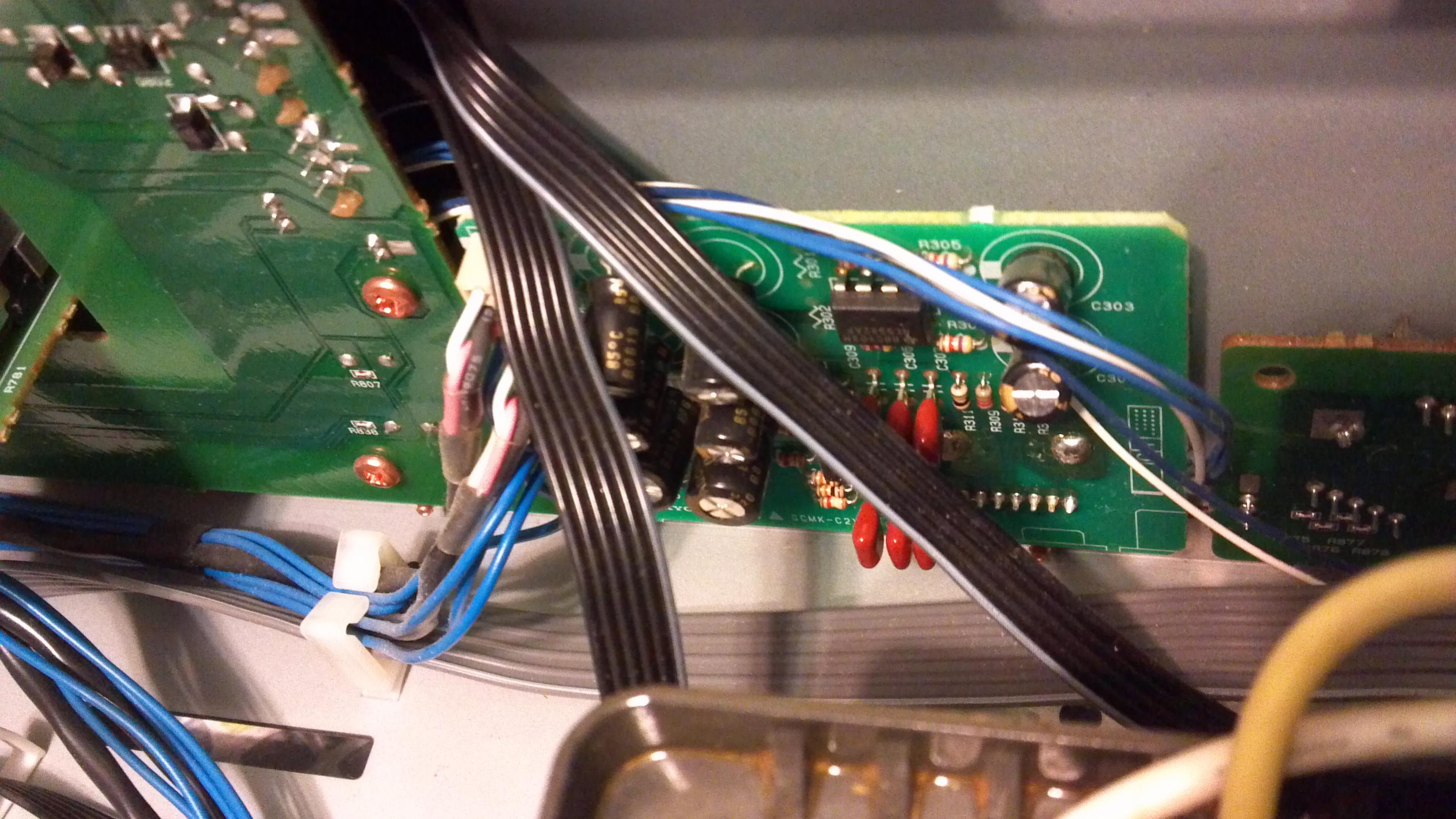

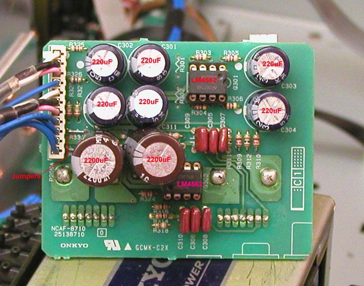

A look inside told the story. Op-amps were 5532’s, good but out of the eighties. There are four of these op-amps. Two in the tone control PCB, two more on the main PCB. One is for headphones so I didn’t do anything to that one. The other is in the middle of the power amp.
The first thing I did was to remove the IC’s from the tone control PCB and put in sockets. The IC’s were up-graded to LM4562’s. I first tried some OPA2132’s that I had on hand. They worked but showed there color. The 4562’s are much better in every way.

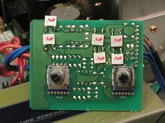

There are also eight capacitors to change on that PCB. The six 47uF coupling caps and were changed out for 220uF. Next, the two 470uF power filter caps were changed out for 2200uF/16V caps. There are two 33ohm resistors that I shorted with jumpers. This ties the caps closer to the power supply for more impact.

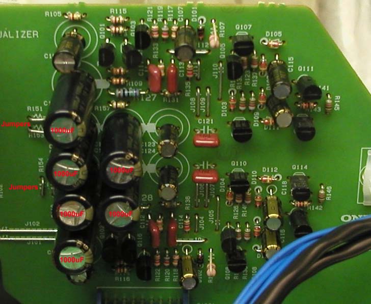

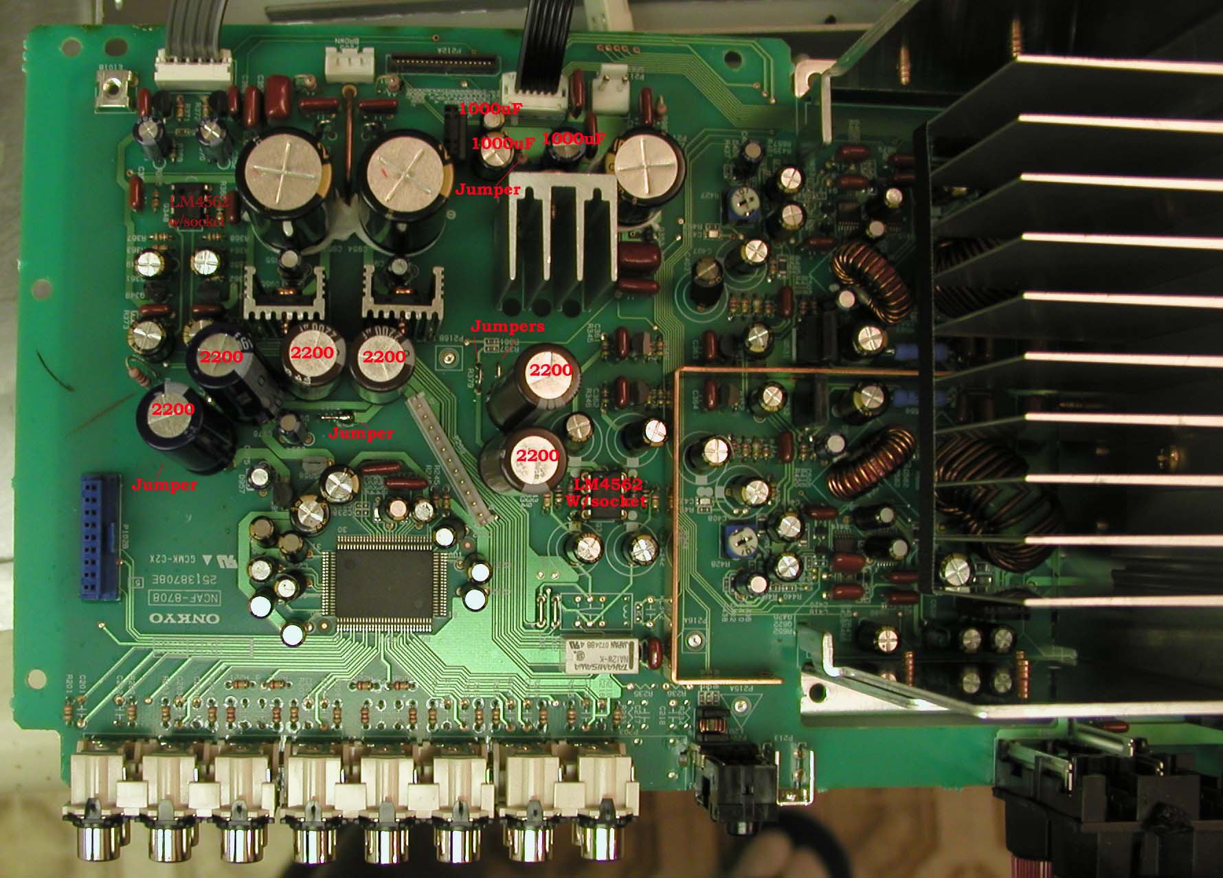

I don’t use the phono stage but decide to make use of it to help out the power supply rails. First, I jumpered out R’s 151, 152, 153, and 154 (33ohm) and then I changed out C’s 109, 110, 125, 126, 127, and 128 for 1000uF units.
On the main PCB there are 100pF caps at all input and output jacks. These are little red poly-prop caps. I clipped all of these right off the PCB, removing them all. They only dull the high end. These caps are numbered C201 to C216.
Last and most important, are the two pair of caps on the main PCB. These are C345-C346 and C975-C976. I could not un-solder them without taking the whole amp apart so, I clipped them off as CLOSE TO THE BODY as I could. This left me a little stub that I could solder the new cap leads to. It was very tight in there, so take great care not to melt anything else near by.

I have pictures for those that might want to try this for themselves. Good luck, bobwire.
Here's a pic:
