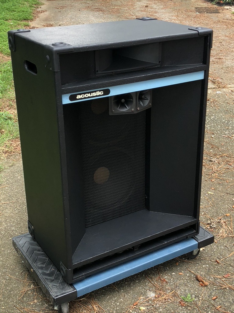

I've restored a couple of Acoustic 807 loudspeaker for use with keyboards:
The low end comes from a pair of 12" drivers mounted behind a not-exactly-Bessel-curve horn structure and the backs of those drivers communicate with the port at the bottom.
As you might expect, these cabinets don't have much to give you below ~120Hz and whereas I'm running them with a one-third-octave EQ in the signal path, I'm concerned about just trying to compensate with amp power. It has been suggested to me that one way to get roughly an extra octave of bass would be to push the two cabs side-by-side to increase the width of the aperture but I was wondering if perhaps there were another (small-a) acoustic approach.

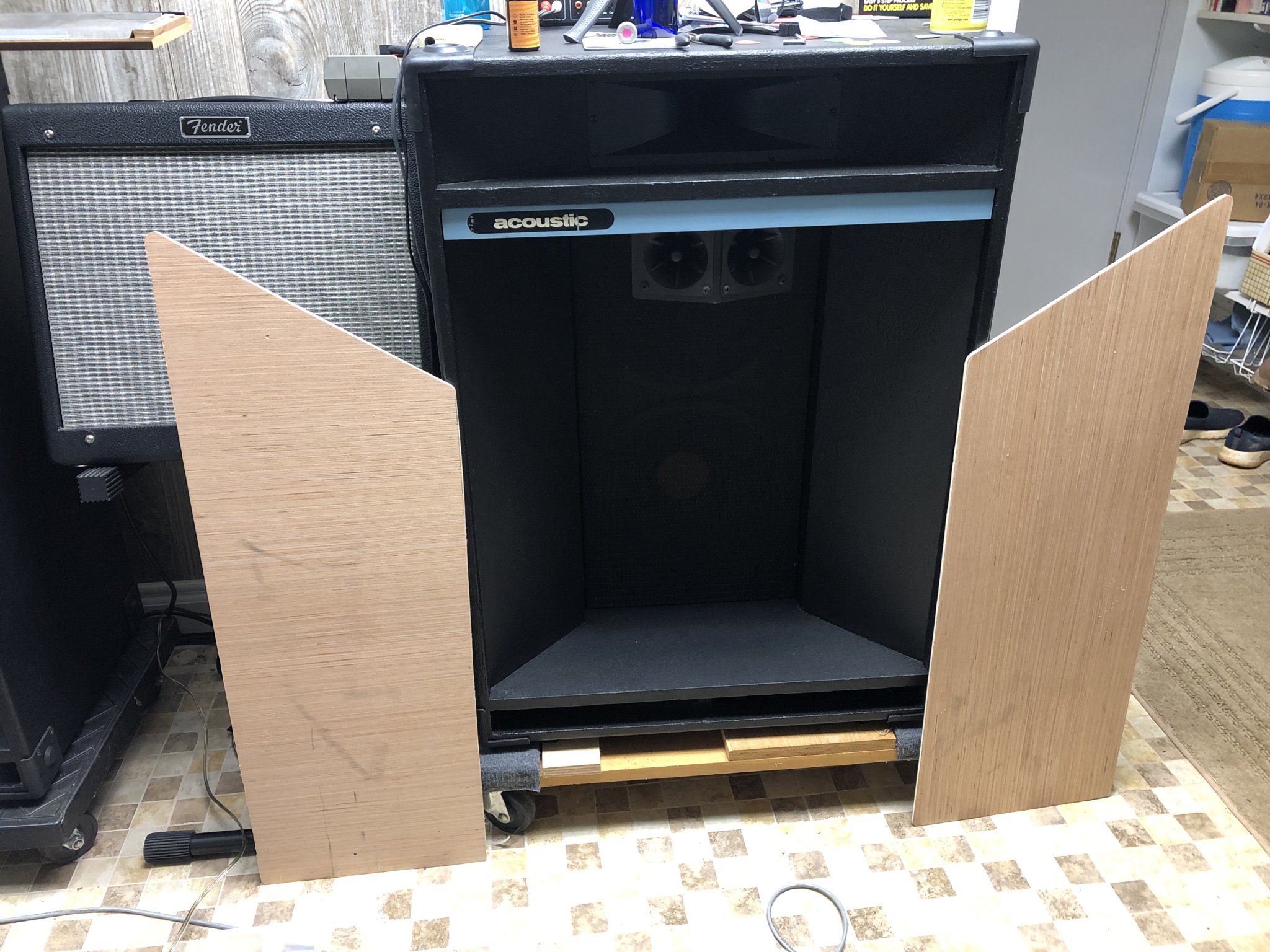

I've built a pair of potato-grade baffles to perform tests with.
I have a venue in mind - hopefully I can get permission to use it - to set up a measurement mic and run it into a spectrum analyzer app on my MacBook, then blow white noise through the speaker and see if adding the side baffles kicks up the low end any. I'll try them both in a plane with the open front of the cabinet and also canted in at an angle so they form more of an extension of the bass horn.
There's a church near here with a large, high-ceilinged, and carpeted fellowship hall that seems like it'd be a great place to run this experiment.

"Barn doors" won't extend the low end, but will increase the forward output a bit, your "potato-grade baffles" probably around 1.5 dB. Hardly enough to bother with, as they will increase the mid bass more than the bottom.
The big theater "barn doors" can give over 3dB increase- a big deal back when a 50 watt amp could now sound like 100 watts without power compression in the speakers.

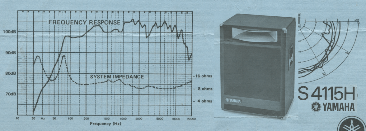

That said, cabinets of the era of your Acoustic don't have much response at Fb- if it's like the Yamaha 4415H, it will be around -15dB at Fb (the impedance and excursion minima). The speaker cones don't have enough excursion to allow anything near that kind of boost.
Speakers of that era usually had only about 2mm Xmax (linear excursion).
12" drivers capable of 40-1500Hz response with 6mm Xmax, and subwoofers with 30-160 Hz response with 12mm (or more) Xmax are common now.
Doubling Xmax allows an increase of 6dB, a 2x12" sub with long throw drivers about the size of one of your cabinets crossed at 100Hz could give you flat response to below 40Hz with enough output to keep up with the Acoustic at full tilt boogie.

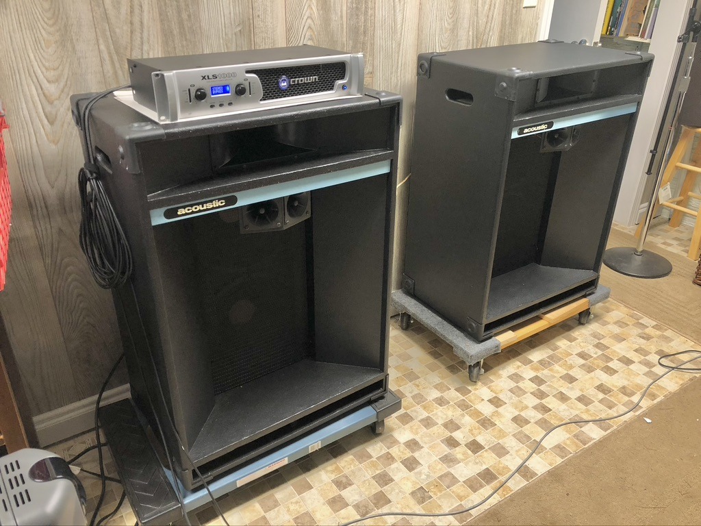

Okay, any of you naysayers who questioned the effectiveness of my "batwing" side baffles will be interested to know that I have finally run far-field tests with a measurement mic and REW and I am now prepared to report that the side baffles have absolutely no effect at all!!! None! It's like they didn't even exist!! I'm so glad I didn't paint them, do any more than glue and tape rigid cardboard angles to them as stands, or make a second pair, and now I've got more for the scrap wood collection!
Pushing the two cabinets together side-by-side, however, did produce a notable bass extension.
A volunteer at a nearby church let me drag all this stuff into their fellowship hall to make the measurements. I had hoped to use this particular hall because it was carpeted but in recent years they had replaced the carpet with tile and I was told that the room became so live that it was unbearable. They tacked drapes to the upper walls and hung a bunch of hospital room curtains from the lean-to ceiling to calm it down.
After using REW's sweep captures to set my 1/3-octave EQ, music blown through them at volume sounded quite good. And replacing those 12"s with modern drivers with much more Xmax made a huge difference. I still need to establish the Fb so I can EQ down everything below that to conserve amp power and preserve voice coils.
With music program the 807s were plenty loud from across the room with the Crown XLS1000 mostly running about 20dB down. I feel like I could run a better (if heavier) amp at considerably less power for my purposes if I wanted.

After seeing almost identical spectra with the side baffles as without, whether they were set flat across the face of the cabinet or swung inward to more or less match the angle of the bass horn surfaces, I didn't bother calculating anything. I think that when the two cabs are pushed together, it isn't so much that you're doubling the area as doubling the width of the aperture - both the bass horn section and the bottom slot port. So depending on what my setup circumstances are when taking the keyboards out, I can push the cabs together and have more fun "stomping" the Moog Taurus pedal plugin or spread the cabs out for room-filling and stereo imaging purposes.
