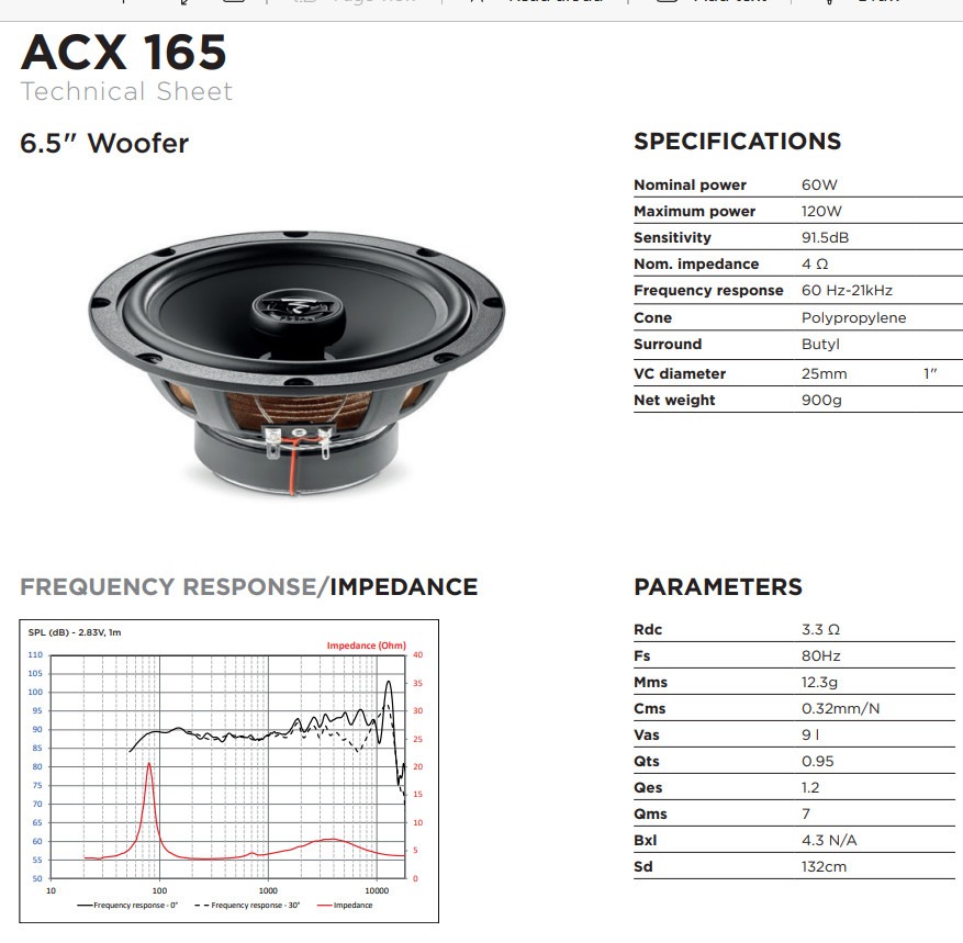

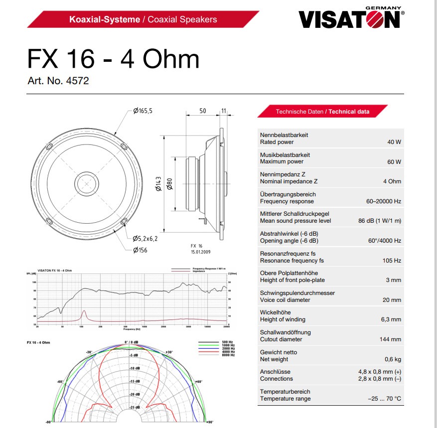

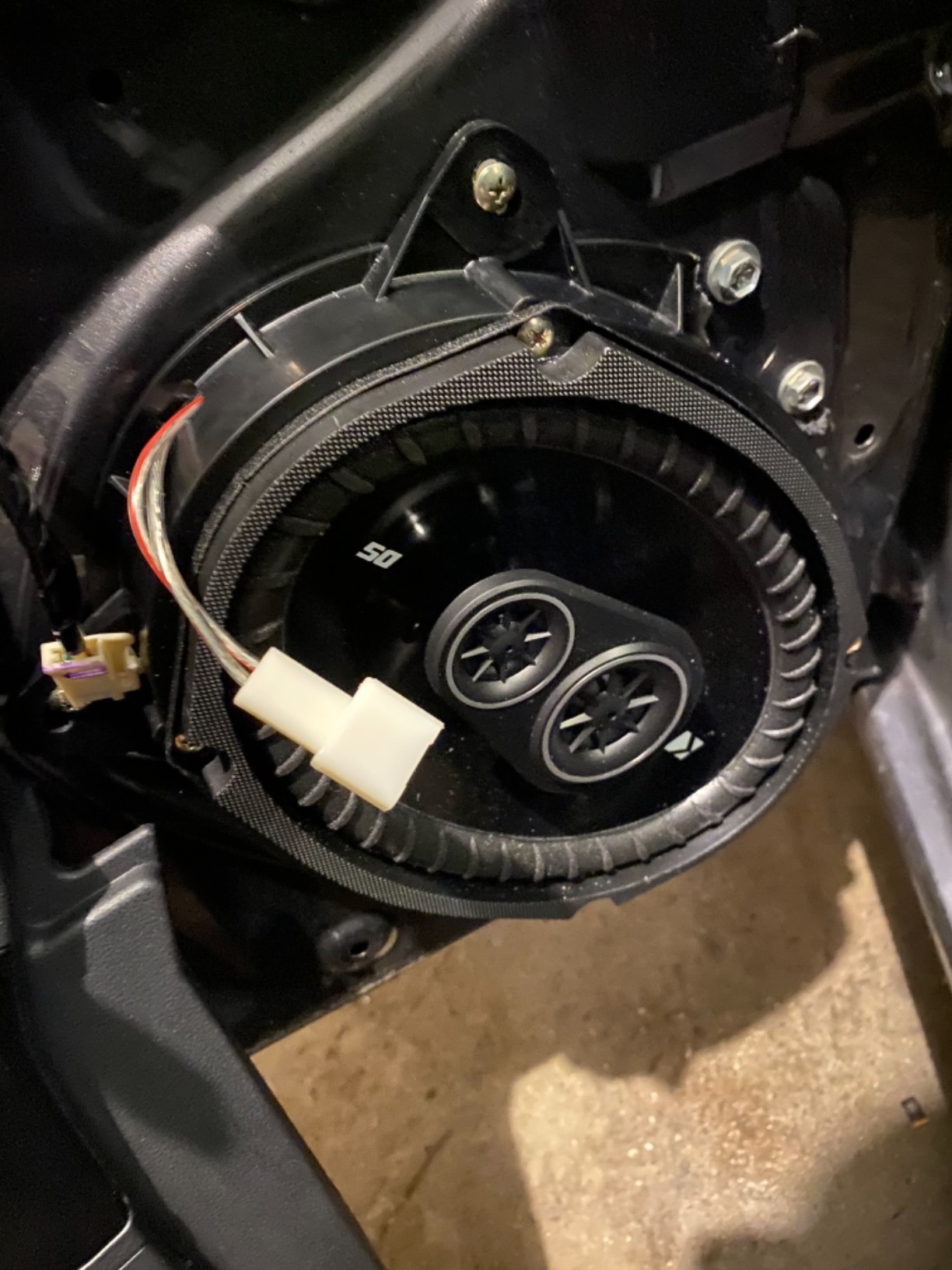

Uh, you might be willing to do "low effort"...but you're talking about miniDSP etc? 😆 If you're gonna do that then do try to damp the door.OK, thanks everyone for your suggestions, this thread has a gone a bit off the rails! Again, I'm just looking to put some off the shelf speakers in the stock mounting location. No component systems, no custom MDF kick panels, etc. Ideally, that would mean finding some drivers with good TS parameters for bass alignment (whatever that may be) and some good half-space measurements, preferably spinorama style. With more time available I would be vetting/measuring the speakers in half-space before installing in the car and then using a minidsp to make in-situ adjustments. RAAM, thanks for the suggestion on the damping material. I might be willing to put some dynamat type material on the inner door panel since it would be low effort. I am hesitant to put damping material in the cavity (eg glass batt) since it would retain moisture.
- Door cavities are complex, likely not a simple volume but various resonators stuck together, hence TS parameters not too valid except as a general guide. Low resonance and low Q
- Inquiring minds still want to know what year and trim level this Subaru Outback is

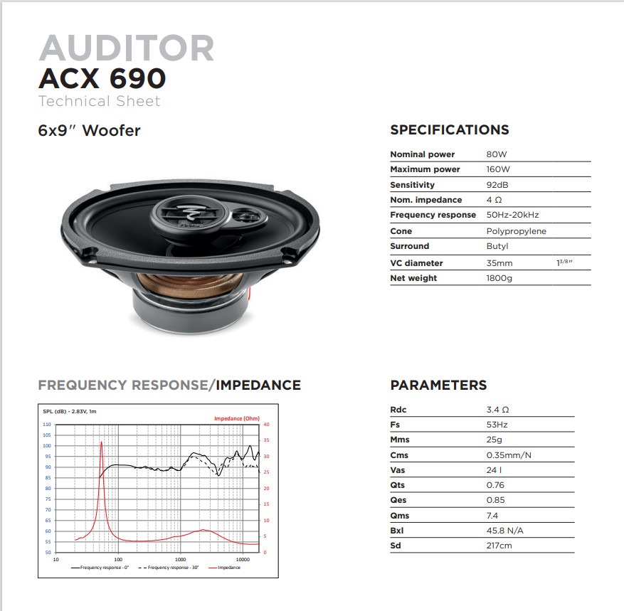

- And are the 6x9s in the doors? (That's unusual, but it does happen)
- Components sets will be way better, by virtue of having the tweeter aimable, and a vastly better crossover at least for upper models. You could almost buy according to how complex the crossover looks.
- Results will be comparable to effort, eh?
- Never seen a spinorama for a 6x9, not that I've been looking exhaustively. Please send whatever you decide on to Amir at https://www.audiosciencereview.com to start a trend! And even good upper frequency dispersion won't be good if aimed at your leg 😉

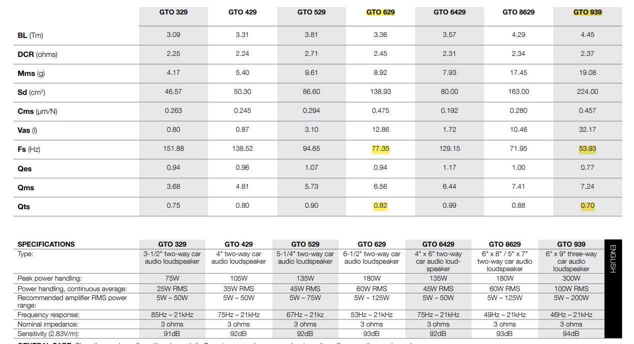

As for the JBL GTO 939 my buddy worked on that, though maybe a previous generation. Funny marketing silliness at https://ca.jbl.com/GTO939_.html (heat sink fins molded around the magnet, but they tout it is carbon, which conducts heat LESS well; somehow the non-magnetic carbon is supposed to direct more magnetic energy...ah takes me back to my days as a marketing *****, such fun). I don't see any crossover box, so it must be a cheapie capacitor behind the tweeters. Hopefully they work well enough for ya!
