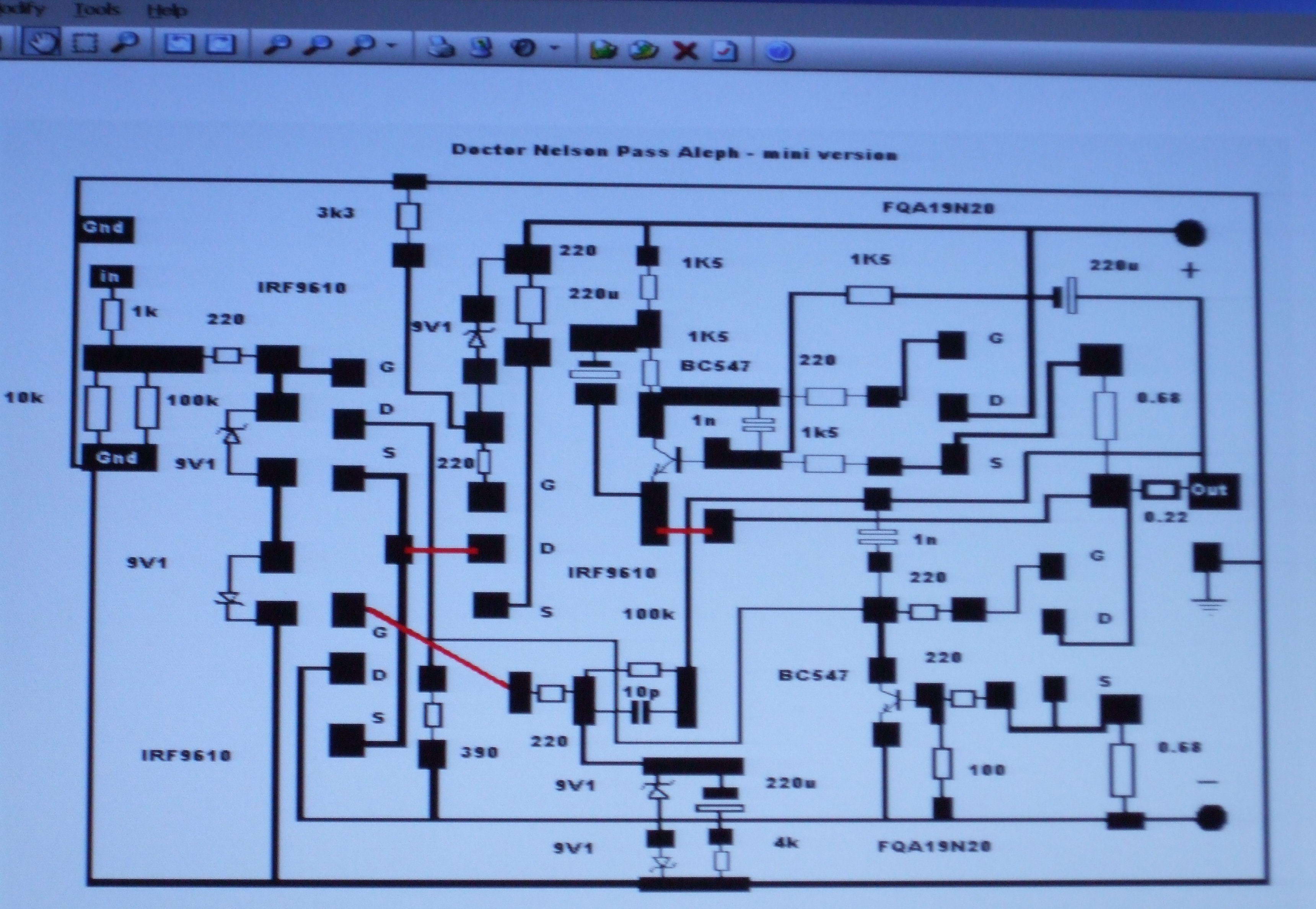

No, i have not.... but i will build this one, just to listen
I will not evaluate... will not publish what i think...just to have fun.
regards,
Carlos

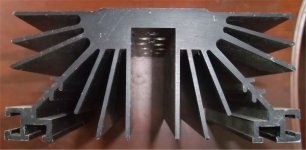

That sounds good - I've already got one project on hold because the heat sink is too small. I am going to attempt to make a larger one.
R23, R20, C5 - these are for stability ? - if so, I suspect that you only C5 and I'd put it between the base of Q15 and Q16.
Shame about the heatsink, if you were in the UK i'm sure i could help you out in that department 😉
The resistors mentioned & the capacitor aren't for stability no. If you look at any Pass Aleph amplifier & analyze what they do it'll all become very clear. Basicly the resistors on the power transistor emitter resistor on the negative rail set the absolute current limit. The network you brought to attention sets the quiescent current of the output stage. The capacitor & R20 simply allow the AC output current to start turning off Q15 thus allowing more current to flow under AC signal conditions.

I cannot Bigun..when i to to the forum and i use to say the Blame can beat
almost all amplifiers.... then i have to be sure about...this one i have never listened..so..i want to check the performance.
Will not post... will not bother NP...he do not deserve..he is good...friendly..he helps... will listen and evaluate to myself..then will dismount the hell thing (hell because hot!)
I really dislike... several days watching the schematic and never moving myself to hold the soldering iron...will make it forced...almost because i need to know how this one performs (by myself and to myself only..will not publish results)... usually i start to prepare board and hours after the amplifier is playing..this one i have not even started.... resistance is the name..i really have enormous resistance to class A.

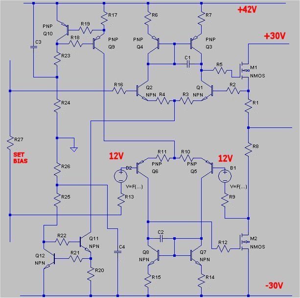

Hi Carlos, take it easy fella 😀 Honestly there really isn't a lot of a relationship between the circuit diagram i posted & a Pass amp. Only the operation of the output stage, but not the type of devices is similar. The front end is also totally different as you can see 😉
The only common denominator is the way the output stage works, there will be no mosfets & no mosfet LTP driving a resistor. This front end has a current mirror & emitter follower with a current sink as a load, you really couldn't get much different.
By the way, this doesn't have to be biased right into class A operation. Though it'd be more linear with an amp or two (or more) of quiescent current the low frequency gain of the front end is a heck of a lot higher than a Mr Pass LTP using mosfets. Normally i'm not that keen on a lot of open loop gain, however i thought i'd give this a go as i just want to see how it performs as i prefer transitor outputs to mosfet.

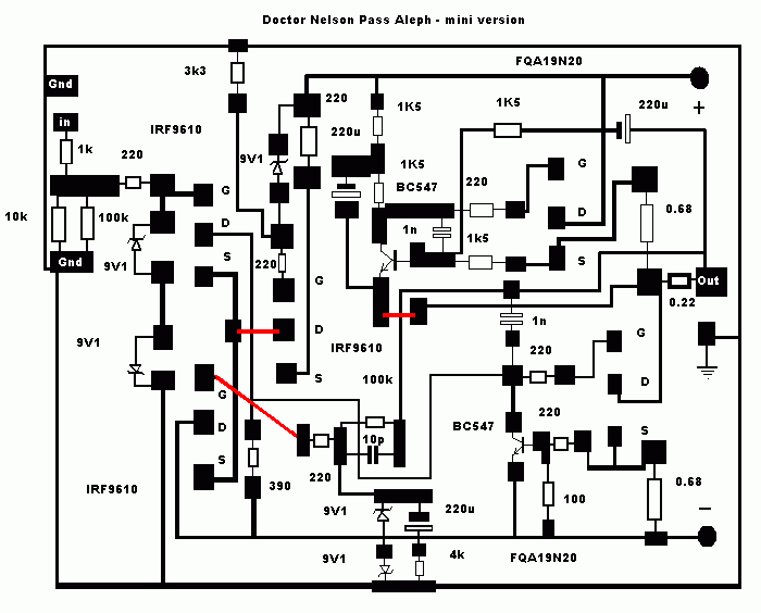

Well I have quite a few schematics, from simple to more complex. I've posted below one of the simple ones because it's the basis for all the variants. The basic idea is a CFP stage on the bottom with SRPP on the top.
I like BJT instead of MOSFET and the CFP offers good linearity as well as increasing the input impedance. In Class A it never turns off so this helps with some of the stability concerns that taint this choice of topology.
This simple version has no error amplifier because I want to understand how it behaves without one. Adding a single PNP will give me an error amplifier fairly easily. In the meantime, lots of degeneration to keep gain under control. The pcb is a square shape, two bolt-through power devices and everything else on top allowing me to make the simple version and the variants. I haven't committed to making the pcb (at home of course) yet.
It's not too exciting to look at yet.
