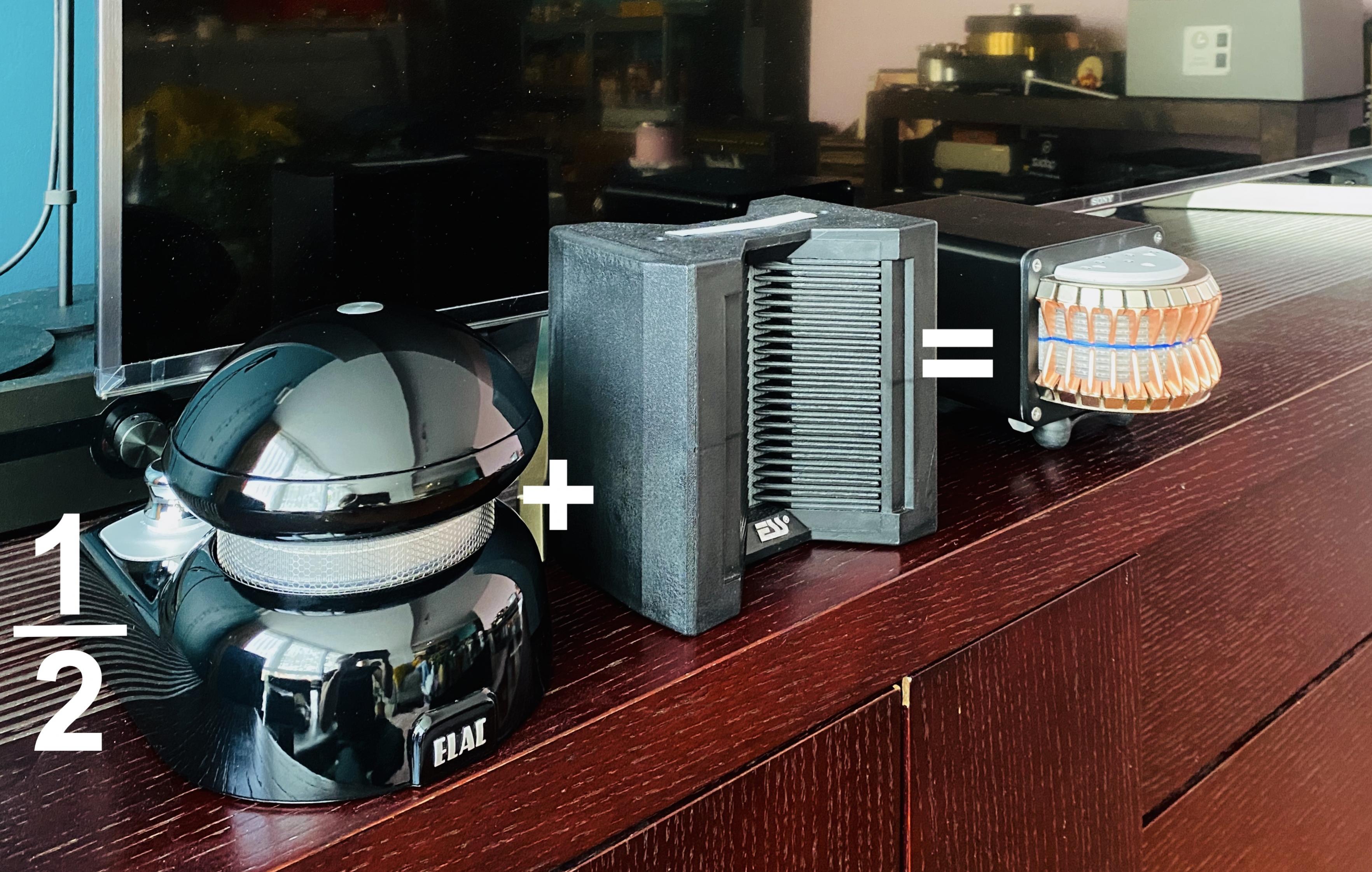

1/2 Elac + ESS = AirBlade
to put it in audio terms ... ;)
