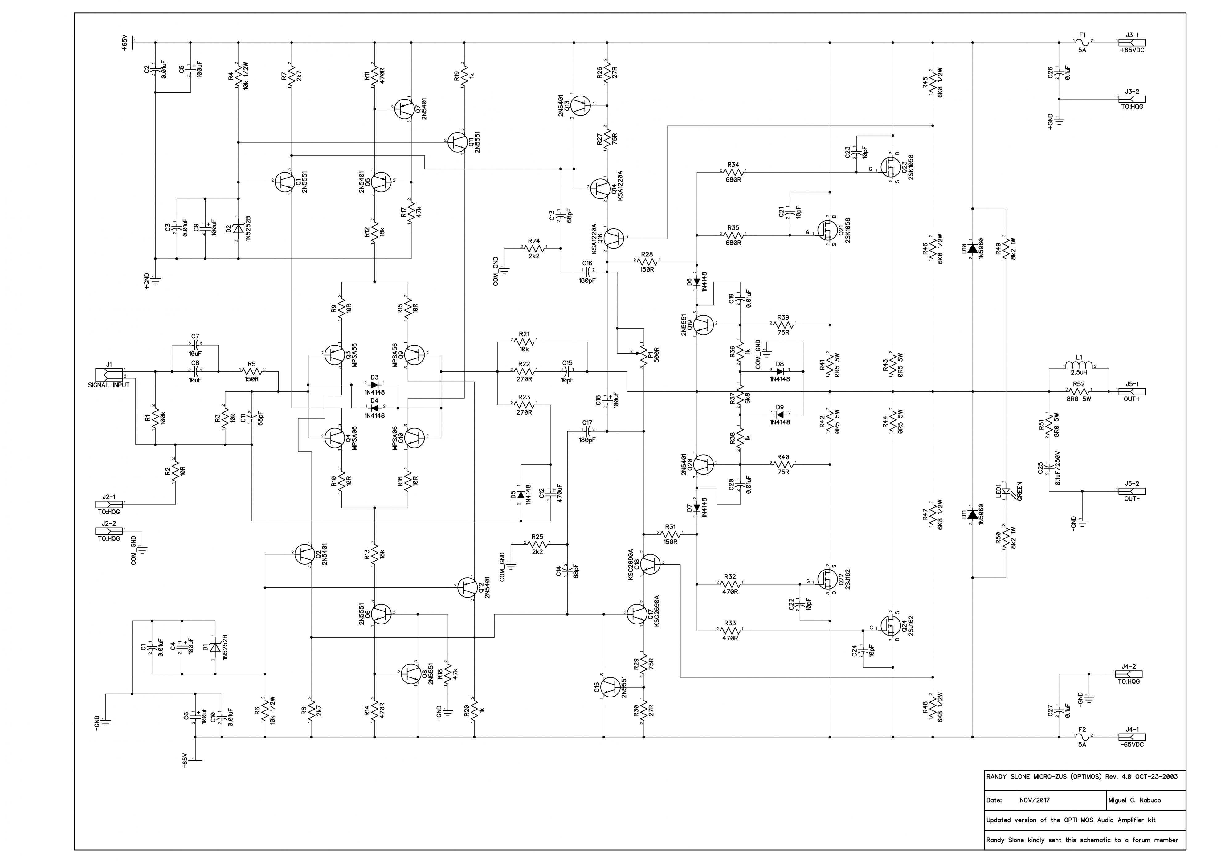

Here's the image for quick view, see the bigger sized one in the post above.
Revision 4 OPTI-MOS units
Designer: G. Randy Slone, SEAL Electronics, http://www.sealelectronics.com

optimos rev4.0
is this schematic correct?because the capacitor c4,c24 and c23 have polarity
because right now im doing the pcb foil pattern for this schematic?
just add mosfet and make it 6 pairs and increase the voltage up to 85 volts dc.i have already tried it.you just need to increase the size of the of your heatsink.and for sure use 1/2 watts resistor. Randy use 1/4 watts as much as possible because he doesnt want to use bulky resistor if he cannot avoid it he makes it in series connection.my optimos is from the audiophile project sourcebook and not the version 4.also put heatsink on pre driver transistor

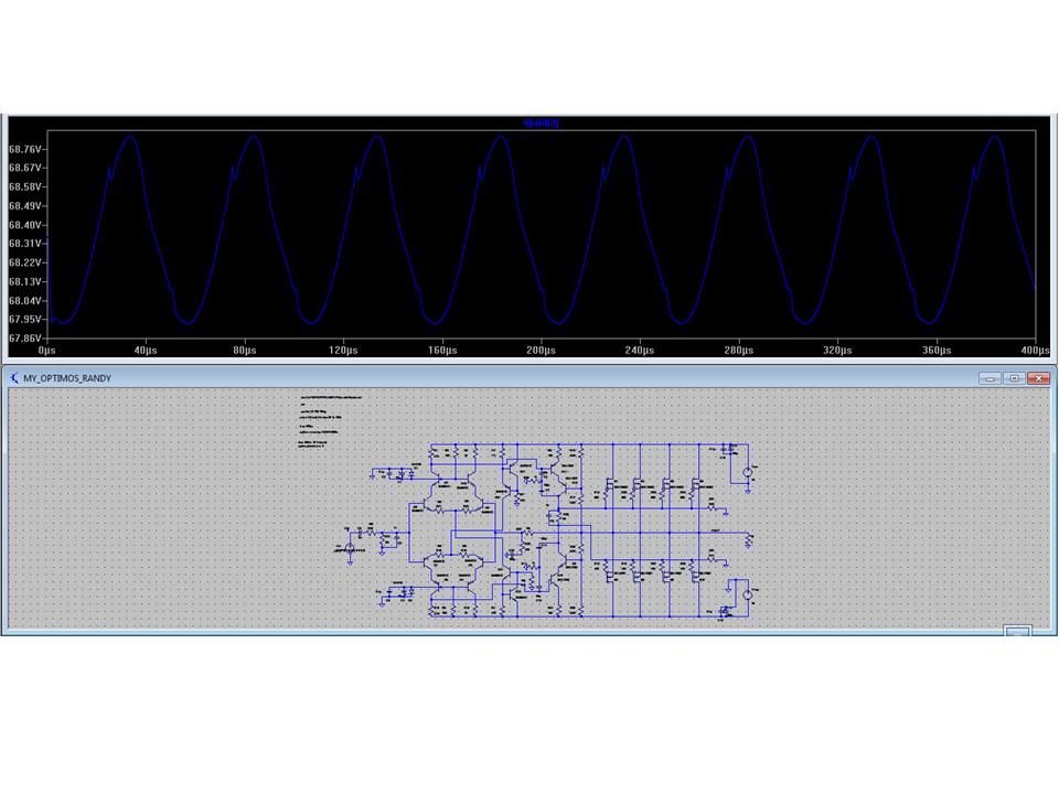

Although i'm a newbie in simulation, i thought i'll make an attempt on Optimos. Recently, i got Bob's book on amp design and started following the tutorials on spice simulation. Optimos performed well in 20k transient sims, square wave tests etc., as expected. However when i probed the VAS input for current and voltage, the waveform looks out of place.
Similar waveform appeared, while probing inverted input for current, but waveform for voltage looks good.
Is this behaviour normal or else do i miss something....
can you throw some light on this...?

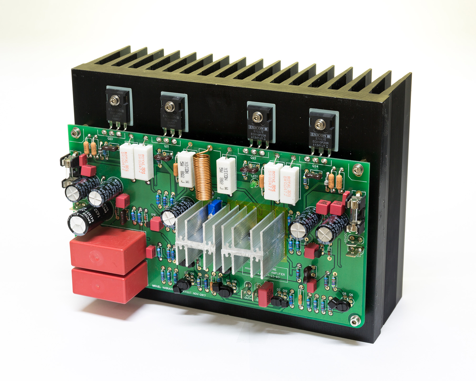

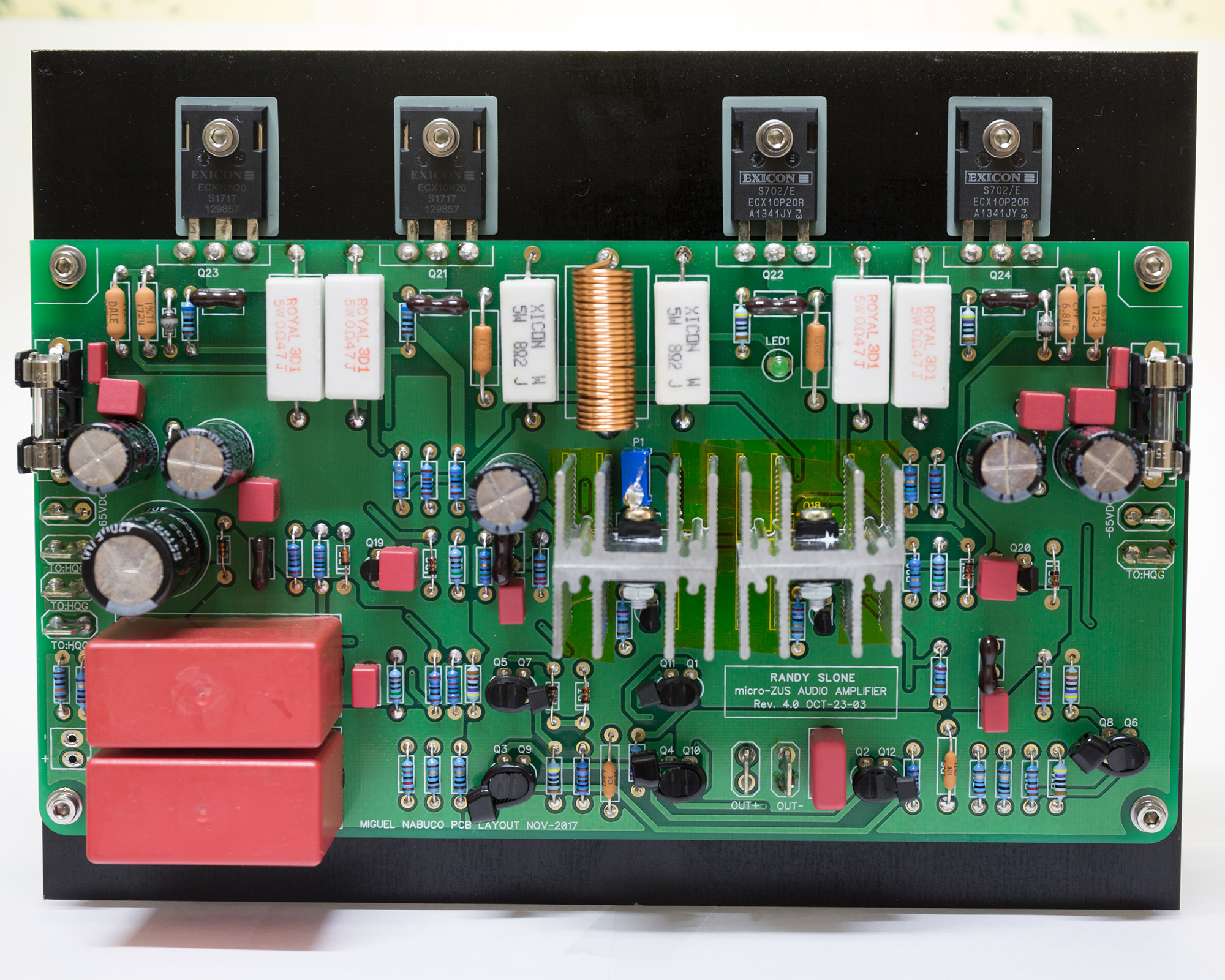

Hello everyone,
I know this is an old thread, but I wanted to share my experience with you.
I have recently built the Revision 4 OPTI-MOS amplifier by Randy Slone, as posted by lucpes. Here it is:
The Schematic:
I made a few small changes:
1. I replaced the tantalum input caps for MKPs;
2. As I couldn`t find a reliable source for the K1058/J162 output transistors, I used the EXICON ECX10N20/ECX10P20R, which have similar specs and are still manufactured nowadays.
I designed the PCBs myself, and it ended up big. The size is 210 x 110 mm. It is double sided, 2 oz Cu, 2mm thick. I ordered the PCBs from a chinese manufacturer. The gerbers are attached, and you are allowed to produce PCBs for non comercial use.
Gerbers: View attachment Revision 4 OPTI-MOS Gerbers.zip
This amplifier really surprised me. It is a solid amp, and sounds really great! I measured 175W RMS per channel using 1kHz sine wave and 8 ohms dummy load.
I am still to perform frequency response and THD tests, and I will get back with the results.

Can you share PDF files ?
Thanks...
Hello. The PDF files are attached. Just remember that all holes are plated.
View attachment Slone_PCB_Pdf.zip
