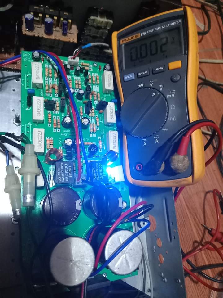

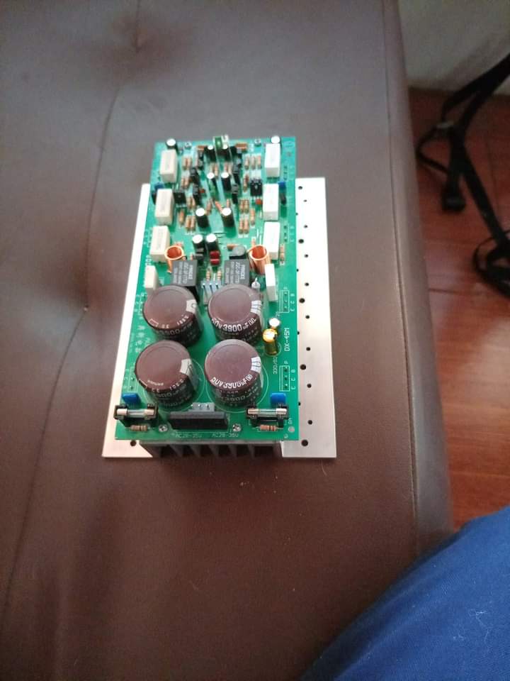

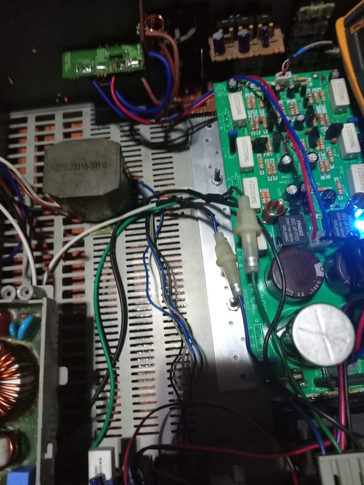

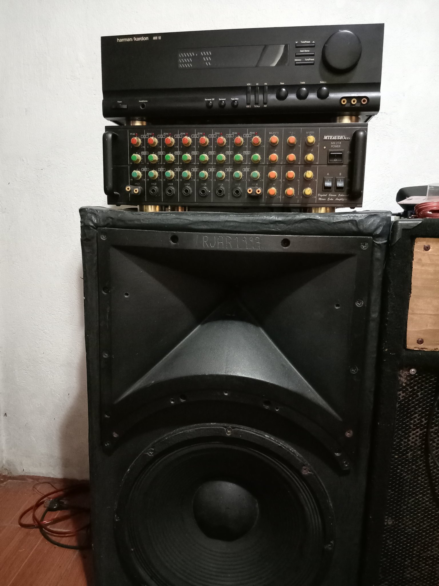

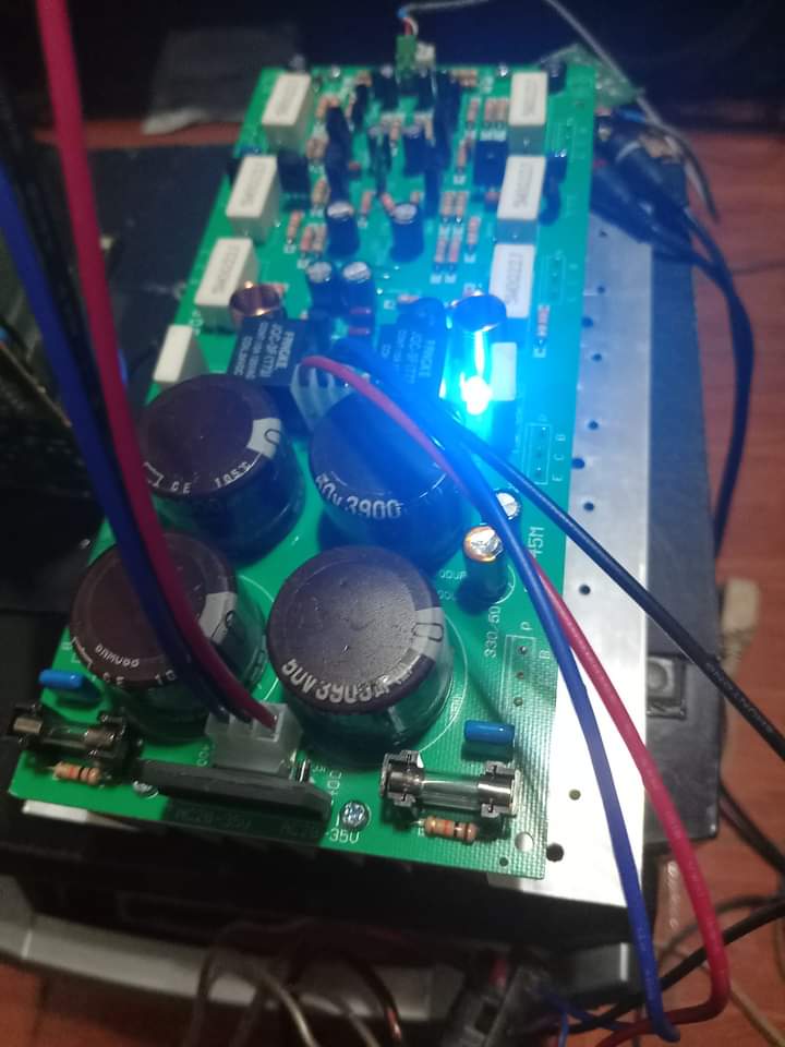

I recently created a sound plant with this module, the transformer is from a Sony hcd-gt444 gives 40 or 40v at its output at more than 8 amps which is enough for the module, currently I have it configured for mono in its jumpers, the truth is that it is quite powerful, it moves two 15-inch speakers without any problem, including a Peavey Black Widow and also the 2 tweeters belonging to each speaker, honestly the investment is worth it, I personally recommend it, but you have to use forced ventilation, hopefully turbo fans because without these it heats like hell 🤣🤣 The one I currently have uses Sanken 2SA1494 and 2sc3858 transistors, the box I made it with is from a Harmann Kardon, anyone would believe that it is a vintage equipment and that it would burn when trying to move the 2 15-inch speakers but what they don't know is the monstrosity that is inside that box 🤣🤣 Greetings from Costa Rica and I recommend the module with my eyes closed, it is quite good, the truth is that

El amplificador obviamente es clase AB, los electrolíticos son de 50v a 3900 uF, los drivers son el h649a y el h669a, utiliza un puente rectificador de 20 amperios, he intentado buscar el diagrama en Internet pero no hay información al respecto, utiliza una placa rectificadora redonda de 1 amperio en el protector de altavoces, creo, el par diferencial está formado por transistores 2n5551, los fusibles son de 8 amperios, las resistencias cerámicas son de 5 vatios a 0,22 ohmios y utiliza 2 zener de 24v, incluye una red zobel y eso sería prácticamente todo el sistema, el bias está regulado en torno a los 351 mv, esa es toda la información que os puedo dar del modulo DX-45M.

The amplifier is obviously class AB, the electrolytics are 50v at 3900 uF, the drivers are the h649a and the h669a, it uses a 20 amp bridge rectifier, I have tried to find the diagram on the Internet but there is no information about it, it uses a 1 amp round rectifier plate in the speaker protector I think, the differential pair is made up of 2n5551 transistors, the fuses are 8 amps, the ceramic resistors are 5 watts at 0.22 ohms and it uses 2 24v zeners, it includes a zobel network and that would be practically the entire system, the bias is regulated around 351 mv, that is all the information I can give you about the DX-45M module.
