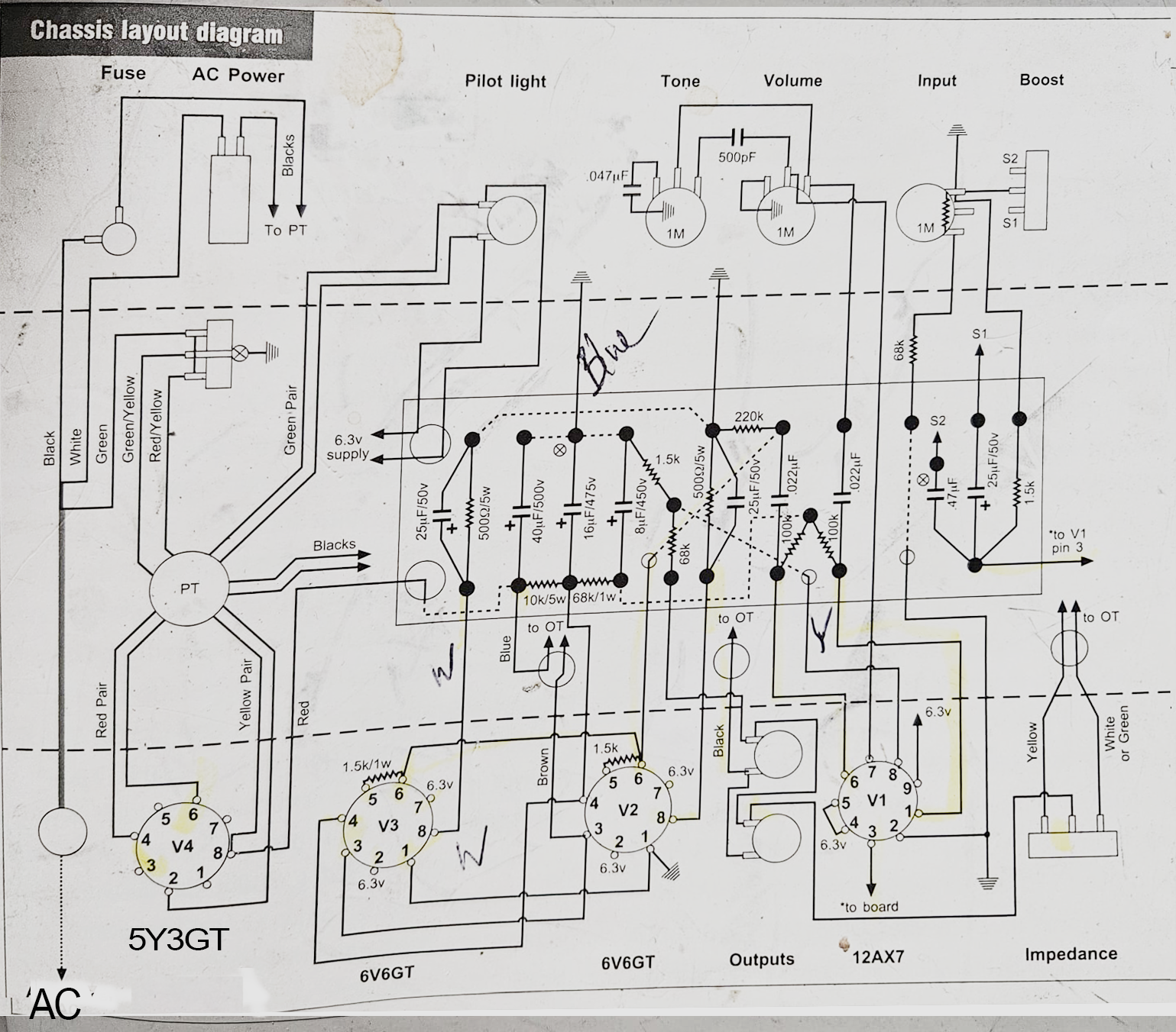

Lately, I'm convinced that the old Fender 5e3 6V6 p-p circuit - ID'd briefly as the one with the 4 High / Low inputs in this thread, is about the best you're going to do when building a replica. The same circuit could be enhanced with spring reverb (an effect mix) and / or a Tremolo (an effect). I heard Neil Young uses one, with a servo controlled knob rotator attached to it, custom built by his guitar tech. He can make changes to the tone of that one amp to stored presets with the tap of a footswitch.
I guess if I were setting out to build or design a guitar amp, that's the dimension I'd want to work in. Put new tech on top of the old, to do thing you couldnt do, say, in the 50s / 60s. Not should this 68k resistor be 22k in this stage kinda stuff. Wring out all the tonal versatility some old circuit design can do in all the dimensions, make it usable in a musical way to the player. Like turn your volume knob 1/4 turn and the tone changes, loudness remains the same.

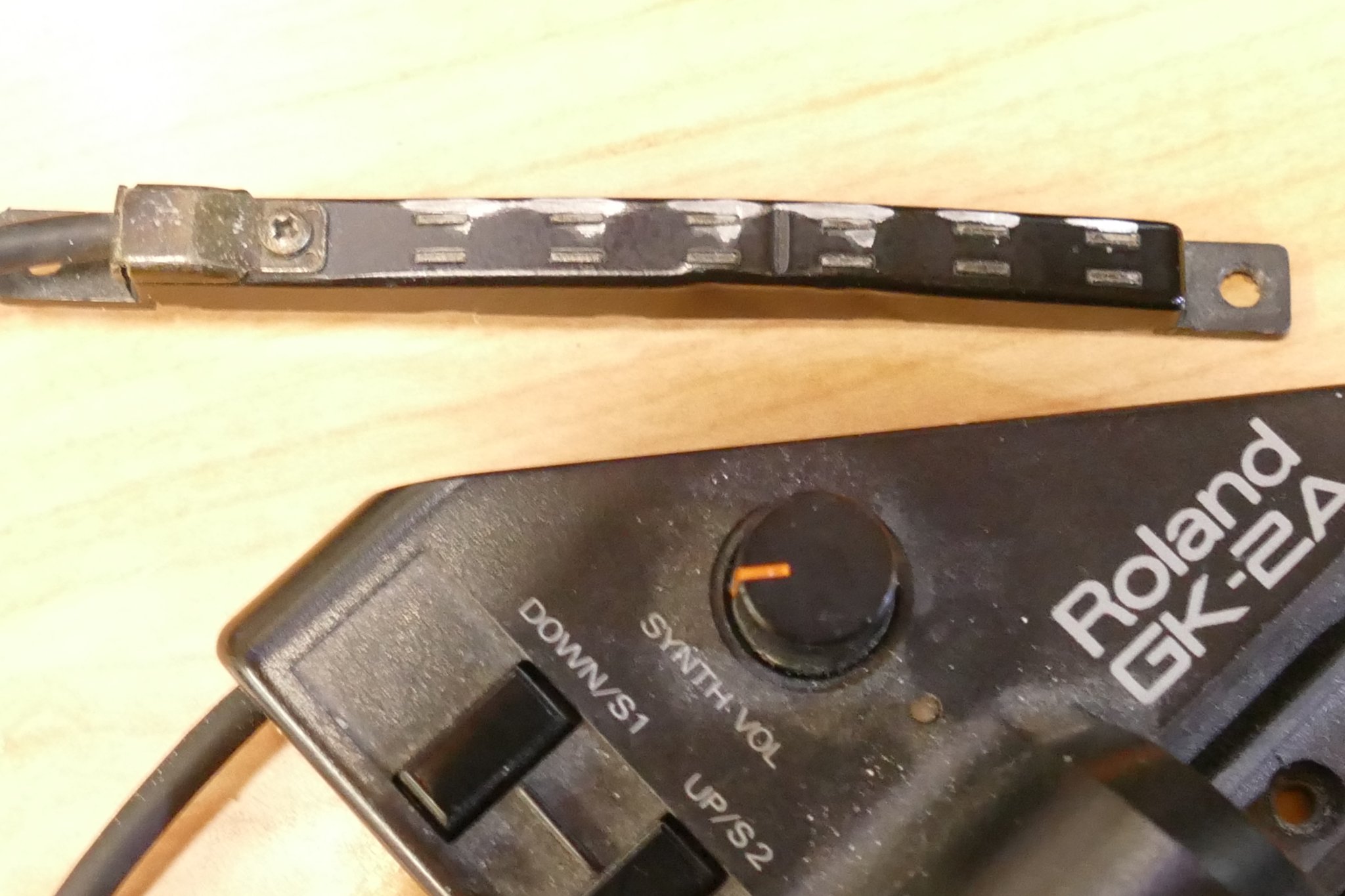

I have toyed with Hex pickups off and on for 30 years or more. I bought a used Roland GI-10 Guitar to MIDI interface on Ebay back in the late 90's. It used the Roland GK-2 hex pickup which I stuck to my Univox Mosrite clone with double stick tape. It took quite a bit of learning and practice to get useful sound out of it, and I eventually lost interest. It's still in a box around here somewhere, and I will play with it some more once I find it. The pickup was still on the guitar (now separated) but the funky 13 pin cable is MIA.
I have experimented with commercial and DIY hex pickups and DIY PLL based tracking systems with limited success. Despite all of the DSP magic available today accurate tracking of a musical note based on a single electrical audio tone is limited by physics. Assuming accurate ability to time and measure the zero crossings, the period of a low "E" note (82.4 Hz) is about 12 mS grabbing a reliable time measurement from a non sinusoidal guitar note in a single cycle is tricky, and the note needs to be clean. There will be at least a 12 mS delay on the low E if you can calculate the not frequency in a single cycle.
Looking back at my early experiments, fret buzz and lousy technique is what killed those experiments. The GK-2 pickup has a rather low output with limited harmonic content, which required much experimentation with placement, which was obviously a bit too close to the strings. The GI-10 had a noticeable delay and a propensity for random octave jumps as the note died out. It did do some neat FX with a DIY fade pedal that morphed between a guitar controlled JV-880 and the clean tone from the regular guitar pickups.

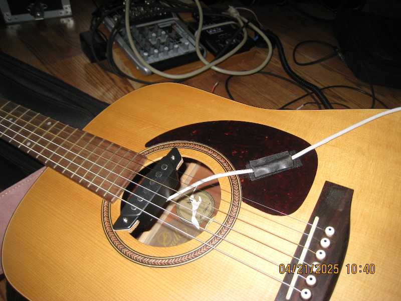

As I've read in the past here, you've done a lot more experimenting than me. Recently I built a "hex" pickup using electret microphones. The reason for doing so is I play mostly nylon string guitars. I've got sick and tired of the same 'ol, same 'ol "piezo" bridge sound and my experiments using an electromagnetic pickup on the guitar's sound board is "sometimes, depends on the guitar" at best. Turns out the sound you can pickup from some location on the back of the soundboard hardly represents what the whole soundboard makes acoustically.
The six electret mics are wired sequentially out of phase. For far fields sounds, they cancel each other. For nearfield sounds - like a string vibrating right over the top of one, they pick up. Apparently these things have the dynamic range to handle the physical situation I put them in. Too lazy to do an op-amp based preamp, I simply used a 10k:10k center tapped transformer to do the inversion and mixing, with a current limiting resistor on the center tap to power the six mics. The transformer is small, doesnt have great low end - but when you load it at 50K or 100k, that aspects gets better and to my ears, good enough.
It's been tried at maybe 6-8 performances now, never feeds back and makes a sound that literally no one else has. I've got it on an instrument with the "silk / steel" setup, where the three high strings are steel, the three low are from a nylon set. It's not perfect and if the sound guy puts too much treble on the channel, it can make an "ultrasonic" feedback. I doubt it would work at "lead" gains, like a solidbody electric. But what acoustic guitar does? I just bring my own mixer / board for EQ and compression, and hand the sound guy the XLR receiving end of a wireless.
Ideally I'd build an op-amp board with six levels, six passbands for each string and 3 channels inverted before mixing into the output. I got a pair of Chinese electret mic preamp boards, with compressor chips following the mic preamp. Next step will probably be putting those in front of the transformer; no way am I going to re-arrange the tiny SMD components to make one invert the signal. Guess whoever designed it didnt figure anyone would want to do that. Its also intuitive that the two compression parts may be better assigned low strings / high strings than every other string. That's a new pickup build, to wire it like that. Fantasy is 6 of these boards; one compressor per string. By the time I get around to that, tariffs will be 350%...
