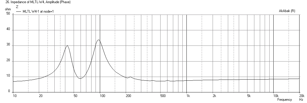

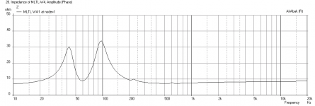

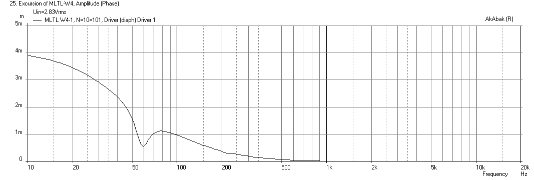

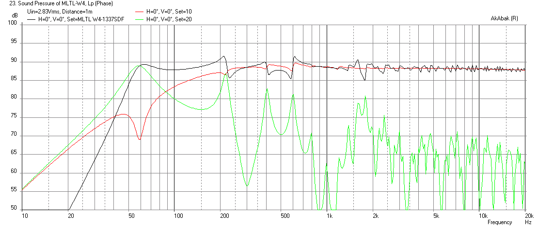

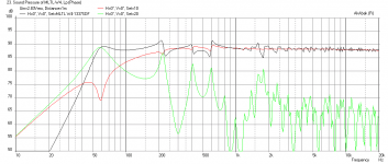

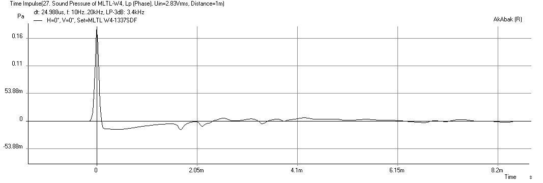

MLTL design for W4-1337SDF
Here is what I came up with that will have reasonable extension down to about 55Hz with good efficiency.
All dimensions are internal: 5.0in wide x 4.25in deep x 34in tall, 2.0in dia x 3.5in long round vent located 3.0in from bottom, driver located 1/3 of distance from top (11.3in). Put stuffing in upper 1/3rd and line 2 walls from 1/3rd to bottom with felt or fiberglass. Do not block vent. Put thick layer of felt in area directly behind driver and to side of driver to prevent back reflections. Looks like it should be a decent performer. Data includes a 0.40mH+2R+0.47uF all in parallel but in series before the positive terminal of driver for BSC. Skip if you plan on EQ.
SPL vs Freq:
Cone Displacement:
Impedance:
Impulse Response:
