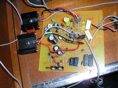

Hello RAHUL,
I will be drawing my Amp Diagram that is using the MJE13005's in the next week or so and will post it on this forum.
It's isn't the lastest design and most would say it's a bit out of date, but I like it.
It a mixture of the "Simple Current F/B Amp" On the "Elliot Sound Products" site. Basically I am using the Fig 2 circuit ( +, 0volts and - power supply ) with the Fig 1 output stage being 2 NPN Transistors in a Quasi-complimentary layout.
It's simply, gives me about 45W RMS and can be fixed quickly if anything goes wrong. One thing I have noticed is that if the output transistors overheat or the speaker output is shorted and the output transistors let go, the driver Transistors also burn out.

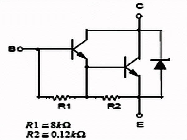

BU508
I've been using MJE13005 for a long time. It sounds good for me. Now I'm turning into TV Horizontal Output Transistors...! They are easy to find.
Is there anything wrong with using a BU508 in the AF amp output stage..?
