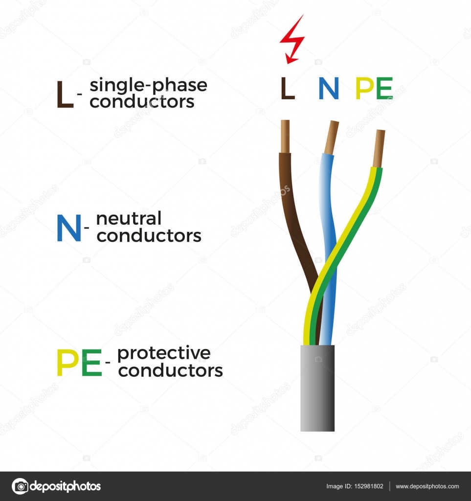

The electrical committees agreed on these terms and abbreviations for Line, Neutral and Protective Earth. This to avoid confusion with common, ground, earth etc. Ground as in GND is at the secondary side of transformers/power supplies and it is not necessarily connected to PE. PE is the thingie for safety and in its apparent simplicity often misunderstood together with its companions the ground fault circuit interrupter and the good old fuse (senior but still going strong).
The complexity is hidden in simplicity.
