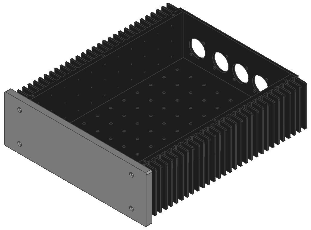

In case you are planning to design a typical audio amplifier chassis made of extruded aluminum radiators and plain aluminum sheets as walls, designing this using FreeCAD is fairly easy to learn because you don't need to learn many features of the software.
Here is an example (designed using FreeCAD):

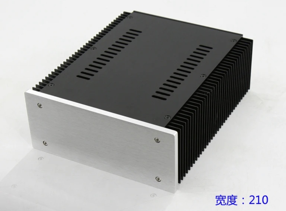

Above you see the bespoke typical amplifier chassis.
The CAD was reverse engineered from a sample I bought and then I added custom drills and cut-outs.
What you would need to learn to draw this:
  • How to create, orient and dimension a sketch
  • How to pad a sketch to form a solid object
  • How to cut a solid object (padded sketch) with another sketch to create cut-outs (for the radiator fins for example)
  • How to use a sketch for drilling holes into an object
  • How to use arrays and clone objects for less work and higher efficiency (optional)
  • How to place screws (screws are missing in the illustration), kind of optional
  • In case the chassis needs feet: How to revolve a sketch to form a cylindrical item
  • How to create manufacturing drawings
