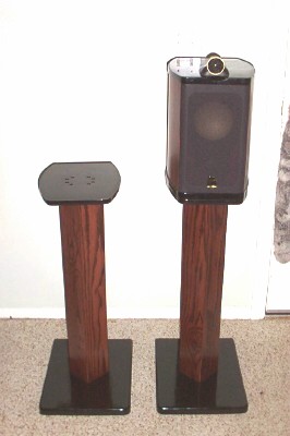

The matching "I" beam style stands were made out of ¾" MDF. I laminated (glued) 4 pieces together for the uprights and two pieces together for the top and bottoms. The top of the stand is the same size as the bottom of the speaker and has a matching beveled 45 degree edge. The Bottom piece is 1" bigger in width and depth than the top piece to add stability.

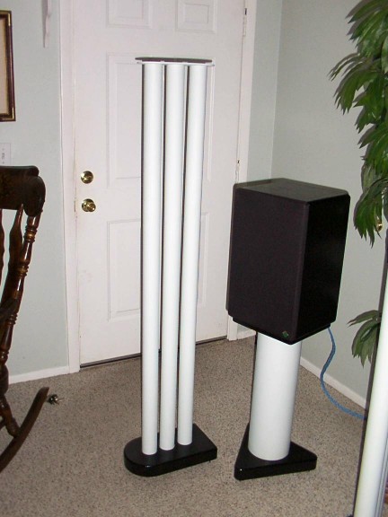

Speaker Builder had an article a few years back on stnads that were built from PVC pipe with wood base and platforms. Filled with sand for stability and your good to go for very little money.
You could go crazy like I did when I had more money than sense and use 2x4" steel, 3/8" thick filled with sand and 3/8'' base and platforms but it isn't neccessary.
