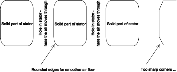

Hi Wachara,
... After asking you to make a more close-up photo of your stators I realized that it might be quicker and easier if I briefly illustrated what I would suggest - and then you probably already know if you've made the stators like this (and if it's interesting to you/possible to make).
So I've attached a very simple illustration of what would be my suggestion: To round the edges of the holes in the stator in an arc-like form (on the illustration they are cut-outs of an ellipsoid) so as to reduce potential turbulence or uneven flow/transmission through the holes when the sound plays.
From the photos you've taken I can't see if the holes are already rounded ...
Personally, I believe this would be quite audible, although I haven't tried it yet. But as you might have noticed from the other thread on ESHP (ES HeadPhones) I started I will be using round wires for the stators I'm making.
Anyway, this is my suggestion.
Greetings,
Jesper

Hi Jasper,
Thanks for sharing your thought. However, it's going to be extremely difficult for me to make stators like that. I doubt if the holes like that are going to make any difference in sound.
Thanks anyway.
Wachara C.

Hi Wachara,
You're welcome. Hmmm... I remember you once wrote that you had a CNC machine and my thought was that maybe an ellipsoid drill of some kind could make the rounding.
But anyway - your decision of course.

Hi Jesper,
Unfortunately it's not that simple. As per yours design you have to work on both sides - front and back, and that adds even more difficulty.
Wachara C.
