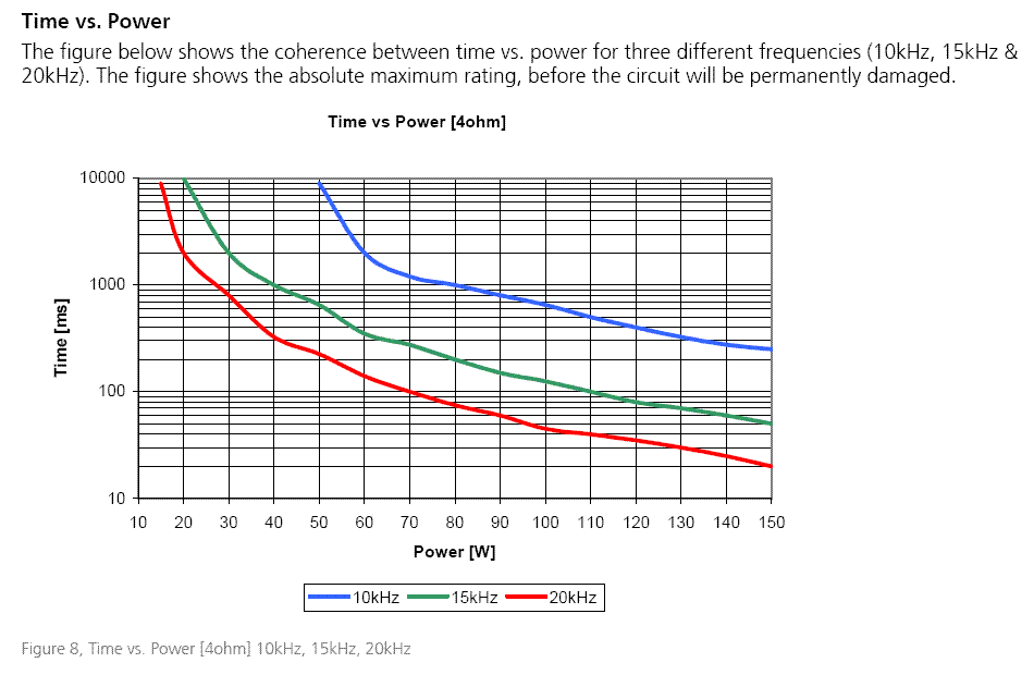

If it is a thousand watt amp, then it should obviously be expected to sustain 1000W continuously.
Everytime the thousand watt capability of these modules is referenced, everyplace I've seen, it _does_ say "continuous" beside it, but they always leave out the "for 15 seconds, after it's taken out of the freezer" aspect.
These figures seem shockingly low to me, and I was expecting something like this.
40W continuous at 50 deg. C ( a reasonable in-case temp) is a far cry from 1000W, not even close, I wonder what their 200W amp is? Can you show us that same part of the data sheet for that one as well?
It does say it can be increased with heatsinking or forced air, but I think the only way to actually get close to 1000W out of it for any length of time would be liquid nitrogen.
Who wants to use fans and big honking heat sinks just to get a reliable ~100W of power anyway, may as well go with class B right, hell, may as well go with a real supply. One has to note the figure of it's max capability with all the additional cooling isn't given either.
Such embellishment forces me to ask how far they stretched the truth on all their other specs as well.
For instance, what's with the FTC rating?? Bandwidth limited to 3Khz, by protection that..... isn't normally in the amp? So they squeeze a little more power out? Isn't FTC test supposed to be "across the rated bandwidth (so it should be up to 20Khz that's what they said it is), at the specified ratings". I guess they only specificed all the ratings up to 3Khz? Something stinks.
Now, be serious, do you really want your UCD modules rated this way? The cost of a real SMPS that can "do" the job would be insane.

Hi Chris,
datasheets are on their web page. Here is 1000ASP, here is 200ASC and here is 250ASP .
It is interesting that 250W module has almost the same continious ratings as 1000W one.
But the most shocking digram is from the 200ASC datasheet. It shows how do they dimension Zobel network. That is also the reason why 1000ASP has FTC rating only up to 3kHz. See attached picture.
Best regards,
Jaka Racman

...and it all comes crashing down. Thanks for those links Jaka, I hadn't seen those before. I'm really taken aback by those.
I'm surprised they haven't yet evolved beyond the obvious problems they have, too busy marketing it perhaps.
At great restraint that's all I'm going to say about it, but it looks as though if anyone truly wants an amp capable of 1000W RMS it's a ZAPpulse for you, for now.

I'm amused that you want to bi-amp these "1000W RMS" "load independant" modules, should get you a clean 250W for at least 20 seconds, if you open the window, for a subwoofer anyway. Now _that_ is amusing.
Further to my amusement, statements like "Seems to have limitlesss power & authority, and a load of detail too." Just read the data sheet and tell me how limitless the power really is. I know, "seems" was the key word right? So it has a bit of dynamic headroom, so what, that term went out of style right along with PMPO did it not? In reality, it can't even come close to half of what their rating claims, let alone across the audio band. So yeah, I'll write that off and never look back. I think you're going after a hugely expensive and sorely dissapointing 300W at best.

The reason I'll personally turn my back on them is because, according to their own data sheets, they perform far from advertised.
Really, so you have an integrated power supply, let's say with a huge heatsink, that's fan cooled, you can actually squeeze 1000W continuous out of it. You just negated all its benefits(small size, lightweight, efficiency) what's the point?
Their problems with the zobel network... I think, seriously require some attention? Surely Karsten Madsen is capable of addressing these issues, or comming up with an equally good sounding design that doesn't require one, he certainly is no fool.
In the past he's done extensive research, I'd hate to think it ends at this, but I don't see the new versions being improved upon. Why? Maybe because people are buying it as it is, that's just my theory.

I have just seen the graphs from B&O showing the max. power vs. time at high (10,15,20KHz). I assume that's due to power dissipation in the Zobel network resistor, isn't it?
Someone pointed to the way they design the zobel network, please, could you tell me where to see that info?

I operated a sample 1000ASP on the bench delivering 350W average of pink noise into a 4 ohm load for over one hour with no additional heatsink and the metal case stayed below 55°C.
However, higher levels would make the power supply voltage go down to act as a thermal compensation. Much nicer than just shutting down.
However, with 1214W of sine wave, partly into clipping, after about 35 seconds, the output level would drop to about 600W by the protection circuitry. Remember this is with no additional heatsink.
The 200ASC, I was able to operate with sine wave at 100W into 4 ohms continuously. Turning it up, with sine wave, the module would shut down at about 214W.
However, with pink noise at 100Waverage and a 6 db crest factor, the 200ASC would run all day without shut down, until I was tired of tying up one of my Audio Precisions with it. It would also run all day with music, driven hard where the output limiter was set to a peak limit of 210W maximum. That is, the limiter would allow small amounts of clipping. Driven so the limit light in our external optical limiter was on essentially continuously.
