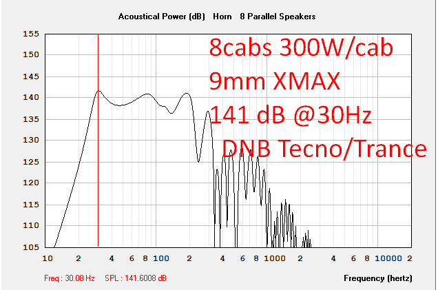

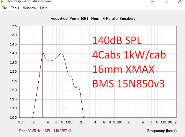

Has anybody built a FSP 18 SXY?
with 4 of this 15" BMS's you reach the same as 8 18TBX100
but they cost 578 euros

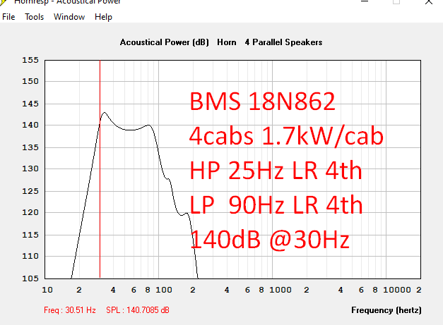

the BMS 18N862 have more xmax
the motor is not super strong as a 18DS115 but
the stadium horn do not have a high compression ratio it was designed for the 3015LF who do not have a super strong motor and cone
so the BMS looks like a nice fit for the stadium horn
with 4 cabs at 1.7kW each
you can reach 140dB @30Hz
just take in account that by looses and stuff you can loose around 2dB
so lets say 138dB
but you pay the price for a high XMAX driver

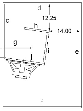

Also the FSP cabinet doesn't look like it has enough spacing between the driver and the baffle, I would add an 18 mm ring between the driver and the baffle.
