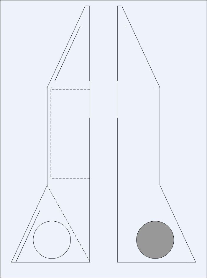

Mind you, given the size of my room I have been following the Fonkenwoof developments and wondering how the 127s might fare in a Brynn or Gabriel with doubled CSS7s integrated into the box; but that's as much intellectual curiousity as anything. Something like the drawing, perhaps...
Regards.
Aengus

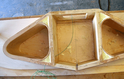

I really like the cutouts!
What there isn't can't vibrate.
Definitely agree. The story with my particular build is a bit more complicated, though: the curves at the inner two vertices of the cutouts are there for aesthetic reasons, and required creating smaller voids that I filled with expanding foam (see photo). Seems to have worked - I can't detect any vibration even at high levels.
And speaking of high levels, I meant to say in the previous post that these will play louder than I like to listen with no apparent strain; but some of you may like to listen louder than I do (I'm an old fart).
Regards.
Aengus
