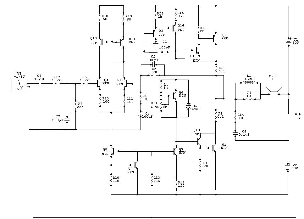

I'm still talking about voltage across R18, R19 and R22 (the voltage is almost the same)
You can use any resistor value you want, but I've pointed out some starting values. A my experience goes 1V is the minimum I recomend. When I used less amp began to sound harsh. You just have to choose some compromise between VAS stage linearity, current requirements and max. output voltage swing. If you choose lower voltage, you will get voltage swing nearly rail to rail, but the linearity is poor.
So, what do you want? Poor sound and power or good sound and less power?
One thing, that was evident on the first schemnatic - there was biasing problem between differential and VAS stage. Input stage had to do a lot of work to keep DC low and then it didn't have enough power to work with input signal.

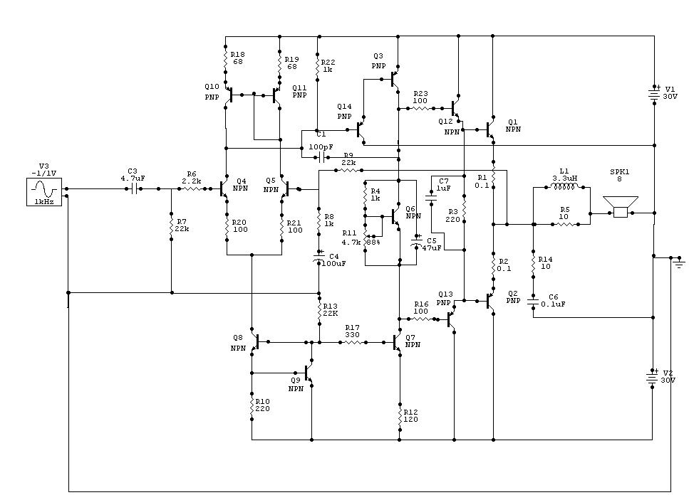

Schematic 2 complemetary pair
This is the second schematic aand it has a complementary pair in the output stage. I know already the emitter follower has lower TIM than the complimentary pair but to come back to my problem with harsh sound which seems to be linked with the LTP and the VAS which of the two will be better? Thanks

ilimzn said:R17 needs to be connected to emitter of Q4, not base...
I'm sure you meant Q14.
Cheers!
connecting R17 to Q14 emiiter makes the Q14 draw more quiscient current,(depending on the value of R17) so i believe this will help alleviate the harsh sound you described. likewise, the junction between bases of Q7 and Q8 must have a bias resistor.
zeus_threat,
you connected R17 wrong, it shouldn't be between those 2 transistors, you should connect R17 from Q14 emitter to positive rail voltage.
Cheers Michael
Cheers Michael

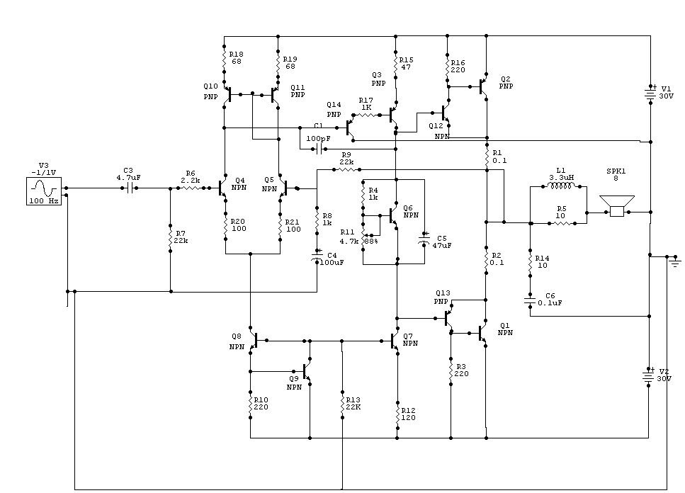

Last mods
Ok for the resistor on q14 so the previous schematic was right. But instead of using a buffer for the VAS as i did, which would give better load handling
(1) a cascode with q3 collector
or
(2) a 6ma constant current source with q3's emitter?
or

zeus_threat said:Ok for the resistor on q14 so the previous schematic was right.
No, re-read my post again... 🙁
Cheers michael
Correct schem
I think this is what you meant micheal, am i right? Plus the amp gets hot with no signal but when loaded with a source it cools down. There is a small buzz coming from the speaker for the first schematic i posted. In case its parasitic oscillation will C7 and C2 solve this problem? (Sorry but no scope under my reach for analysis)

zeus_threat said:Hi, am a DIY but not an expert in amplifier design, I've built this amp but the highs are sounding harsh and bass is not sufficiently present. I have measured the output impedance to be 0.437 R, but stilll don't have anyy clue on how to smooth the high frequencies. Any help would be welcome. Thanks
Try removing C2. The first time I built a Leach amp it also sounded harsh. The culprit turned out to be the low-pass filter cap. It was a ceramic cap that sounded terrible.
(I haven't read the full thread, so I apologize if this post is redundant.)
C7, input filter: It is actually rather difficult to get a 220p ceramic cap that would not be near-ideal. Ceramics re VERY well behaved for these capacitances. I would suspect the input stage is reflecting a negative impedance to the input, this is not a trivial thing to solve (although a series resistance between the input filter and the base of the input Q often does it, but there are other repercussions). You already have a resostor there. You may want to try shorting C7 and checking if the 'buzzing' dissapears.
C2 and C1 are 'interactive' - it is not just enough to increase them or decrease them. For starters, I would try removing C2 (across the feedback resistor), or, placing a small value resistor (1-2.2k) in series with it. You may have the same negative input impedance problem for both sides of t he LTP.
Finally, CFPs can sometimes oscillate within their respective feedback loops, and rather nasty at that (like in the MHz region), compensation of the rest of the amp will not helpo this at all, and in fact, may make things worse in some cases.
To be perfectly honest, this may be impossible to debug 'long distance' - a few oscilograms would really help, also a view of the layout - one ground connected at the wrong point may make it oscilate and we'd be running in circles here tryng to figure out why.
