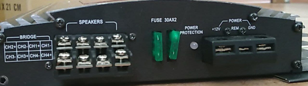

Does anyone have the schematics for this 4 channel amp? I can't find anything on the internet. It is identical to another model (king sound eca-504). It was going in protection mode, I repaired a broken solder connection and a blown transistor and seems to work now. However, when connecting the sub in bridged mode (channels 3 and 4, since 1 and 2 have the LPF broken) it's almost inaudible (the other stock speakers cover its sound). This is strange, because if I unplug one channel from the inputs it starts to be louder.
I tested the output channels individually at home with an oscilloscope (but with no load as I don't have any) and I get the same input wave (amplified) in all of them. I also checked the rails where I can see +/- 20V steadily.
What else could I check?

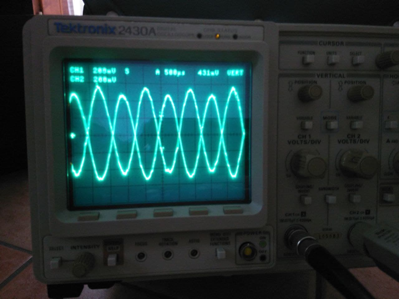

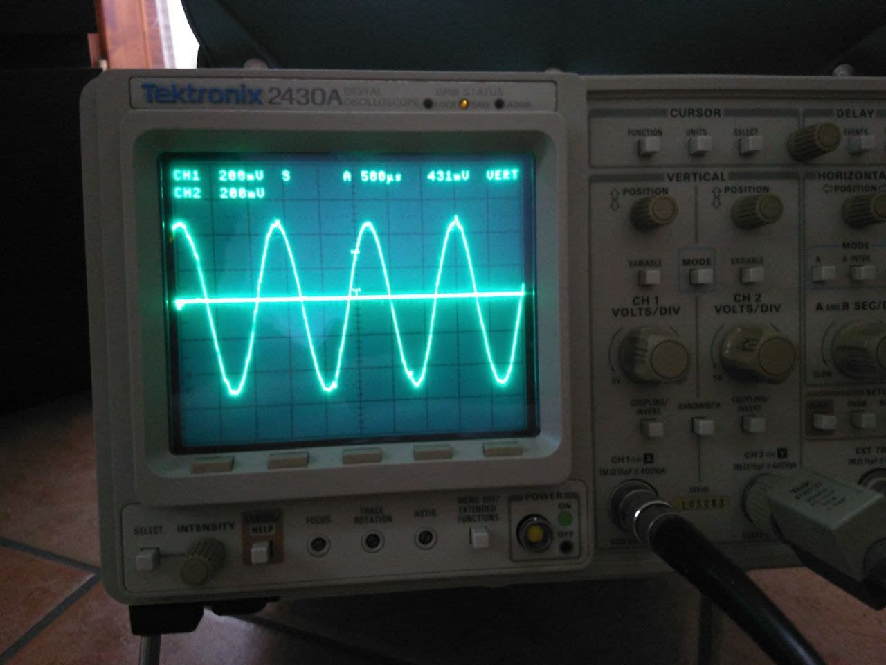

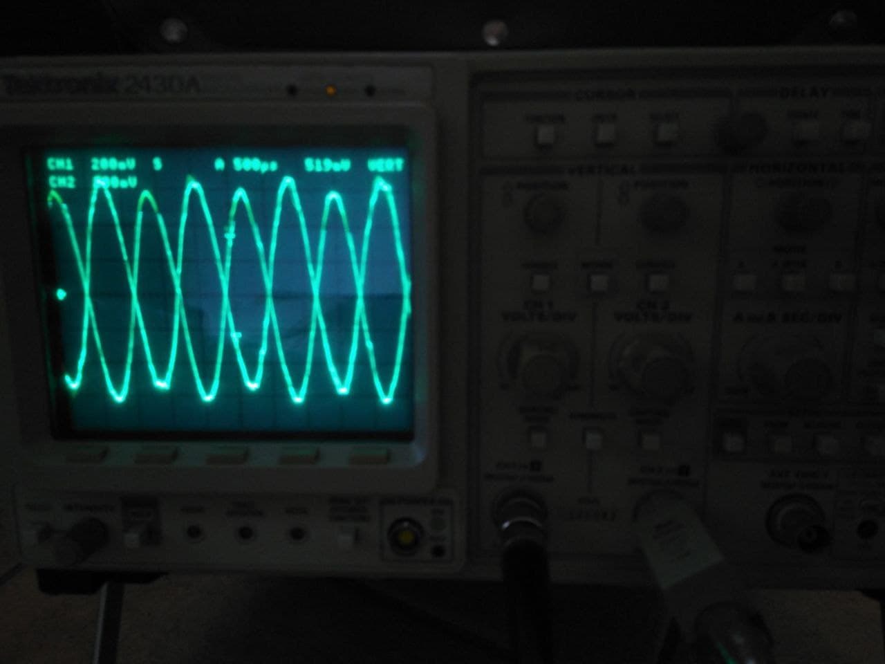

when testing in the car, the problem was there for both pairs. Now I tried on the oscilloscope to see if the signal is being inverted, and it looks like it is. The first picture is channel 3 only; the second channel 3 and 4, and the last one channel 1 and 2. I don't know if I'm missing something.
At home, I'm using an android smartphone with a signal generator app. In the car, the signal comes from the stock headunit, passing through a cheap no-brand loc.
