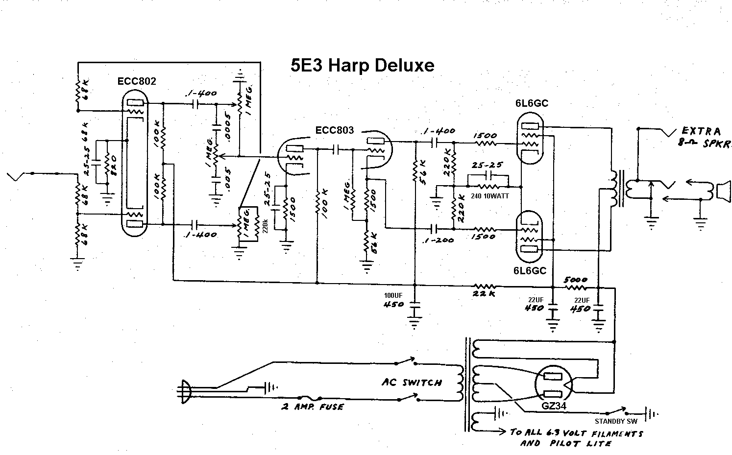

K should hav said hav moded the amp so that chanel one loops bak thru chanenl 2 so i can turn down chanel 1 and turn 2 up, this did help a lot. but and please correct me if i'm wrong here the volume pots are after the valve so the feedbaks alrdy in there.I also use an old sure vocalmaster (400 watts peak output) which has notch filters,with this feed bak is way less ,but its too dmn big to lug to jam sesions.
But what a want to know is whats in an acustic amp (eg marshal soloist100) that makes them not feedbak.

I explained above, it's how much gain is at the first tube.
The more you raise it, the more feedback and distortion you get.
Acoustic amps are tame in the preamp section. Also they usually have less gain sections, whereas a "Metal" amp has more stages cascaded together.
Yes the volume or gain pot's are after valves, but the feedback is being created in the first valve, IT"S THE ONLY ONE THAT CAN "HEAR" YOUR MICROPHONE. Turn it down then.
Compensate for volume loss with the post or "Master"volume control.

thank you for your replys guys, But i'm allrdy doin this even moded the amp so i could (orig 5E3 has only 1 volume pot per channel and no master). its just not enough, what i was thinking was that a guitar uses frequincies not used by the harp both in the uper register in a lead guitar and lower in a bass if there better way to block these than just a capp band filter.....

seems the only real way to turn that valve down on the 5e3 is substatution put in a baldwin valve sold to me as a12au7 (not sure that it is not marked on the valve) has way lower gain seems to hav tamed the best sum wot, as my ears are almost bleeding just now lol, thanks for the help Globug
Tube it down!
Why is no one talking about tubes?
The first place to go in taming harmonica feedback in a guitar-centric amp is to tube down a bit. A harp mic signal is far hotter than a guitar pickup's. Most guitar amps are running 12ax7's at the input stage, specifically in order to produce a hotter signal for feedback/sustain. Start by replacing the 12ax7 in the 1st stage with a 12ay7 or 12at7.
yip mind WAS 12ax7 but not no more, see below. almost more mods than original components now
