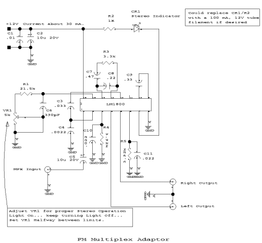

The H/K TA224 needs help in order to play MPX FM stereo. DIYer extraordinaire S. Bench has provided the 'phile community with a comparatively easy to implement MPX decoder.

Eli D.,
I have a NOS Archer LM1800 on the way!
I've been researching the 7408, just by chance, I read a thread last night where old Soviet 6P6S tubes seem to have a lot people’s attention, I’m not sure if they would be a direct swap for the 7408, but it looks promising.
I have several UF5408’s here!
Thank you for your advice, it will save me several hours!

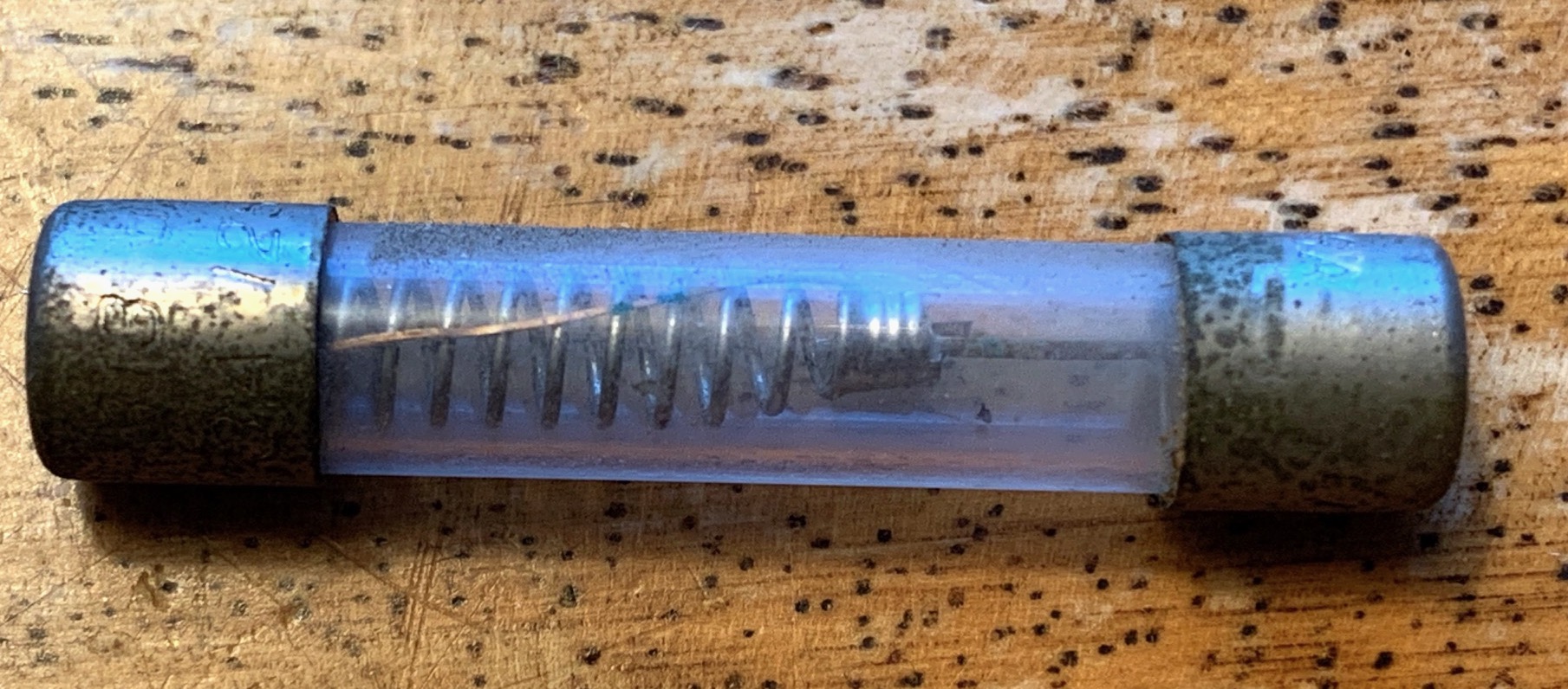

Thank you for the good advice, I'm going to do precisely what you advise. Looking at the capacitors, they at least look good, no swelling or spillage. I'm going to see if they will reform, the amp actually doesn't seem to have many hours on it, I believe it still has the original fuse. Sorry to hear about the Knight amp.
